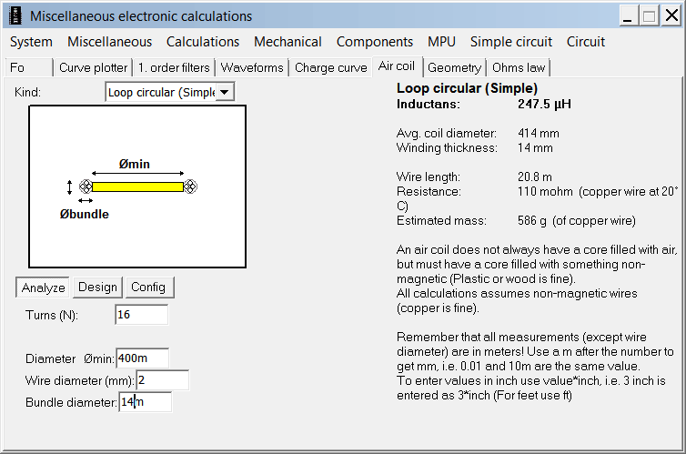

          http://www.miscel.dk/MiscEl/miscel.html This is a very useful calculator for detector design.
          On the picture you see the calculations for a 40cm diameter TX coil.
          You see the wire thickness
          The wire length in meters
          The weight of the wire
          The resistance of the wire.
          The inductance of the coil with 16 turns
          With this you can find all the parameters for any size coil.
          When you change the wire bundle thickness, you see that the inductance changes. This tells you that the thickness of the wire insulation plays a role as well as the tightness of the winding or how tight you bind the bundle.
          Note that the initial coil diameter is the internal diameter. The average diameter is the internal diameter plus the bundle thickness.
          The final coil will be even thicker as you need to ad a spacer and shielding.
          Enjoy

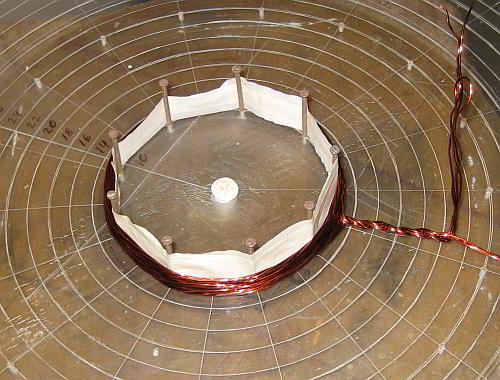

                I only have #20 AWG available, so I twisted 4 wires together for the TX.
                Why 4? we have about 1A average current running in the coil. We do not want the coil to get hot.
                Inner diameter is 24cm. At 26 turns this should be about 350uH. Resistance should now be about 250mOhm for the TX and BU in series. The coil Flyback is resonant. Therefore, the Ohmic losses are to be avoided.
                The BU coil is wound counter clockwise, 7 turns
                The TX is wound clockwise 26 turns.
                Picture #1 BU coil, 10cm inner diameter, 7 turns

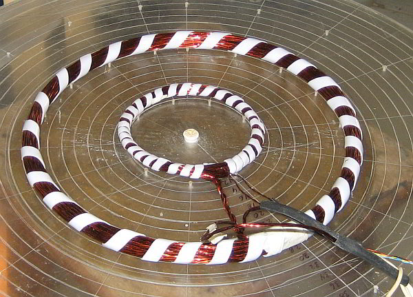

                #2 BU and TX wound, TX is 24cm inner diameter, 26 turns
                #3 TX coil bundled
                As you can see, all this is not very precise. The diameter of the bundle will be different with different wires.
                With different bundle diameters, the inductance will be different too.

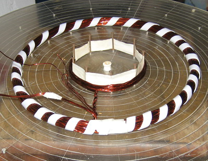

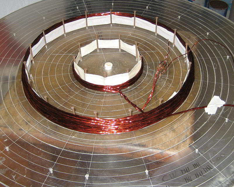

                        Below is the 26cm outer diameter TINKERERS IB coil windings. This is an experimental coil. The TX-BU-RX proportions are a bit different for experimenting.
                        The TX coil was wound on a 24cm diameter nail bed. I used 4 #20 AWG magnet wires in parallel, slightly twisted.
                        This should be OK for 1.5 to 3A average coil current.
                        26 turns for about 360uH inductance.
                        The Bucking coil, BU, is wound on a 10cm diameter nail bed, 7 turns.
                        The mutual inductance is about 17%. The ideal mutual inductance is supposed to be about 33%. So, why so small?
                        The RX coil is wound the same diameter than the BU coil, right on top of the BU coil.
                        10cm inner diameter seems small for a RX coil.
                        The reasoning (please correct me if I am wrong) is as follows:
                        A low coupling factor means that only few turns are needed for the BU coil to null the flyback current. This means that the TX field is stronger.
                        It also means a lower amplitude residual (air) signal. This residual signal is a limiting factor with the gain of the pre-amp.
                        What about the RX? So small? Will it pick up the target response?
                        Experimenting with IB coils, I find that the sensitivity is of the total assembly, not just of the RX coil. I even once tried a 10cm diameter RX coil with a 150cm TX rectangular coil and it still worked.
