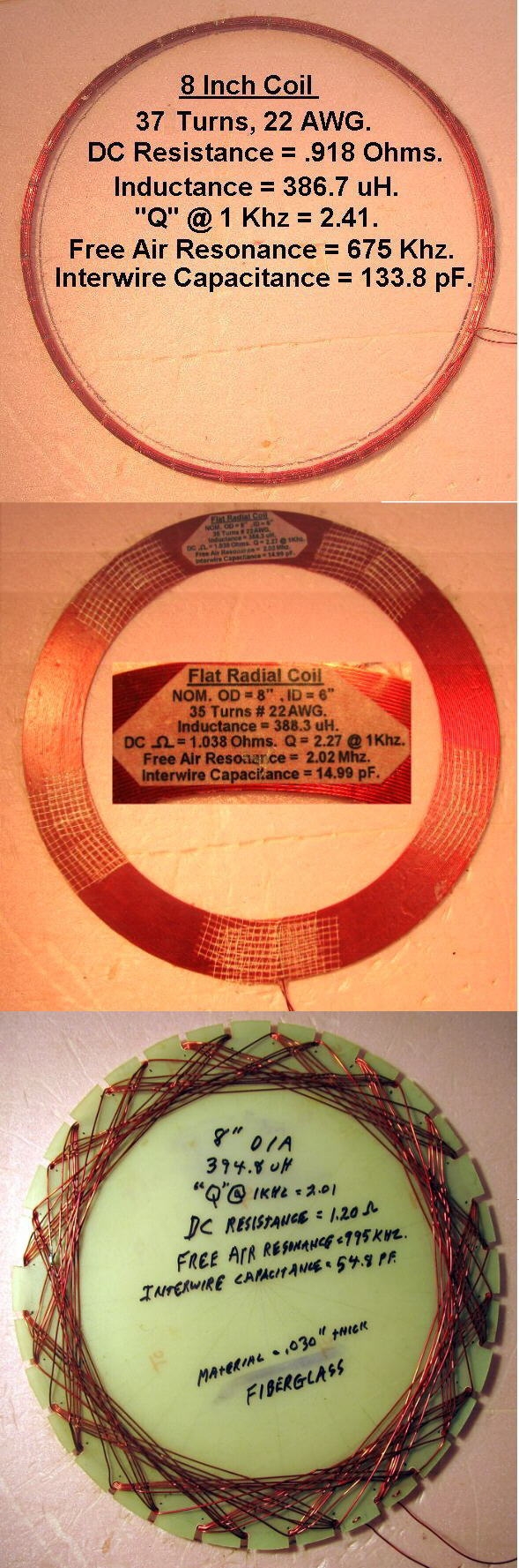

    • #62
      These are just 3 Round Coils, all wound to Simular Diameters and Inductance Values.
      Check out the Free Air Resonance and InterWire Capacitance of each one.
      • #63

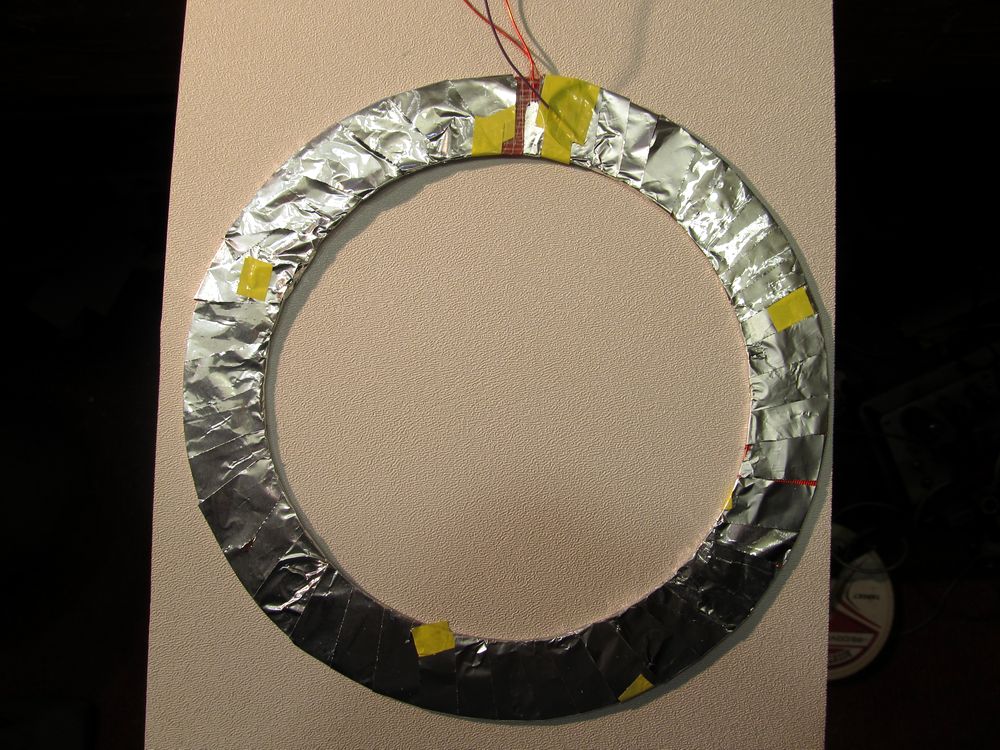

        How do you shield the flat radial coil and what is the shielded resonance? I've been winding spiderweb coils that I think should be similar to the flat radial. Didn't come up with a jig to wind a flat radial.
        • #64
          I have jigs and have made hundreds of these coil, but I don't Shield them.
          Never had a reason to.
          But I imagine you could, the same way as a bundled coil.
          Maybe I'll do one and test it for you.
          EDITED
          This is that Same 388.3 uh Radial Coil with an Aluminum Foil Shield on it.
          As a Quick Test, it Seems to work OK on my detector.
          Free air Resonance is now Just 410 Khz.
          Capacitance is now 392 pF.
          WOW!
          I have some MG Chemical, Spray Nickel Coating, But I am Reluctant to do a coil with it.
          Can't be Easily Removed, if I don't like it.

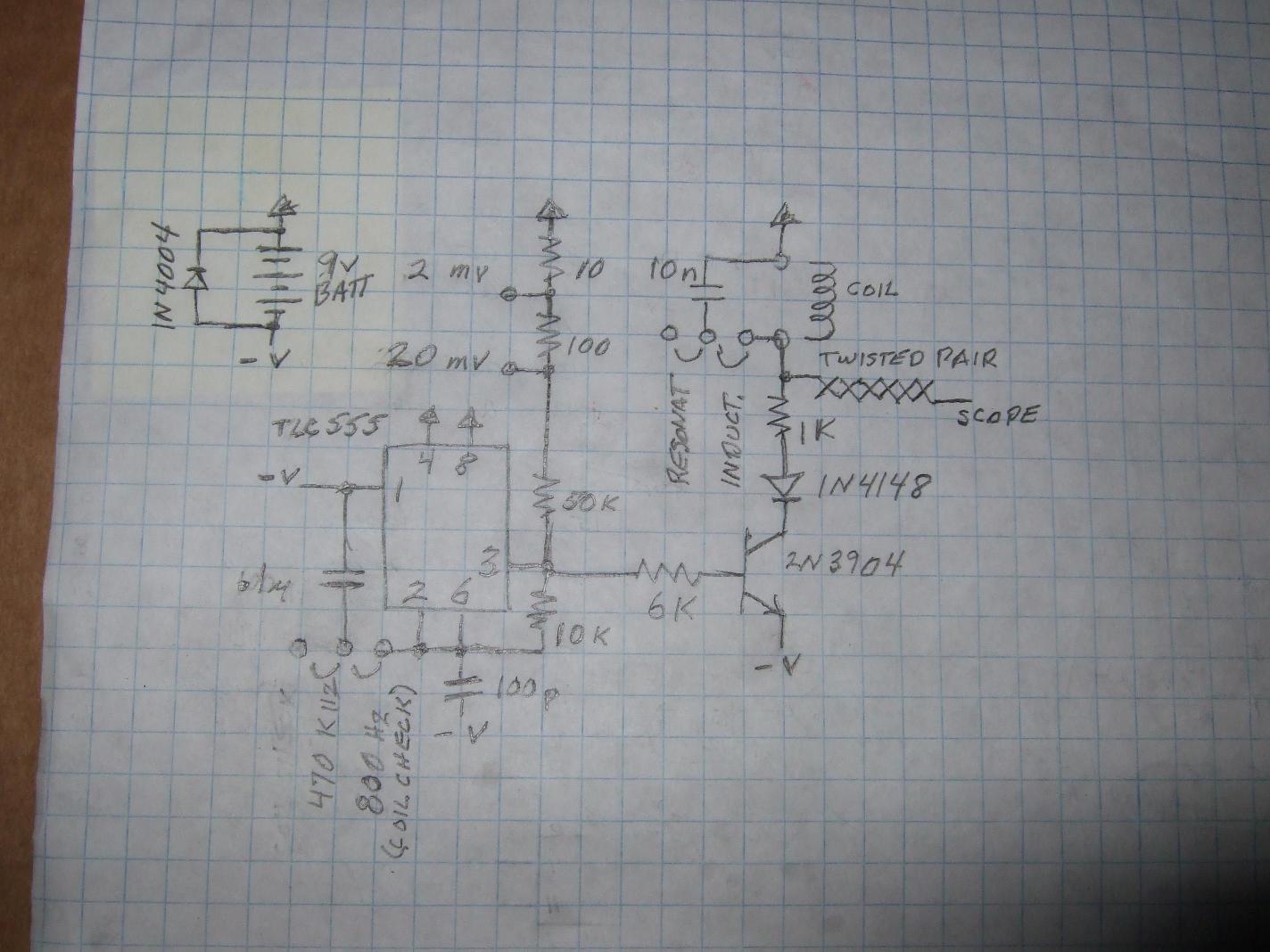

                  I have Never used a Mosfet with a series diode.
                  This is my Test Circuit for Measuring the Free Air Resonance.
                  And the Coil must be Suspended in FREE AIR, Not just laying on the bench.
                  • #69
                    Don't have a signal generator. This is what I use. Measure the resonance with the scope. Coil inductance = 2.533 million/resonance squared with the 10nf cap. jumper across the test coil. Free air resonance is without the 10nf cap. The coil resonance is close with a Mosfet and MUR460 diode in series. Think the answer should be close to the same as the signal generator.

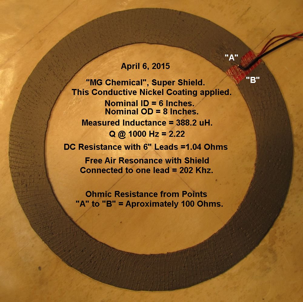

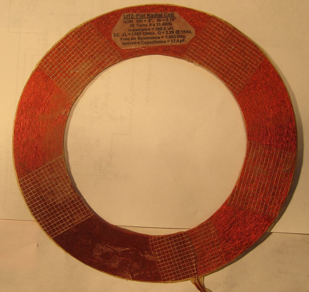

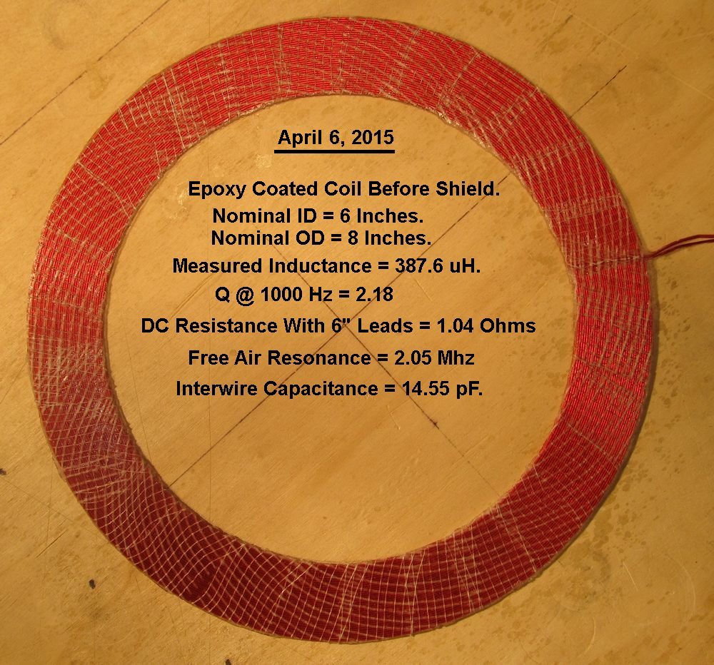

                            Previously I Wound a Radial Coil with Tuflon coated wire, But to get the Same Inductance Using Tuflon wire, Requires a LOT more Turns.
                            That Coil was also quite HEAVY.
                            I Also wound a Radial coil with Litz Wire, Turned out OK, But Not much difference in Measurements or Performance to the Enamel wire ones I make.
                            Just for Curiousity, Today I wound another Radial Coil, See Pictures and the comparative Measurements.
                            Than Coated it with a Conductive Nickel Spay.
                            I Not Impressed!
                            The Shielding would probably be OK if it were in a Coil housing and the Shield was NOT Directly on the Coil.
                            But Some Distance Away, Sprayed on the Coil housing.

                              So you dont usually use any shielding at all and have no issues with rf noise?
                              • #75
                                No I Don't have any noise Problems, Or None that I am aware of.
                                I Threw out the Tuflon Coil that I made, But here is a picture of the Litz Wire Coil that made and I still have, just keeping it for reference.
