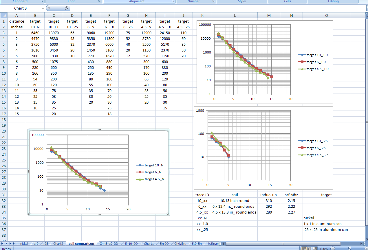

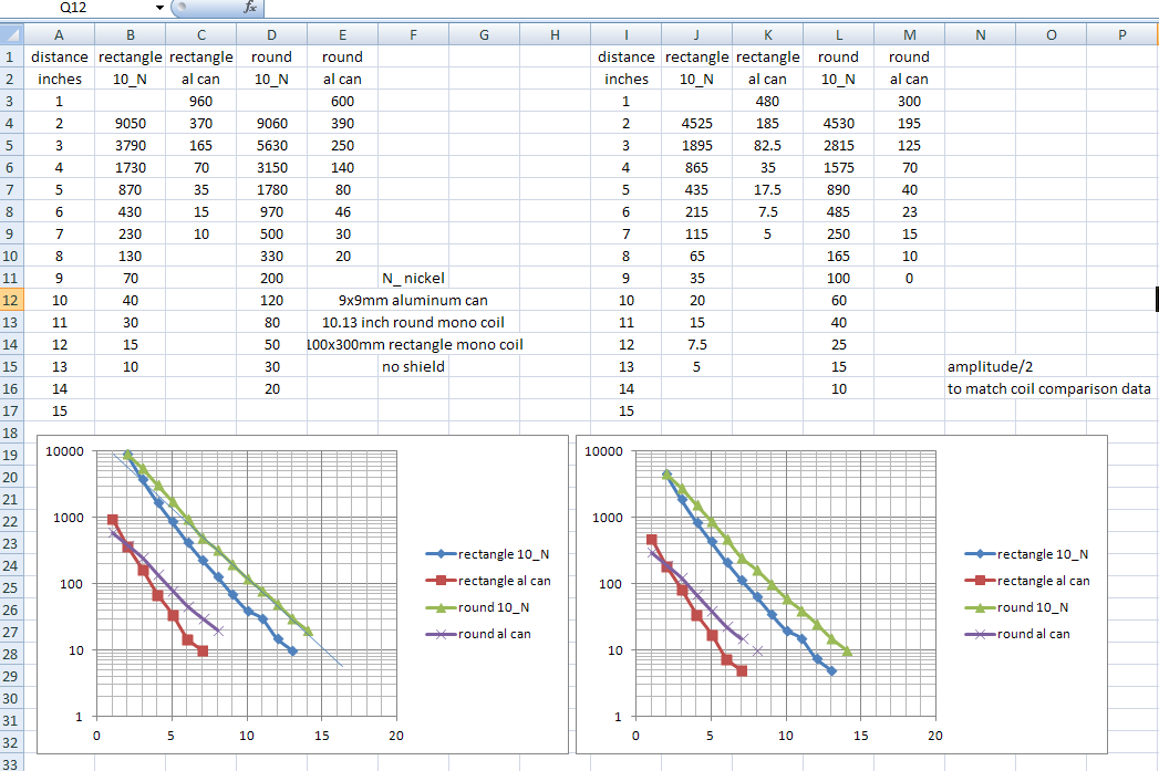

      I recorded some data. Made a single layer coil 10.3 inch diameter. 21 turns awg 28 enamel coated wire. Made it so I could slide the coil off the round to put it on the other coil forms. Same coil for all tests. Plotted change in amplitude out of integrator vs target distance from coil. Coil not shielded. Circuit not stable as it needs to be to plot the lower amplitudes. Will do again and add the rectangle if I solve the drift problem. Probably not stable enough to define .25 x .25 in aluminum can. Wondering if I should have done the test different.
      Recorded the rectangle (coil comparison_3). Corners fairly square. Recorded nickel and 9x9mm square aluminum coke can mentioned in another thread as a good target for small gold. Used a 12 volt supply, so had to divide by two to match original data (coil comparison_2). The square corners looked different than the half round ends used in _2.
            Sorry I did not get back to you on this sooner been out of pocket for a few weeks. From the attachments it looks to me like the 4.5 round end coil (280 uh) is a bit more sensitive than the 10" round coil (310uh).
            If I am interpreting your charts correctly the rectangle coil is worse than the 10" round coil and the 4.5 x 13.5 round end coil. Do you agree or am I completly misreading your charts?
            Good work!
            Dan
            Just noticed that in test 2 (round end coil)you used a 1/4 x 1/4 (.0625 sq in) Al target, and in test 3 (rectangle ends)the target is a 9 X 9 mm (.1255 sq in) Al target. Was this difference accounted for in the results?
            After rereading your charts it appears that your method is to use the 10" round coil normalized to a strength of 10 units (10uv?) set by target distance for a given target. Then other coils are tested with same target at that distance and the signal strength is recorded, correct? If so then the reference between charts 2 & 3 is the 10" coil, correct? Then from that the highest signal strength for a given target defines the best coil, correct? Whew! Please let me know.
            Dan

              [From the attachments it looks to me like the 4.5 round end coil (280 uh) is a bit more sensitive than the 10" round coil (310uh).]
              At short distance it looks to be true.
              [If I am interpreting your charts correctly the rectangle coil is worse than the 10" round coil and the 4.5 x 13.5 round end coil. Do you agree or am I completly misreading your charts?]
              I agree. Something I didn't do was plot signal strength away from center. The rectangle coil looked good as I moved the target towards the end. Probably needs to be done for the rectangle,round and 4.5 x 13.5 round end.
              [Just noticed that in test 2 (round end coil)you used a 1/4 x 1/4 (.0625 sq in) Al target, and in test 3 (rectangle ends)the target is a 9 X 9 mm (.1255 sq in) Al target. Was this difference accounted for in the results?]
              The comparison in test 2 should be valid, same for test 3. The rectangle coil and the 4.5 x 13.5 round ends are both better than the round coil at 1 inch with the aluminum can target. It looked like I used 12 volt supply for test 3 and 6 volt supply for test 2, so I divided the results for test 3 by 2 to get values to compare with test 2.
              [After rereading your charts it appears that your method is to use the 10" round coil normalized to a strength of 10 units (10uv?) set by target distance for a given target. Then other coils are tested with same target at that distance and the signal strength is recorded, correct? If so then the reference between charts 2 & 3 is the 10" coil, correct? Then from that the highest signal strength for a given target defines the best coil, correct? Whew! Please let me know.]
              Plot is voltmeter reading vs distance for each target. Lowest digit = 100 uvolts, 9500 = .9500 volts. I need to put more information on the charts explaining how they were done.
              Interested in your rectangle coil with rounds ends.

                    After studying your plots again it looks like the round ended 3:1 coil does have a bit of an edge over the others for what I want to do. I actually built another round end 3:1 coil that is 3.5" X 11" that I did not post and it performs quite well on the small stuff. It detects the gold flakes at about 2" in air but then I started tweaking the filters in the preamp and went too low @ 425kHZ. Ran a MATLAB sim yesterday and didn't like the signal delay added by the 425kHz filter stages. Also the A/D offset level needed to be reset with the changes so now I have to backtrack a bit to get to best operating conditions with the CHANCE PI. A/D offset level is critical to getting discrimination to work properly. Also coil damping always needs to be optimized. It is challenging when there are so many variables in play.
