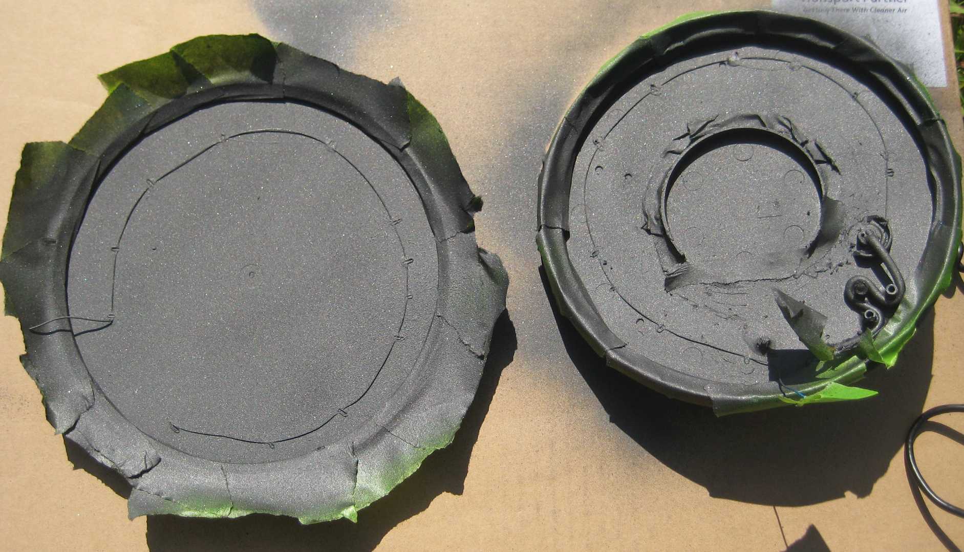

    I'm modding an old Radio Shack MD to work with a SMT TGSL board I recently got and
    used the Tractor Supply Graphite Paint for shielding. One side reads 5K per inch and the
    other 3.5k. Is this OK or should I add more paint?

    I found these quotes in the forums;
    If you are shielding for a PI detector I would keep the resistance per running inch of
    surface to about 2000 ohms. I did one coil at 1300 to 1500 / inch and noticed some
    loss of sensitivity at that resistance. PI detectors mostly need shielding if you can
    detect your hand on the coil at the shortest delay you expect to detect at, typically for
    small gold in earth.
    Try to keep the shielding to 1K or lower.
    Graphite is much more resistive and hence it's tau is below 1us.
    Because shield is fighting electric fields, and there you have high impedance's, the
    shield conductivity is irrelevant, hence graphite is a better shield.
    I have a disassembled Minelab Goldsearch double D VLF coil that I am rebuilding for the Minipulse kit that I am building. It has a paper shield top and bottom. The graphite coating appears to be very thin and evenly sprayed. Measurements taken 1" apart anywhere on the surfaces are 1200 to 1400 ohms. The measurements at 2" apart run about the same. Measurements at 6" apart run 1400 to 1600 ohms. Measured at less than 1" they vary considerably.
    I hope this is useful.
    Chet
      My Deep Search coil had 10K on one side and 5K on the other so I'm guessing 5K or less will work!
      The Minelabs are know to be a bit critical with their shielding Tesoro's not so much..
        Some more graphite shield measurements. I just opened a COILTEK 10" x 5" mono coil to repair it for a friend. It has paper shield on top, bottom and around the outer edge with a heavy uniform coating of graphite paint. Measurements at 1" separation averages 95 ohms. Measurements at 2" separation averages 100 ohms. At 6" separation the average is 160 ohms. These readings seem very low but do not seem to affect its sensitivity. He uses it for nugget hunting only and has found many 5-10 gram nuggets.
          Is it correct that the detector used with the 5 X 10 monocoil is not a PI machine?
          Dan
            Dan
            Hi Dan
            The 5 x 10 coil is used on a Minelab GPX 5000. The 8" GoldSearch Double D coil is from some kind of VLF machine.
              Impressive that Minelab works with that low of shield resistance. Perhaps it has something to do with the shielding only covering three sides of the coil i.e. top, bottom, and outer edge instead of totally covering the windings except for the mandatory loop gap. My experience is that the shielding should be about 2000 ohms/inch for my PI. Actually the first quote in Silver Dollars first post in this thread is from me.
              Dan
                There is approximately 1/8 of foam between the coil and the paper shield which may help.
                  I usually use about 1/4" of spacing coil to shield and that helps with keeping capacitance lower.
                  Dan
