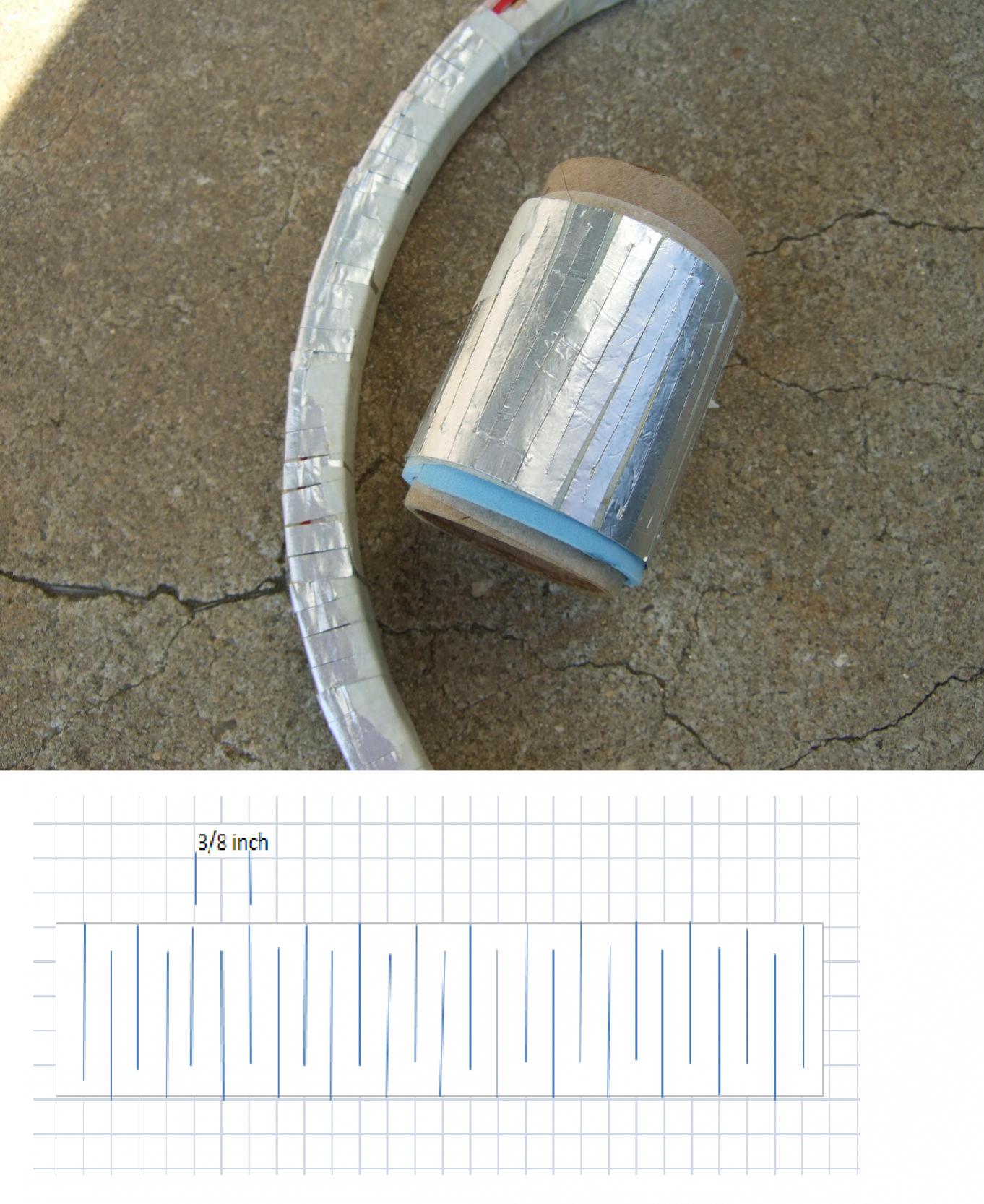

        NO LOSS ?, Did you do a complete wrap around the coil or was it insulated so foil did not touch on over lap ?

            I cut a piece of aluminum foil long enough to go around the coil. Tape 2 inch wide masking tape to the foil. Cut the tape foil wide enough to wrap around coil, cut pattern and glue to coil spacer. The foil wraps all the way around the larger coil with a small space near the ends. The foil on the smaller coil doesn't wrap all the way around but does help for measurements on the bench. Wasn't sure how to do a DD coil, so I was glad to see the EZ slide post by Silver Dollar, something I could get locally to try. I could paint the housing and not have to space each coil before adding the foil. I had read in some posts about attenuation with out stating a percent loss with aluminum foil and graphite paint, so I thought I would try to measure it. It's not instructions on how to do it. It's just how I did it with the materials I have. Spiral wrap would probably be better than craft foam, etc. Any other suggestions appreciated.

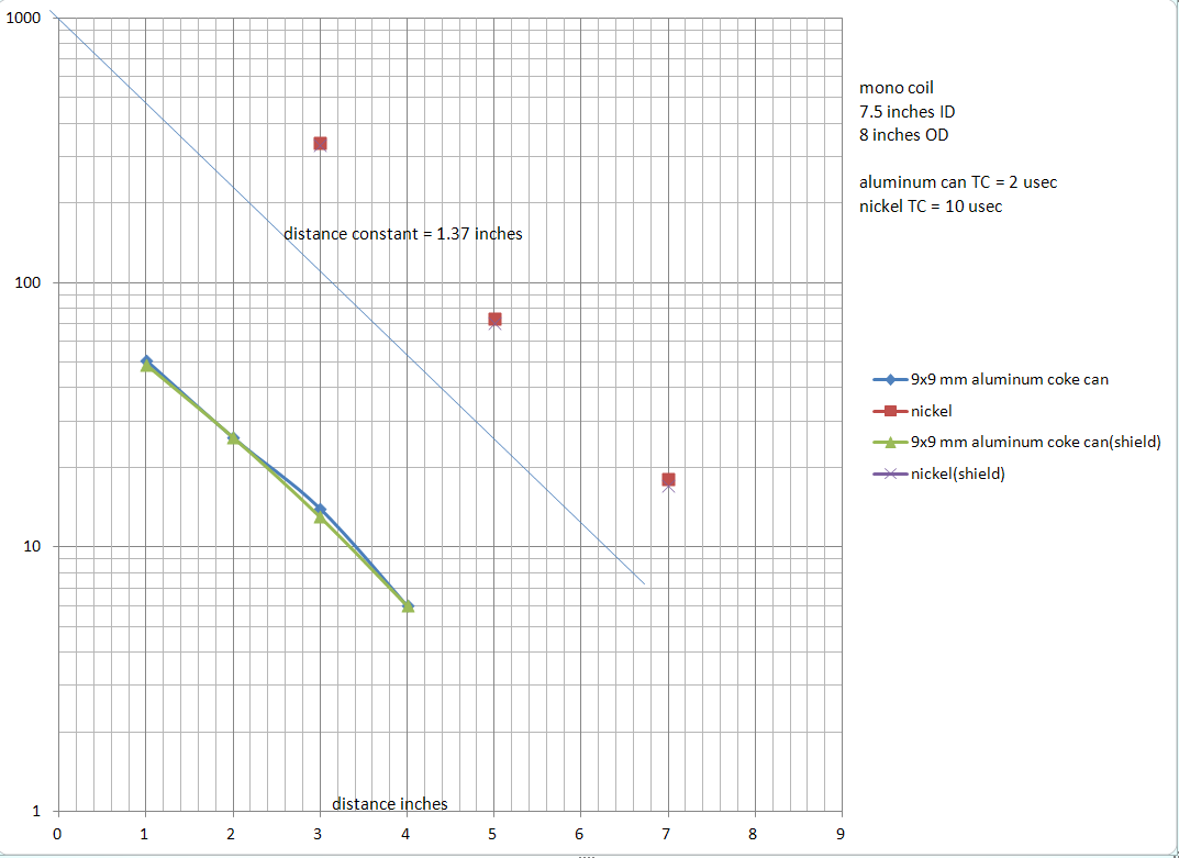

                Another test. Removed the graphite paint and layer of masking tape. Spiral wrapped a second layer of 2 mm craft foam for 4 mm spacer. Added ground wire and recorded data. Added graphite paint. Circuit resonance: no paint 1.67 Mhz, single layer foam with paint 1.27 Mhz, 2 layers of foam with paint 1.24 Mhz. Thought resonance would be higher with 2 layers of foam. Spiral wrapped the ground wire about three times(same piece of wire used for single foam test) for the two layer foam instead around the outer diameter for the single layer foam. Maybe that or the lower resistance readings is the reason. Most resistance readings from ground wire to painted surface between 200 and 400 ohms. Recorded data. The chart shows a small decrease in signal, real or measurement error I don't know. I added a line that I call distance constant(the distance increase to cause a 63 percent decrease in signal. I mentioned distance constant in a thread awhile back but didn't get any response, so I'll try again. If time constant is the time increase to cause a 63 percent decrease in signal and distance constant is the distance increase to cause a 63 percent decrease in signal then time constant and distance constant are the same. A one time constant increase in sample delay causes a one distance constant loss of signal. For the 9x9 mm aluminum can with a TC of 2 usec a 2 usec increase in delay would cause a 1.37 inch decrease in distance for the test coil. Aziz plotted some curves in thread(the relationship between coil diameter and detect distance in PI detectors, reply#54). Using the data at radius and diameter the distance constant for a 10 inch diameter coil is 1.7 inches, a 20 inch diameter coil is 3.3 inches.

                    Good work Green, very interesting results! Is there a way you can try this coil in the field to see how it behaves in both detection and noise immunity? It appears that the low shield resistance has no effect on sensitivity so it should do well.
