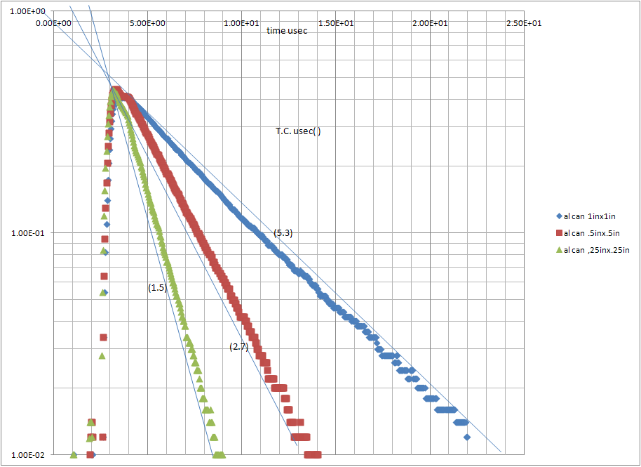

          For reference, the time constant for target cut from an aluminum coke can, .25 x .25 inch 1.5 usec, 9 x 9 mm 2 usec, .5 x .5 inch 2.7 usec, 1 x 1 inch 5.3 usec.

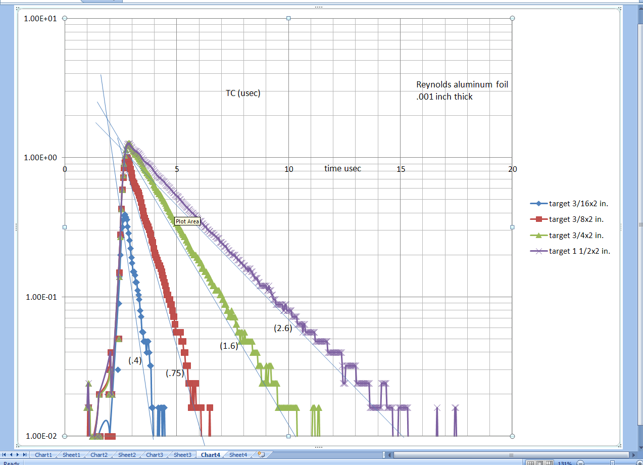

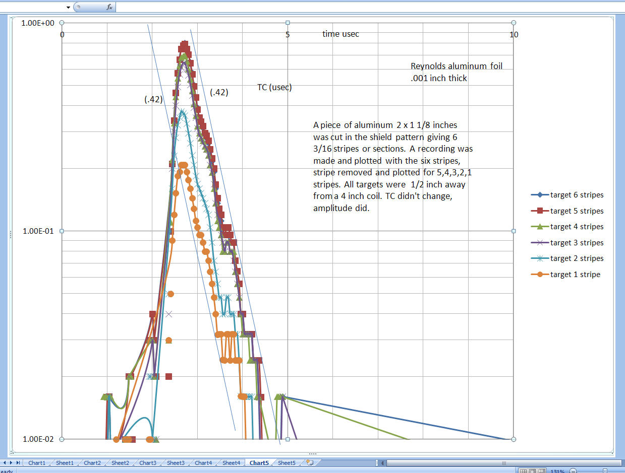

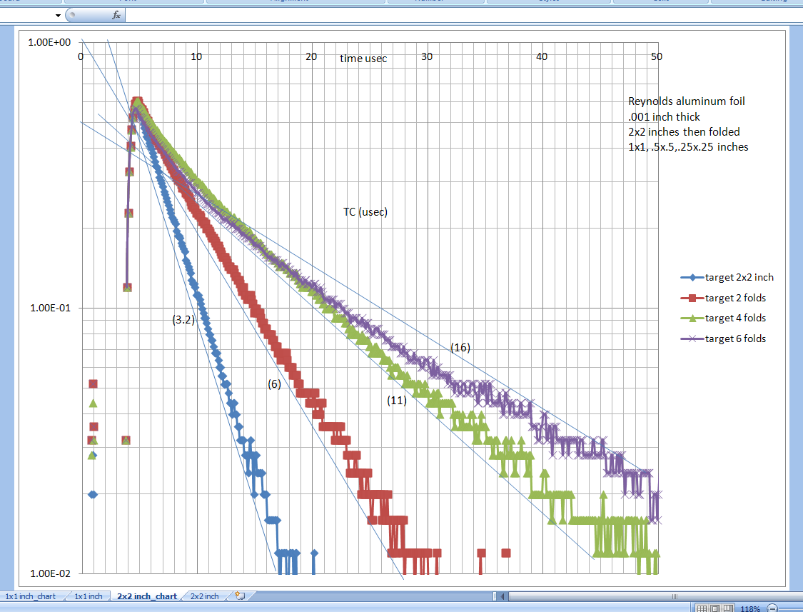

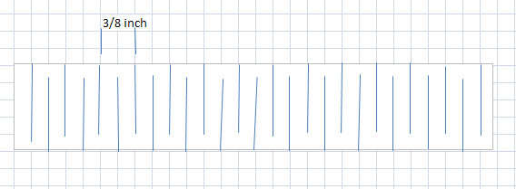

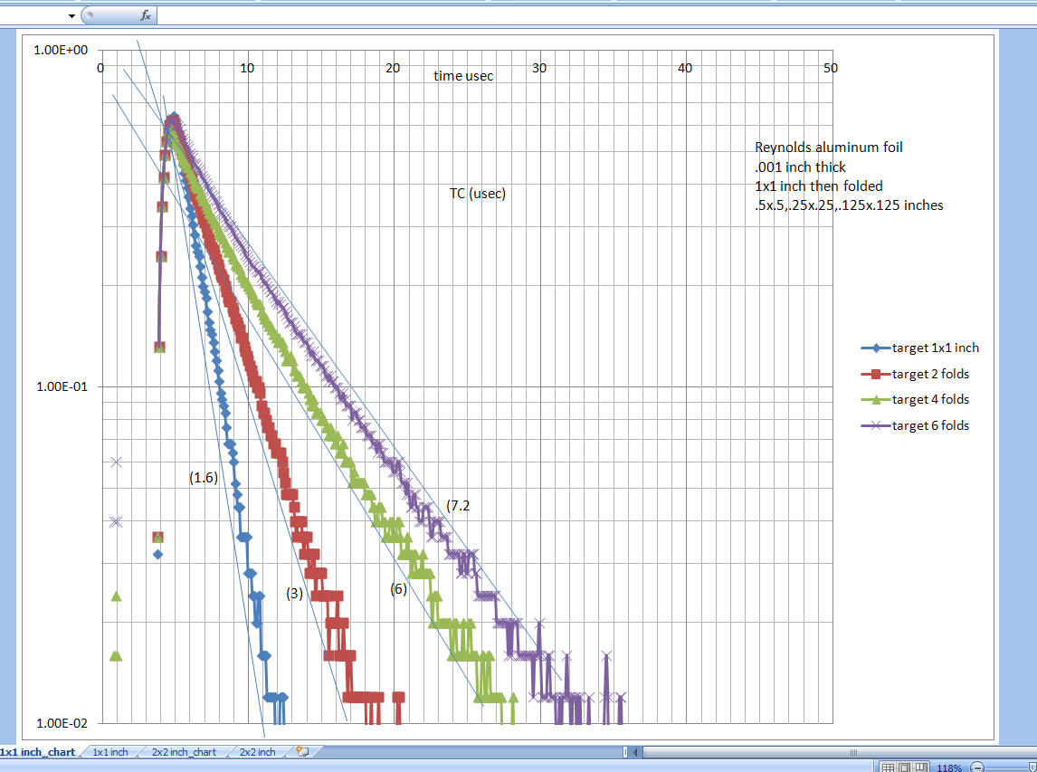

                Was looking at some of the charts I posted in the past to see if I could learn something. Comparing the 2 x 2 inch gold simulation and the 1 x 1 inch gold simulation, with no folds ,2 folds and 4 folds the time constant doubled with 4 times the area or volume. The 2x(x) chart the time constant doubled with 2 times the area. The length stayed the same where the length and width both changed in the above comparison. The 2 x 1.25 in foil_6,5,4,3,2,1 chart the time constant stayed the same, total area changed. Each section though connected stayed the same.
                  Intuitively the result in the '654321' test makes sense to me since the strips were all consistently slotted causing discreet areas for eddy current boundaries and the removal of successive strips made no difference.
                  The anomaly you point out in the 2xx chart points out the thickness effect but also the elongation effect that we have discussed in this forum before. As I recall there was an example of a 38% difference in the tc when the target was allowed to be elongated compared to keeping it square. I think the targets in that case were cut from pop can.

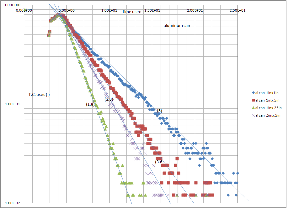

                    aluminum cans from earlier post. The 1 x 1 divided by the .5 x 1 is 38 percent, the .5 x 1 divided by the .25 x 1 is 100 percent. One thing I've learned is I don't know how to predict what the time constant will be yet. Would like to have plots of some small gold nuggets to compare with the aluminum or lead shot if the aluminum targets don't match time constant and amplitude. I think they both need to match for a good simulation.
                      I agree. I think aluminum can is a very good and readily available material worldwide that is easily fabricated but I also think it is a bit thinner than a typical 5 grain gold nugget. That is partly why I tried to figure the volumetric approach between Al and Au. It is entirely possible if not probable that a 5 grain nugget is 3 or 4 times thicker than Al can material. If that proves out to be true then Al can material could be folded to get closer to the thickness requirement and the weight of the piece could be correlated to the gold equivalent from the 7.12:1 ratio of SG Au to SG of Al.

                        Intuitively, a multi layer target behaves like a multi layer iron core from a transformer. The eddy currents are mostly confined to each layer.
                        However, the eddy currents of each layer have their own magnetic field and the magnetic fields add up somewhat like the multi turns of a coil. It is actually the influence of these fields, within the coil field, within the Earth's field that we measure.
                        An interesting test target is a sphere of lead, or rather several identical spheres of lead like fishing lead sinkers, that can be hammered into different thickness. This way we can easily observe the difference in response of targets of the same mass, but different shape.
                        Looking at the different response of these targets, gives insight into the effect of the target area presented to the coil field x the diameter of the coil.
                        Another interesting effect is to look at the response caused by the skin effect that becomes specially significant when the targets are very thin.
