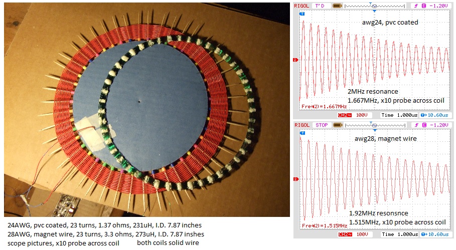

              I Got a chance to finish the 8" 3DSS mono coil with the 330/46 LITZ wire. Cleaned the insulation off much better readings know thanks for your help.
              Here is what I got know
              37 turns with 42" twisted leads
              Resistance 1.7 ohm
              Inductance .329 mH
              Hooked it to my MPP it does not perform as good as the 7" 3DSS round made from telephone wire at .294 mH ( not 2.94 as posted above sorry )
              I only get about 6" on a US nickel on the 8" coil and the 7" gets about 8.5" and that's not inline with others I have seen posted.
              My MPP is still as per the build document the dampening resistor has not been changed so I'm not sure how that effects it.
              O well such is the learning curve, but I have not give up on it yet.

                Darin, I would definitely do the Critical Damping resistance change for this coil. Also I believe this coil should run at a shorter sample delay than the solid copper telephone wire does. This is why Mine Labs uses the Litz wire. You might be pleasantly surprised! I would expect that the 8" coil would operate at 8us and possibly lower. By the way your 42" feed line adds about 1pf of capacitance per inch of length so it is best to keep it as short as practical. Capacitance is the enemy of coil speed and that is why the 3DSS coil is designed to keep it low with all that air space and winding separation in its design.
                Dan

                  Thanks Dan, I have to pick up some resistors to make the damping tool to adjust it then hopefully it will be a good coil. I left the leads long as I do not have a shaft or box to mount everything yet and did not want to come up short. I am thinking of using a straight shaft and mounting the control box underneath at the back. Once I get all the parts I will cut the leads. Would like to find some connectors like Garrett uses that are waterproof for the coil and headphone connections. I'll keep you posted how it turns out.
                  Thanks again Dan

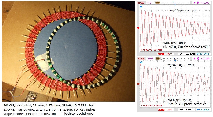

                    Wanting to see if I can see the residual eddy current decay of coils wound with different wire. Where I'm at and what I'm thinking. I have two coils, spider wound with solid wire, one AWG24 and one AWG28. Don't have Litz wire but I have AWG34 magnet wire. Think of twisting 4 strands of #34, same resistance as AWG 28 and winding a coil. 23 turns, same as other coils. Including some data on the two coils. Coils not shielded, about 12 inches Teflon coated twisted pair for lead wire. Thinking it makes sense to leave the coil resonance as high as possible to allow early sampling for the comparison. Need to connect coils to a coil driver and pre amp and compare decays, scope and maybe LT spice simulation of the same circuit. The scope resonance pictures were taken with the coil connected to the coil driver with no damping resistor and the pre amp disconnected with a x10 probe across the coil. The resonance is higher with the scope probe disconnected laying close to the mosfet. Suggestions appreciated.

                        I've been assuming coil wire eddy current wasn't a problem with AWG28 solid. Trying to find out.
                        I think coil resistance just effects circuit efficiency with a PI detector, if the current profile is the same with a 5 ohm coil as a .5 ohm coil the target signal will be the same. Maybe not? The 5 ohm coil needs a different PS and a bigger battery.
