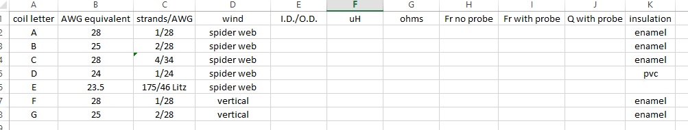

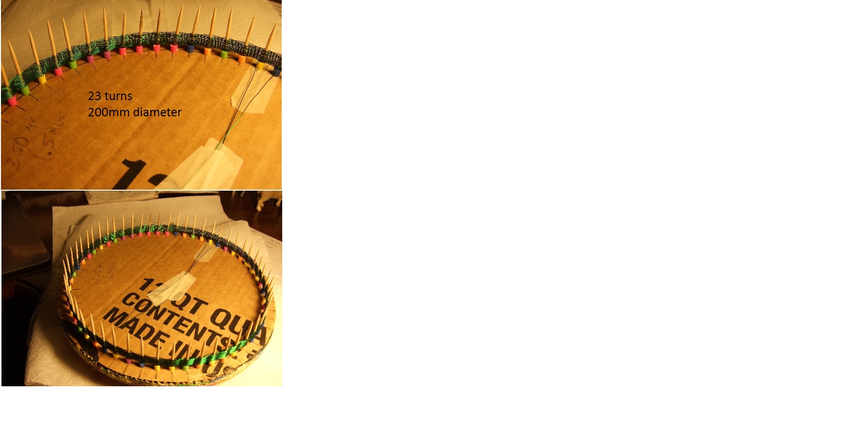

          Wanting to see if I can see the residual eddy current decay of coils wound with different wire. Where I'm at and what I'm thinking. I have two coils, spider wound with solid wire, one AWG24 and one AWG28. Don't have Litz wire but I have AWG34 magnet wire. Think of twisting 4 strands of #34, same resistance as AWG 28 and winding a coil. 23 turns, same as other coils. Including some data on the two coils. Coils not shielded, about 12 inches Teflon coated twisted pair for lead wire. Thinking it makes sense to leave the coil resonance as high as possible to allow early sampling for the comparison. Need to connect coils to a coil driver and pre amp and compare decays, scope and maybe LT spice simulation of the same circuit. The scope resonance pictures were taken with the coil connected to the coil driver with no damping resistor and the pre amp disconnected with a x10 probe across the coil. The resonance is higher with the scope probe disconnected laying close to the mosfet. Suggestions appreciated.
          http://www.geotech1.com/forums/showt...042#post213042
          Teleno suggested a vertical coil in the thread above. Think I'll add 1 or 2 vertical coils to the Litz wire comparison. Including a chart of coil information. Should I add more columns? All coils, 200mm I.D., 23 turns. The main purpose of the test, see if coil shows in the decay curve. Other comparisons to look for? I could try the Litz vertical also if I test on the spider wire coil form, unwind and wind on a vertical form. Fr is circuit resonance with Rdamping and input resistor disconnected. Measured with scope probe near mosfet and with scope probe across coil.
          • #65
            Attached is an example of a vertical basket coil that should be considered. The dowels should be shorter. Toothpicks may not be strong enough.
            Have a good day,
            Chet

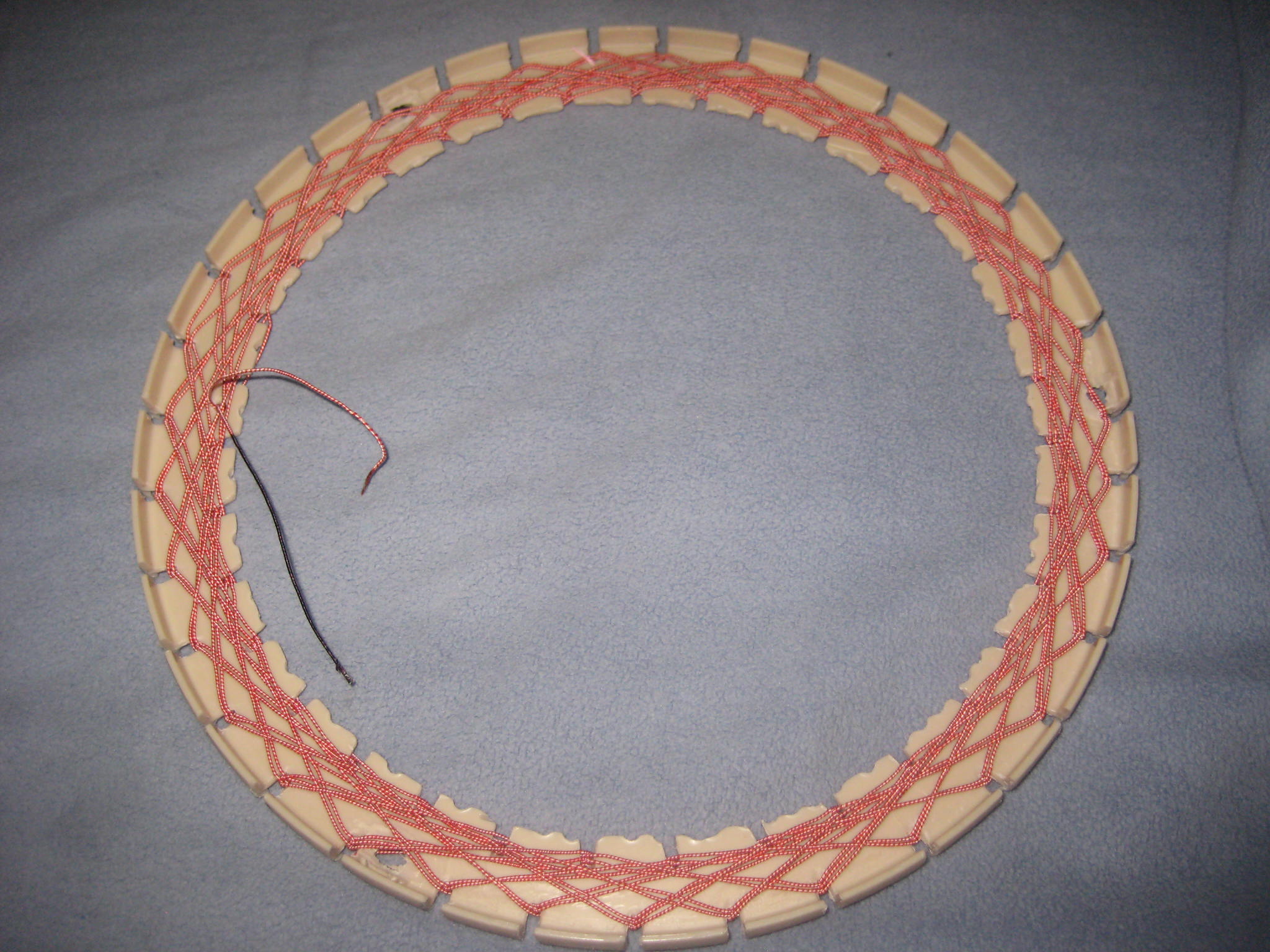

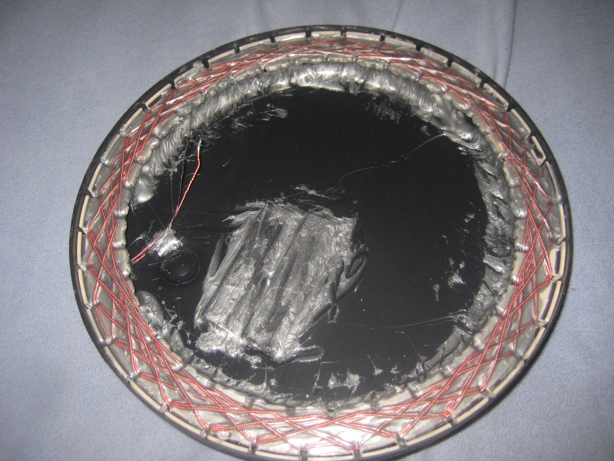

              Here's a 10" Litz 3D Race Track Basket Weave Gutter Mount Coil I just made using 175/46 Litz;
              I used Gutter glue (tri-polymer based formula that is semi-self leveling) to affix the windings
              (I hope there's no metal in there!). I couldn't figure a way to route the Litz safely up to
              the control box so will use some Fishfinder 2 lead wire for that.
              (10" 175 Litz 3D Race Track Basket Weave Gutter Mount Fish Finder coil?)

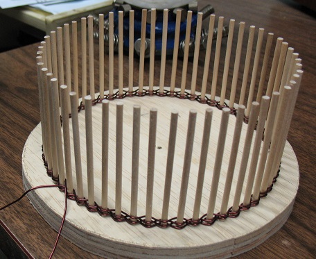

                Have a good day,
                Chet
                The toothpicks were strong enough for AWG28 solid magnet wire. I'll add it to the list of coils reply#64.

                  • #69
                    Hi Green,

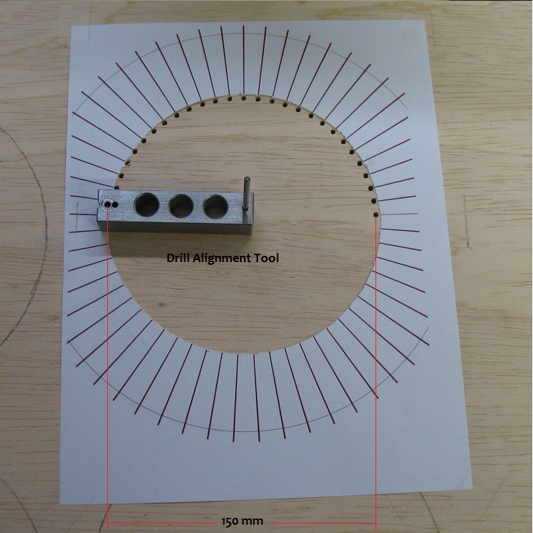

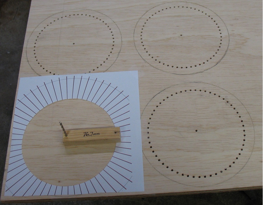

                    Another great looking coil. I've had good luck with the toothpicks on a dart board. A finish nail can be used for stiffer wires.
                    I use a small awl to pre pierce or punch the dart board then insert the picks with a pin driver I made from brass. You can make very fast forms. A cheap board is about 9 bucks and totally reusable. .
                    I have a couple of new vertical winds to see what you guys think about. And the 3dss can stack in a vertical way by using configurations of three toothpicks but advancing forward in a row instead of like a slot if that makes any sense. I will ad some pictures when I get back home again.
