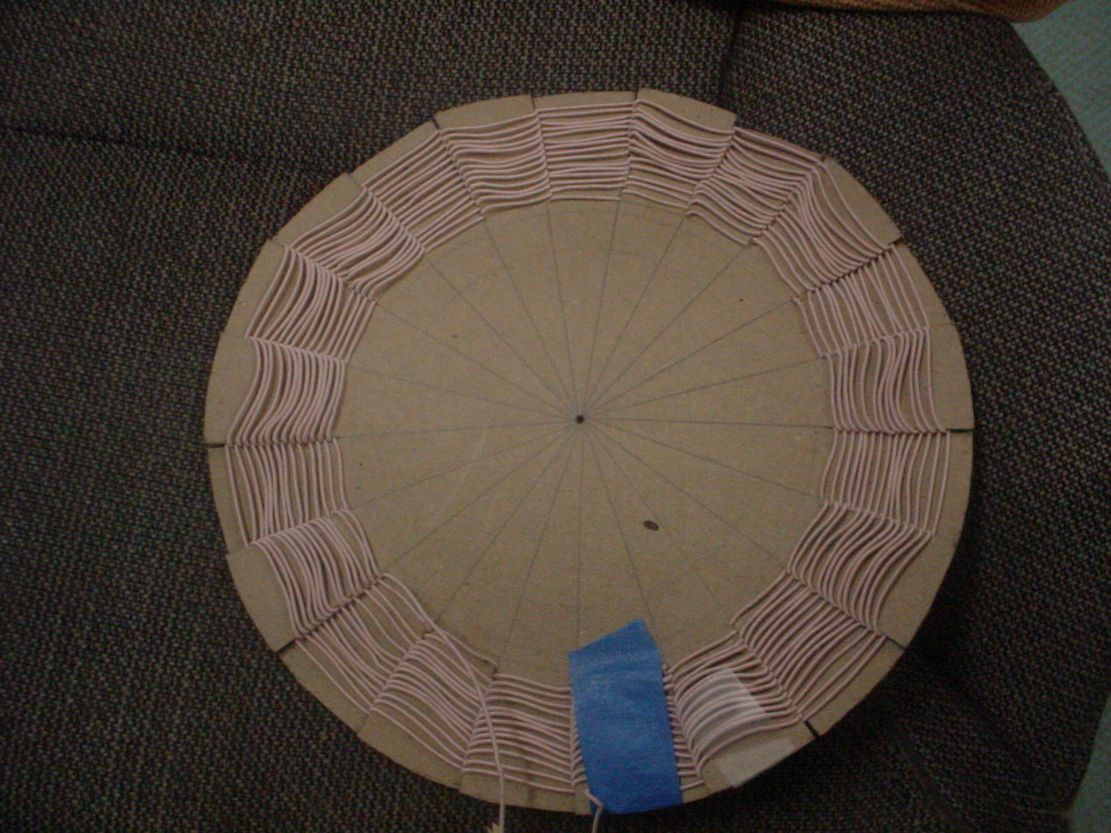

                I got the Litz wire and had a chance to wind it on 20.5 CM coil form. I used card board, until the FR4 material comes in. The results are as follows, a gold ring was test is 21CM. I used a piece of aluminum foil 21CM it was found at plus 46 CM. I tire to shield the coil it DIDN'T work at all. Well that is my results of my basic test. Best to all Jim
                  Could you post some pics of your coil
                    In my very limited experience building coils for pi, the flat spiral wound coil gave best results especially on small gold. All the basket type coils i made were very disappointing, especially considering the time it takes to make one of these. But that is just my experience.

                          I would be happy to post some pics. I have the hardest time posting pics to this board. I try an figure out what I am doing wrong. Best to all Jim

                              Picture of my 1st attempt of a basket weave.
Name:	PI Basket Weave Coil.JPG
ID:	349660 I hope the picture comes through, and thank you 6666 for your help. Best to all Jim
