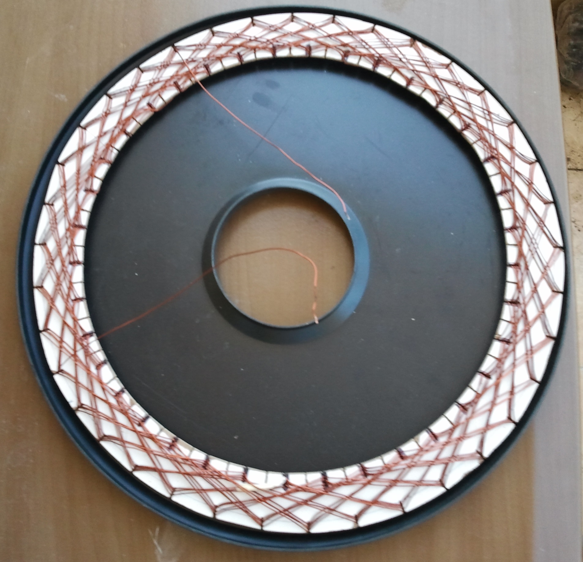

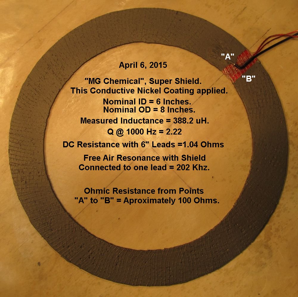

          here are some variations on basket weave coil and instructions on how to make.

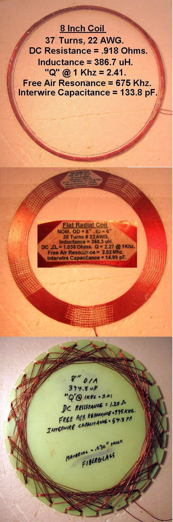

            Its interesting re reading that PDF, it states the capacitance for that type of wind is about 80 pF, which is pretty low and should give a fairly fast coil,
            by comparison when we look at the estimated / measured capacitance of SIMPLE flat basket weave / flat spiral weave coils they appear to be even lower.

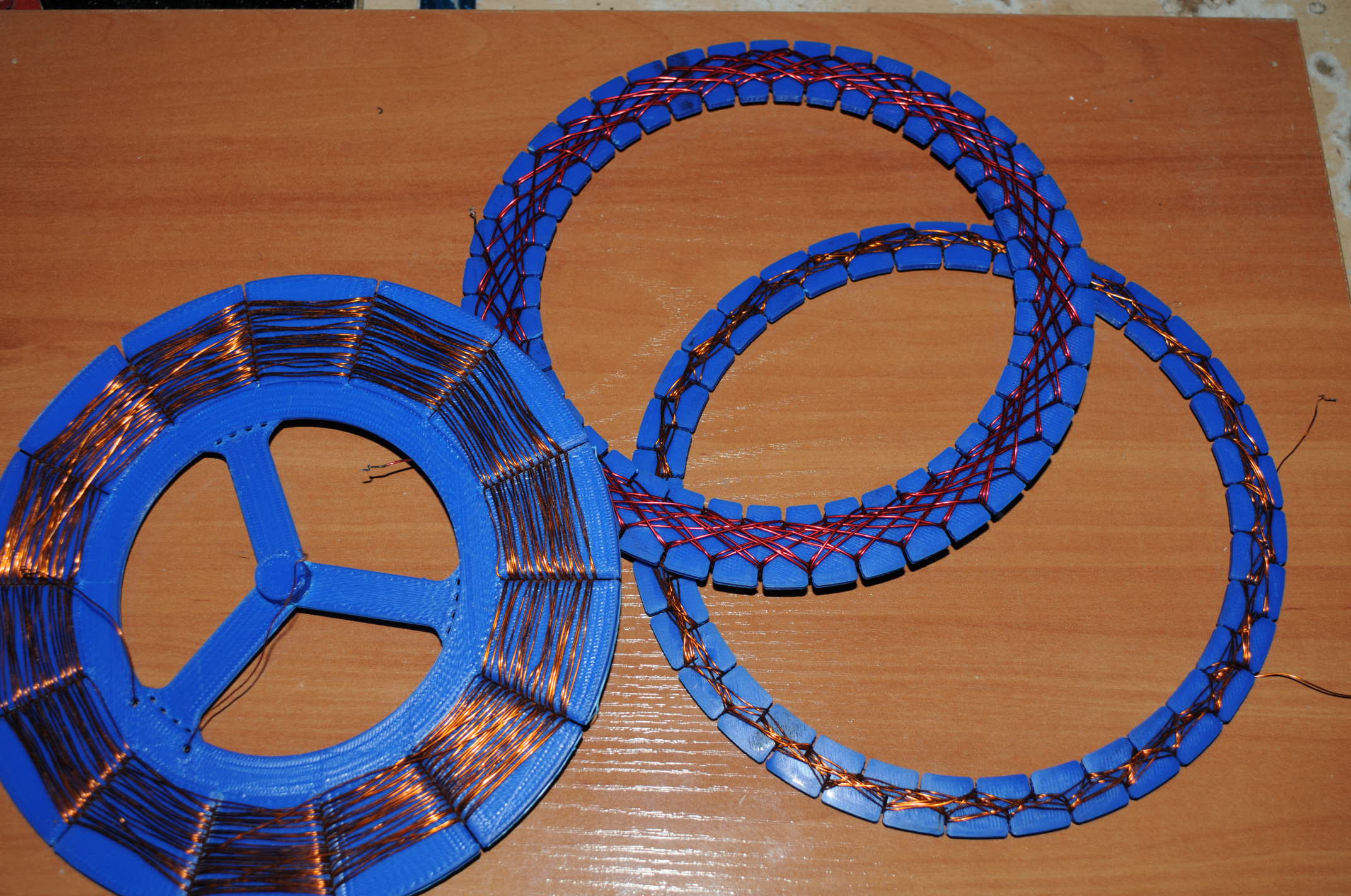

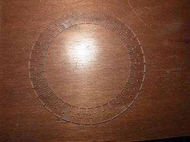

                6666, I noticed the same thing as well, That is why I abandoned making basket weave a long time ago, in favor of flat spiral. The last spiral i made gave me the best results ever. It turned my surf pi into a monster. I get app. 10 inches depth on most coins,12 inches on gold ring.These are actual tests in dry beach sand over here. I'm looking for a simple jig that would make winding flat coil much easier.
                  And this is best coil calculator i have ever used for bundle coils. It is very accurate when compared to actual measured coil.
                    thats easy, a spacer and 2 disks, one disk with slots to apply glue.

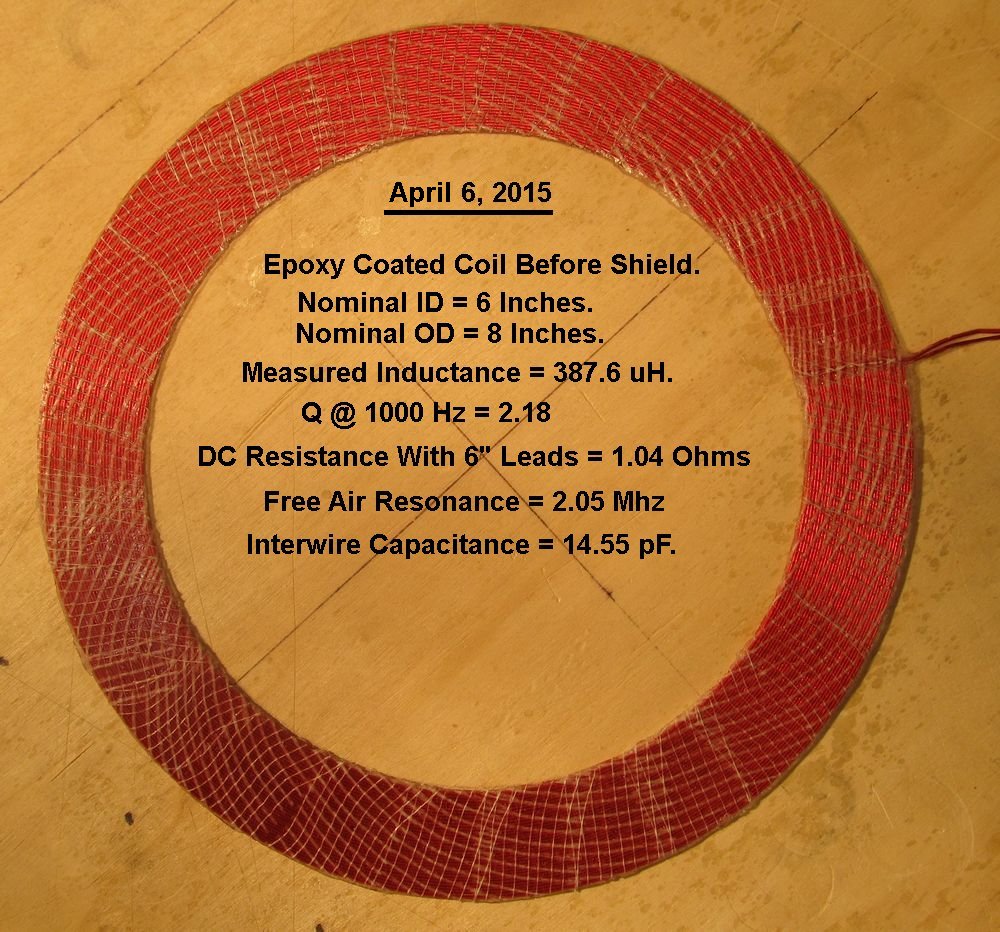

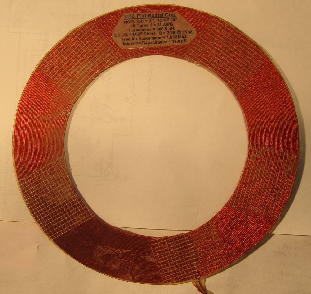

                      Wow now I am confused, what I get out of your post is a flat spiral wound coil has less capacitance than a basket weave coil? I assume that the coils were not wound with Litz wire ? If I am wrong please feel free to correct me. I think a spiral coil wound be much easier to wind. I sure would appreciate any information? Best to all Jim
                        All thing being equal, generally speaking, it seems so. take a look at these coils which were measured.
                          As you can observe, at least from this comparison, the fastest coil is the flat radial.

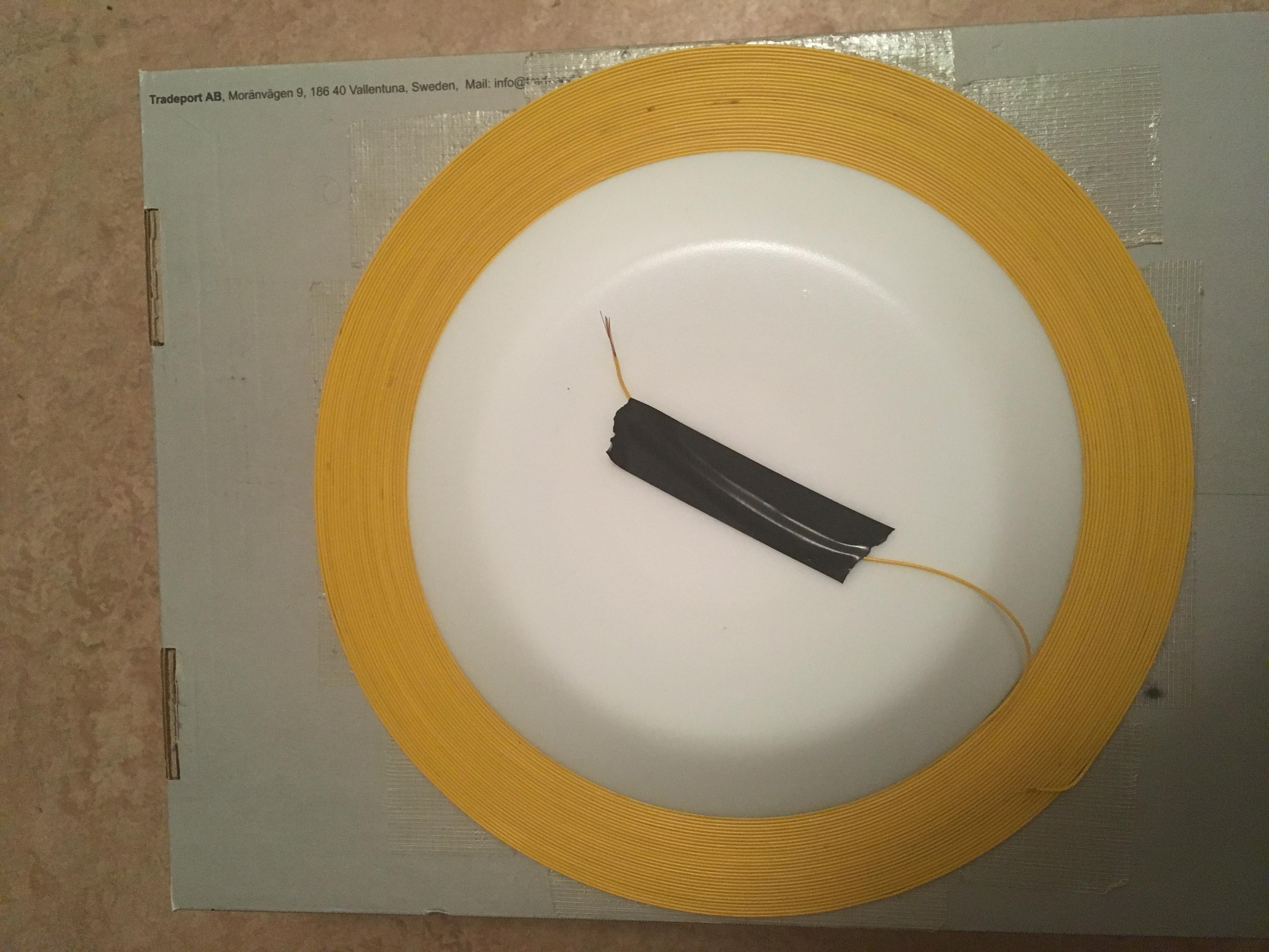

                              I have a question, about construction of a spiral coil, using Litz wire. I for the life of me can not understand how to wind the coil without it falling apart. There must be some form of a special device used in winding the coil, because the Litz is so flimsy. Thank you all for any advice you can share with me. Best to all Jim
                                Double sided tape. I just made it yesterday in about 10minutes
