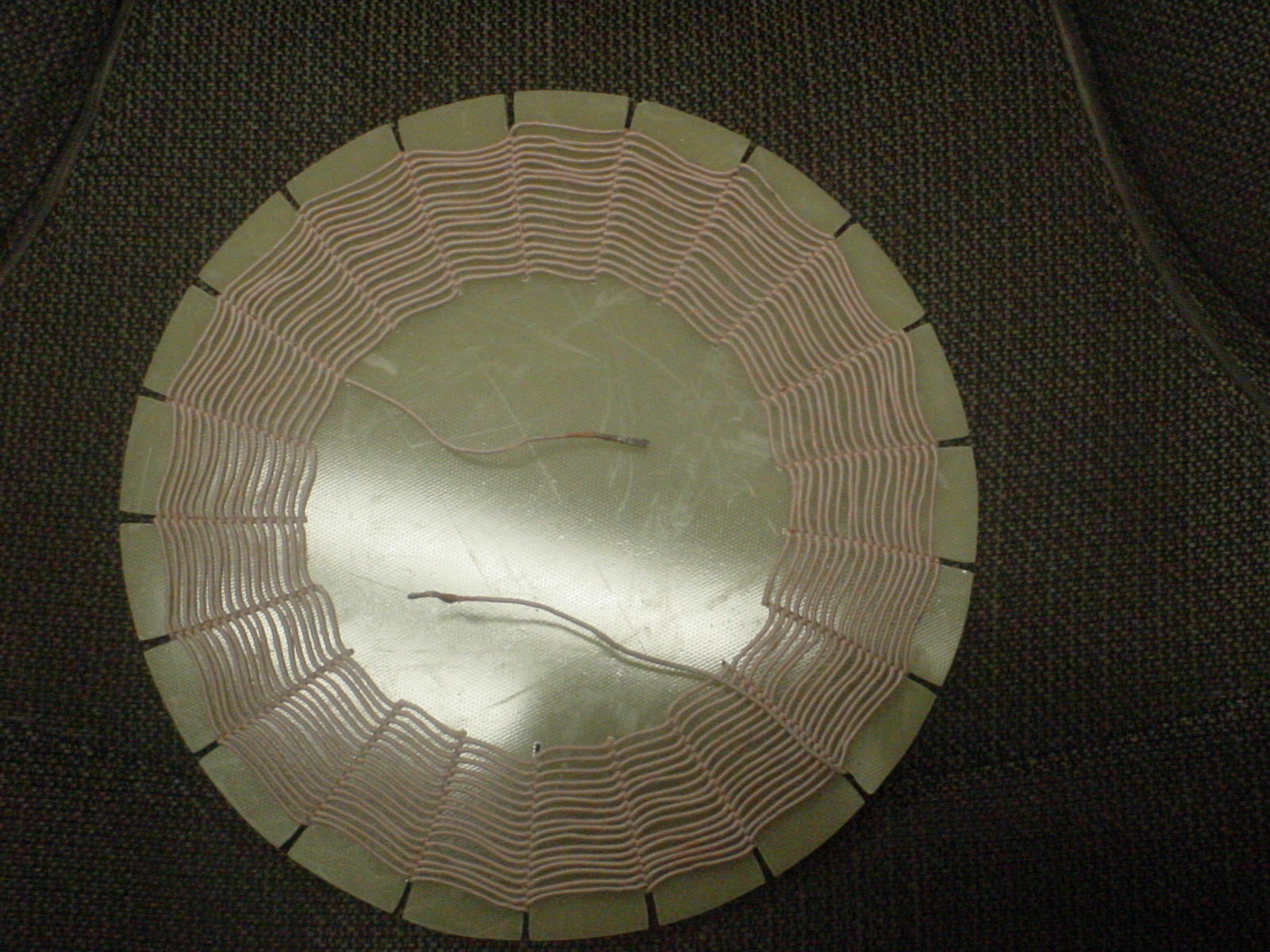

            If you compare a round random bunch wind coil to a flat spiral you should notice a increase in sensitivity to small objects , small coins etc also if your machine is good at detecting gold IE gold nuggets there should be a increase in sensitivity to small nuggets, ESPECIALLY if you stack the windings IE 15x15 rather than 30 turns.
            They are actually quite easy to make and a number of different ways with former or none, keep the resistance low, adjust number of top stack for the required inductance.
            [ATTACH]41110[/ATTACH]
            [ATTACH]41111[/ATTACH]
            [ATTACH]41112[/ATTACH]
            Thanks for the info.

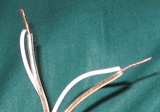

            I'm going to try pvc insulated, twin lead, speaker wire or lamp cord. I recall someone on the forum doing this in the past. It seems you could use super glue as turns are added. People using the Evolution coils report good results, so there must be something to it.

              I have one more question, if you wind a spiral coil using speaker wire should the windings around the former be horizontal or keep the wire vertical to the horizontal plane. Thanks so much. Best to all Jim

                Tried with double sided tape. Compared with flat basket I've been winding, no lead wires. Shielded top and bottom with graphite paint, 2mm craft foam spacer top and bottom. Flat basket slightly better, probably no difference with added lead wires.
                James, Haven't tried with speaker wire, I would try with the 2 wires vertical, minimum radial width.

                  I think I uploaded a picture of the new basket weave coil. it is made on G-10 board. I measure 224 uh, resistance of 1.2 ohms. I tested the coil in free space, detected a gold ring at 20.5 cm to 24.5 cm. I found holding the ring different ways gave the 2 results. Best to all Jim, I do think I will try the speaker wire coil
                    short the ends
                    • #55
                      Thank you for the info, Best to all Jim
                      • #56
                        short the ends
                        Just to be clear on this
                        when I said short the ends, if you use figure 8 speaker wire cable
                        you will have two parallel wires from one end to the other
                        at each end of the cable twist the two wires together
                        so you will have a separate join at both ends of the cable,
                        this makes the coil one thick wire.
