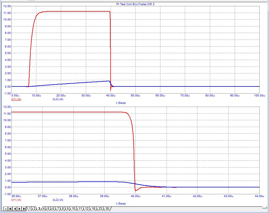

    Here it is. You may need to tweak the damping resistors to get to your 1 second sample. I did some tests a 2 usec and had a 30-40 uvolt change between "target" and "no target". I haven't refined it too much. I would try commenting the TX/RX K statemet and tuning the TX damp, the un-comment and tweak the RX damp. In Eric's real world setup, there seems to be no need for a TX damp. This could be, as he suggested, because of the properties of the shield fabric material (those properties that make it an effective emi shield).

      Try 27 for R1 and 580 for R2. Difference between "target and "no target" is (-)66 uV @ 1 usec.

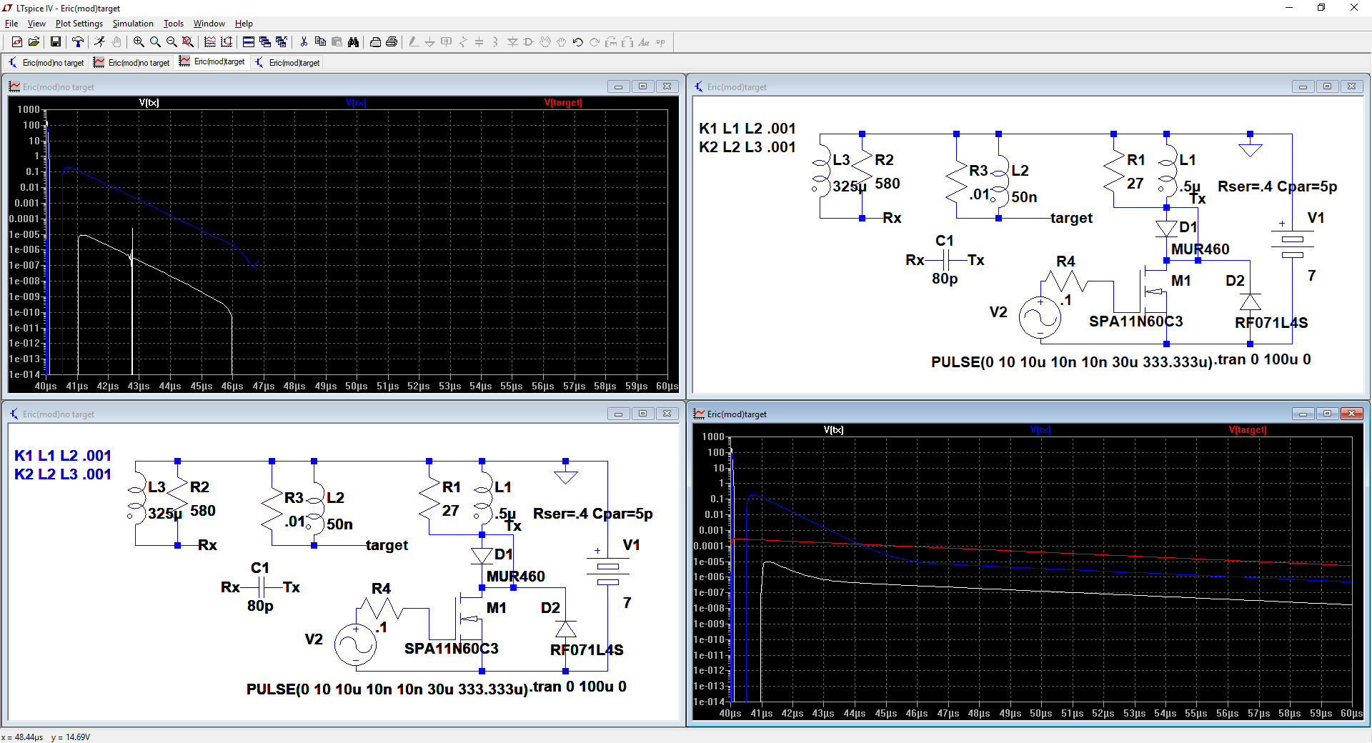

        Thanks. Tried it but I'm missing something. Click on target and don't see target voltage. Click on Rx and don't see 5usec TC target decay, should be 11.5usec/decade. Getting late and I'm probably doing something wrong. Won't be able to look at again until afternoon 5 Dec.

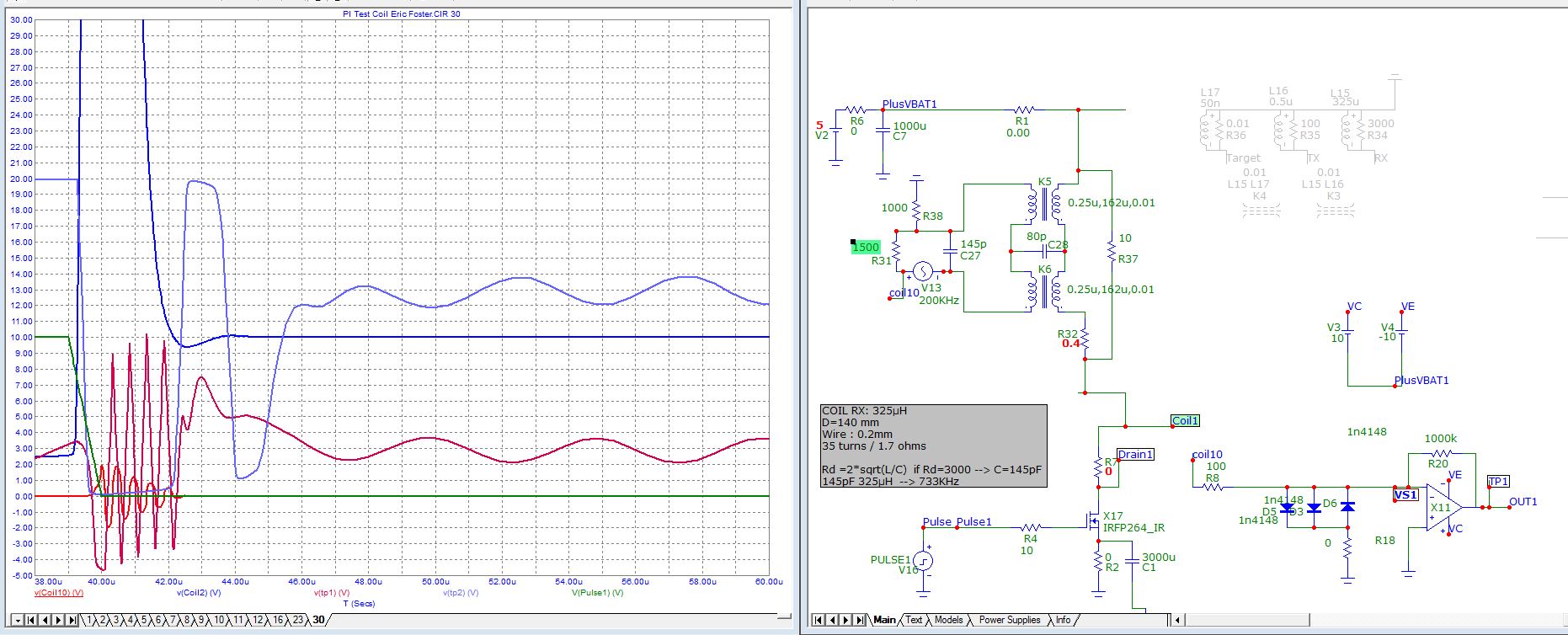

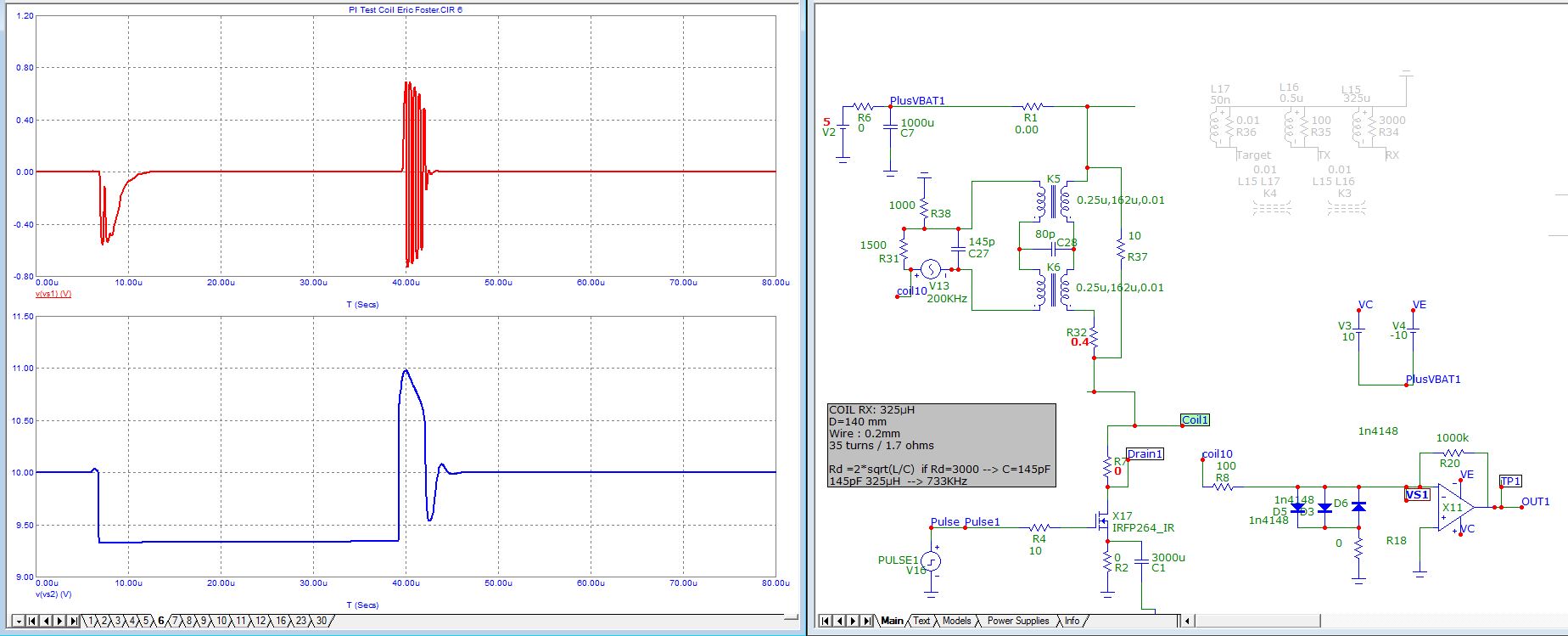

          I have made some others runs.
          I have change the Mosfet, to 0.0xx Rdson , So the current , at 5V supplies is more than 10A. I had 8 previously.
          I change the coupling model, so I use two transfo instead of one, with the 80 pf coupling in the middle.
          And , a difference with LTspice runs , the coils are not connected , as it can be seen in light grey in my pictures.
          I also have change the ref ground of the RX coil, adding R38 /1000 ohms.
            Found what I was missing. Spice directive. The Rx signal is about .1 volt at 1usec. I have been thinking the no target decay would need to be closer to the target signal to detect. Just looking for a change so maybe not correct. With the no target signal at .1volt amplifier gain would be limited to around 50. Is there a no target signal level to try for when adjusting first delay?

                The spice models are predicting a Tx back emf close to 200V at switch off instead of 12V. Any ideas why the difference, maybe the reason Rd not needed for Tx coil?

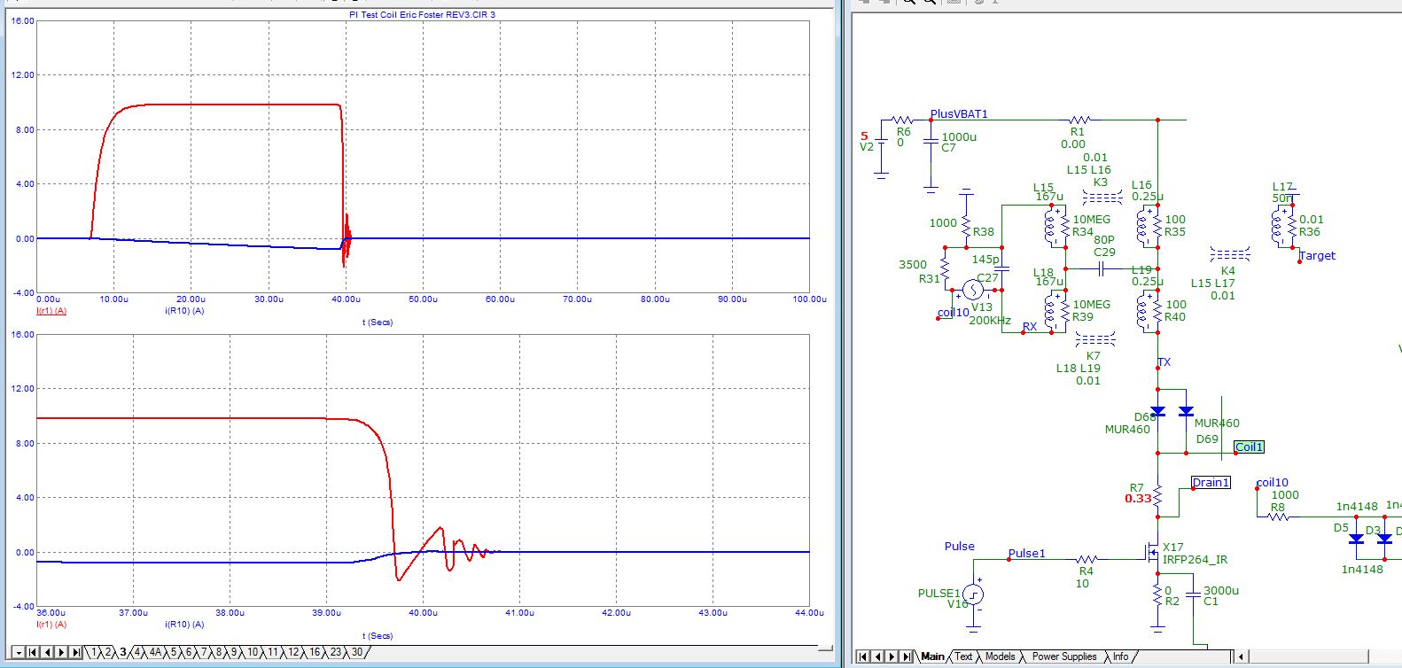

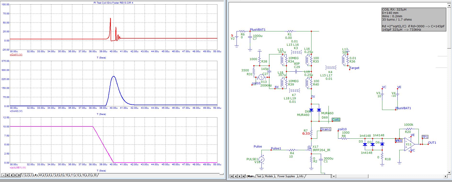

                  I have changed the coil modelling, by using coil with coef K . (And a target coil too ) . I cut coils in two half coils to have the 80p in the middle.
                  See screen copies.
                  The 10A current is reached , but the mosfet used oscillates without the resistor R7. 250v 38A but hight output capacitance 870pf . It generates others Auto TX 20 µs later, and 30µS..
                  The flyback voltage goes up to more than 50v, depending on the value or R7.
                  The coupling values needs to be looked closely, measured if possible. The behaviour changes with them.
