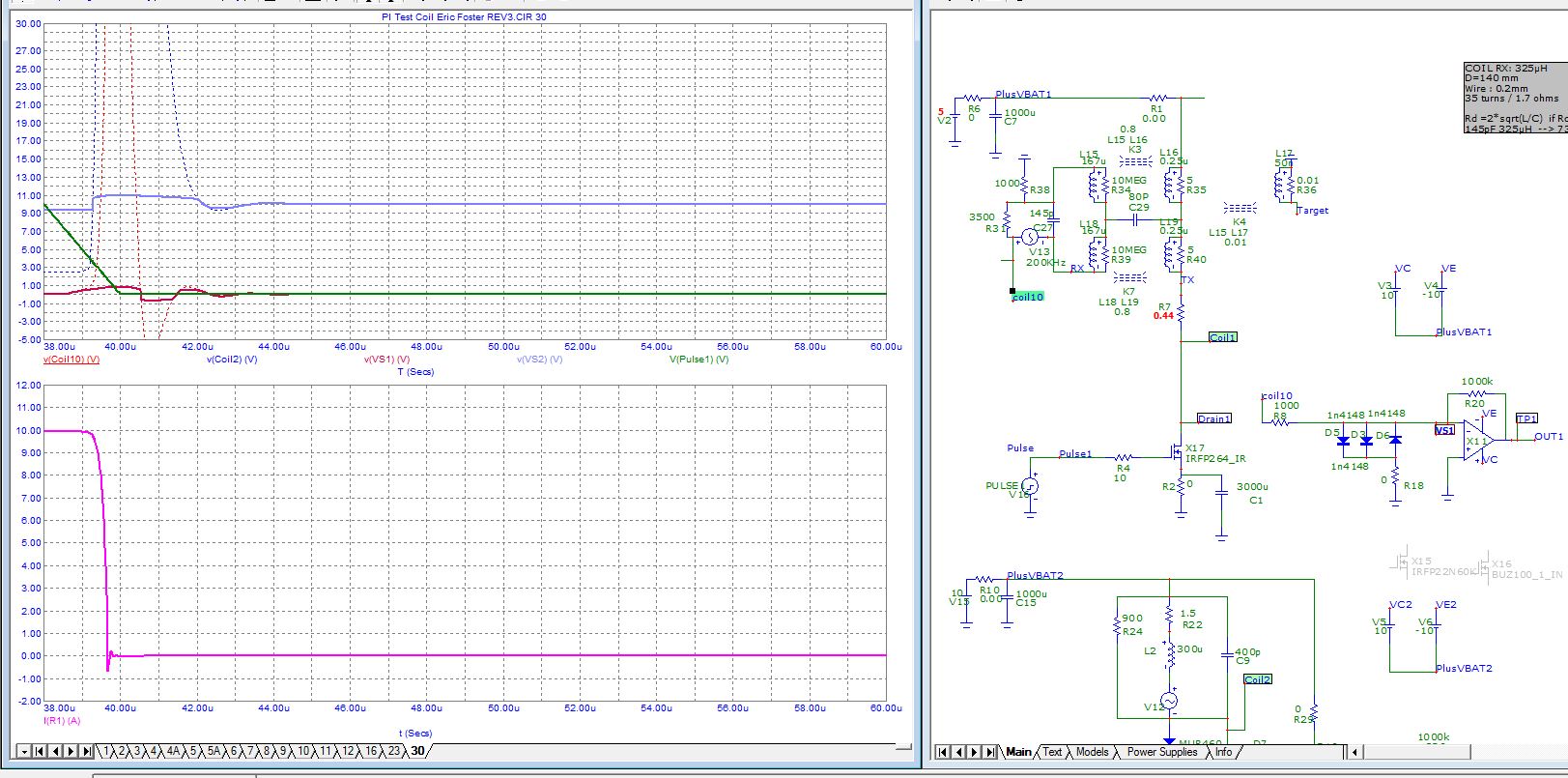

    Green, Where did 2 nf come from? Given the circuit, discounting the effect of the fabric, I would expect the resonant freq to be in the range of 17-20 MHz assuming the coss of the IRFP220 @ ~150p and a gap capacitance of less than 5p (of course this capacitance would increase when he (if he does) adds cable). This is probably why the fabric is so effective at damping/absorbing/attenuating the flyback.
    Adding the diode has allowed sampling sooner when coil inductance is around 300uH. Isolates the Mosfet capacitance. A 300uH coil with leads has a SRF is around 1Mhz and with the diode SRF changes very little. I could sample near 5usec, without the diode the resonance is closer to 400kHz requiring a longer delay time. 2nf is just a value higher than what I would expect so I would expect resonance to be higher than 5MHz. Rd=pi*L*SRF, 3.14*.5*5=8ohms. The reason I asked about adding a 5 or 10 ohm damping resistor to see if it had any effect? I'm guessing Rd of 10 or 20 ohms wouldn't effect the circuit. Just trying to learn something or see if I know anything. Have thought SRF might effect initial delay time but if Eric can sample at 1usec with Rx SRF=650kHz probably not.
    Can't find IRFP220 data sheet but IRFP250 has Coss of 315pf@25v and over 2500pf@0v. What voltage level should I be looking at when reading capacitance to calculate SRF?

              HI,
              I also see this old data-sheet from Samsung, and may be it is an obsolete part.
              So I use an IRFP264 in the sim. 250V 0.075 ohms.
              And no doubt that the markings of the mos were also a little erased and not very legible. In my stock, I have sometimes troubles to recognize some components, mostly from TI int CI.
              I have trimmed R7 to 0.44 to fit 10 Amps.

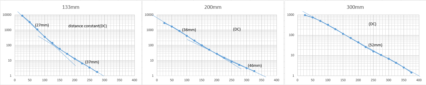

                            Not wanting to side track the thread. My interest is comparing spice simulation with Eric bench circuit. Eric replied he was doing something else for a few days before he could do some testing. So a small side track. I tried a coil in spice to be able to sample at 1usec awhile back. Made one, could sample at 1.5usec, 1usec looks like it could be difficult for me. Reply #54 asked Eric what target TC he was trying to detect. Did a test with three different diameter coils awhile back. Charted target distance vs signal strength. Straight line on linear log chart similar to time(after Tx off) vs signal strength. Time constant(TC) is the time for signal to decay to 37% of the start value. Distance constant (DC) is the distance for the signal to decay to 37% of the start value. Slope appears to be different at distances above and below coil diameter. A (DC) .2 times coil diameter would be approximate value. I think a delay time increase equal to the target time constant would cause a detection loss equal to the coil (DC). Example1: 200mm coil, 1usec TC target, detection distance 150mm@1usec delay, 150-36=114mm@2usec delay,114-36=78mm@3usec delay. Example2: 200mm coil, 1usec TC target, detection distance 72mm@1usec delay, 36mm@2usec delay, not detectable@3usec delay.
                            • #59
                              Tried to add another example but the hour ran out. Example3: 200mm coil, 1usec TC target, detection distance 72mm@6usec delay, 36mm@7usec delay, not detectable@8usec delay.
                              • #60
                                Should have added to replies #58 and #59, valid for targets that have a straight line decay on a linear log chart. Small or thin targets with no skin effect.
