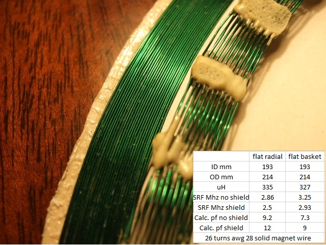

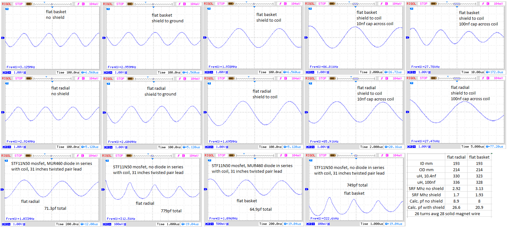

                            I'm just trying to learn. Have read spiral coil is fast but adding shield makes it slower than other winding methods, not what I've found. Most of the time I have more questions than answers. I don't know why the overshoot, looking like the coil is underdamped or why the overshoot is different between the two coils. The flat spiral has a lower circuit resonance maybe some of the reason.
                            Added lead length and Tx circuit capacitance are higher than coil capacitance.
                            Reason shielding didn't make it slower. I check resonance by exciting an operating PI with the test coil(hold it near operating PI coil)with scope connected to operating PI amplifier out. I connected the shield to circuit common instead of one of the test coil leads like I should have(test coil isn't connected to circuit common when checking for coil resonance, wasn't thinking). Including scope pictures of some repeat tests I did today. Wondering if I'm doing something else wrong. Picture flat radial_2 is where shield was connected to circuit common instead of one of the test coil leads. Added some scope pictures with test coils connected to Tx driver with and without a series diode(scope probe clipped to coil lead insulation to minimize added capacitance to the circuit). I calculate coil inductance by adding a capacitor across the test coil when checking for coil resonance. The 100nf capacitor measures 100.0nf on my better meter and 97.5nf on the other meter. The 10nf capacitor measures 10.4nf on both meters.
