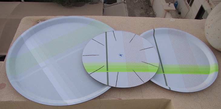

    I have no wide choise here but at least Carefour, Ace and Ikea are next to each other, so after nearly one whole day spend there see the following materials i get:

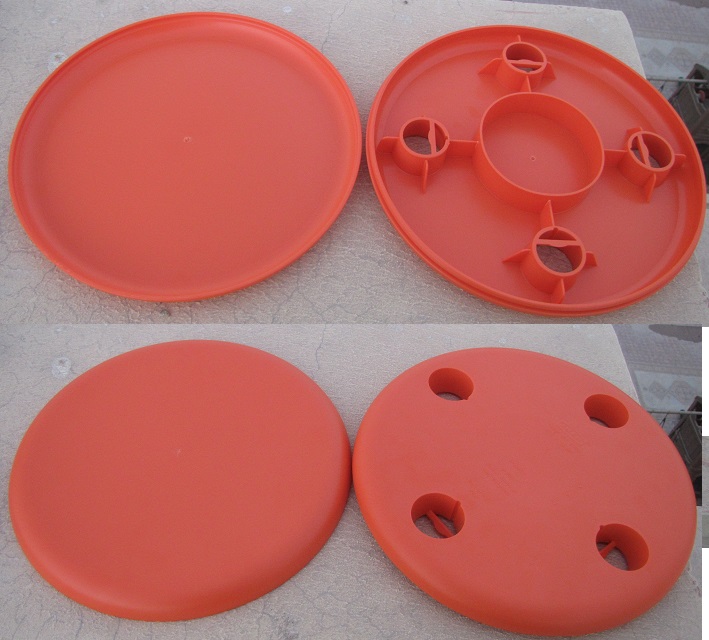

    1.Laminate made serving dish from IKEA -(made in Bulgaria, probably in some of our ex military production factories). Comes in two sizes. Relatively light and stiff, but a bit tricky when drilling or cutting it - tend to crack(material smells getinax when angle grinder is used). The dish can be used as a coil former too.
    2.Mammut child chair from IKEA - made in India from plastic. These are my last discovery. The upper part can be easily dissasembled. Unfortunatelly avaiable only in bright colours and one size.

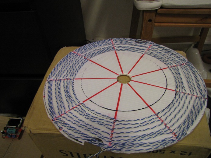

    3.Cake stand from ACE - these are too tick and after removing of the foil you figure out the materialis pressed cartboard. However still usefull for coil forming.
    4.Coroplast board - stronger than cardboard but still easy to bend. I'm usig it only for experiments.

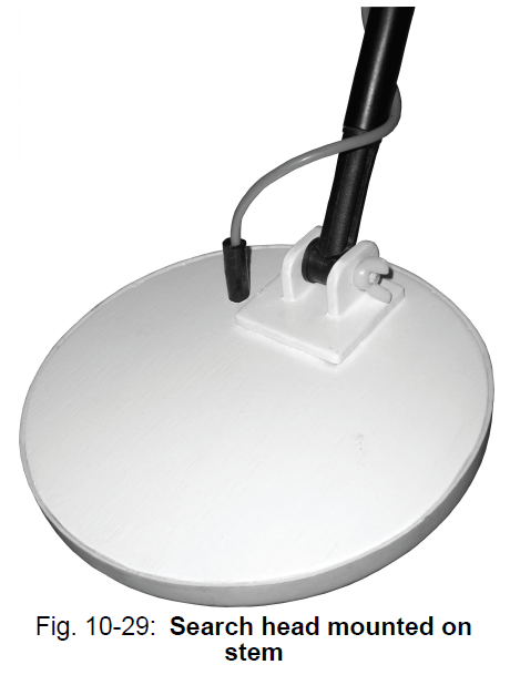

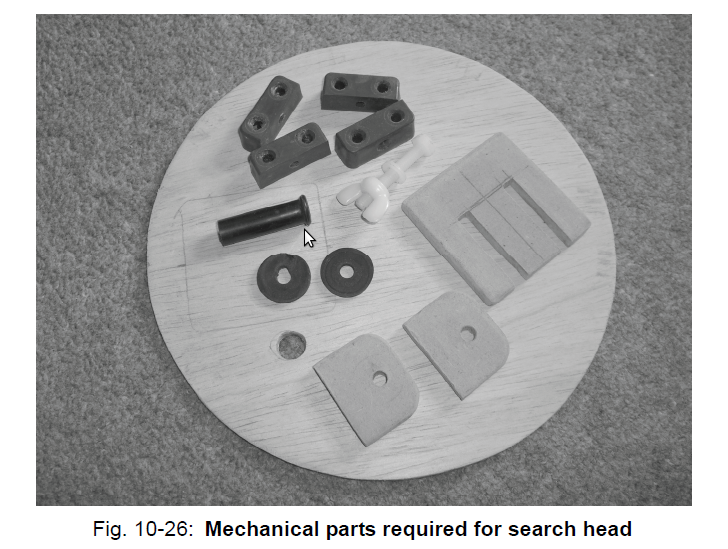

    You could also use the method described in Chapter 10 of Inside the METAL DETECTOR, and purchase an inexpensive coil cover. The top part can be made from either hardboard, plywood or thin MDF.

        I always thought wood is unsuitable because it can absorb moisture ...
          The wood was painted and the joints sealed. Seemed to work just fine during testing.
          You could (of course) use a different material instead of wood.

            And at the end the promised pictures:
ID:	352027Click image for larger version
ID:	352028Click image for larger version
            Links to the materials:
            https://www.ikea.com/sa/en/catalog/products/20382324/ it cost here around 6$;
            https://www.ikea.bg/eating-and-drink...9441/90387422/ again 6$ 32cm, avaiable sizes are 32, 43, 56cm;
            https://www.guineapigcagesstore.com/coroplast-on-sale - quite expensive new at 25$, however if you can source used one it willbe free.

              I know i do not discover the hot water(hot water also can be used to bend PVC;-) but hope this is helpfull to the beginers. Will share pictures soon and show you how i wind inside my UTP basket coil.

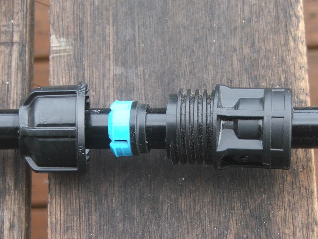

                  Bernte Quick question - is the shaft plastic and what it is from? Especially interested in the telescopic mechanism(the lock nuts and screw).Thanks.

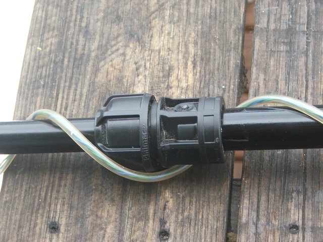

                    My MPP detector is still a work in progress and recently I switched my attention from the electronics to the shaft.
                    For the telescopic section I originally had a 25mm worm drive steel hose clamp but have never been happy with having this chunk of metal relatively close to the coil, especially since the rest of the shaft was all PVC electrical conduit, so I set about finding an alternative.
                    While perusing the plumbing section of the local hardware “superstore” I came across a plastic joiner intended to connect a 3/4” threaded pipe to 20mm polypipe (black semi-flexible irrigation pressure pipe fitting - approx $au6).
                    To my delight it was an almost perfect fit to the 20mm and 25mm conduit and the twist clamping worked very well on the 20mm conduit. The only drawback being that it is a little bulky, but not overly heavy in spite of this. Also, it is necessary to remove a moulded ridge in the centre of the fitting so that the 20mm pipe can slide right through (used a half-round file for this)

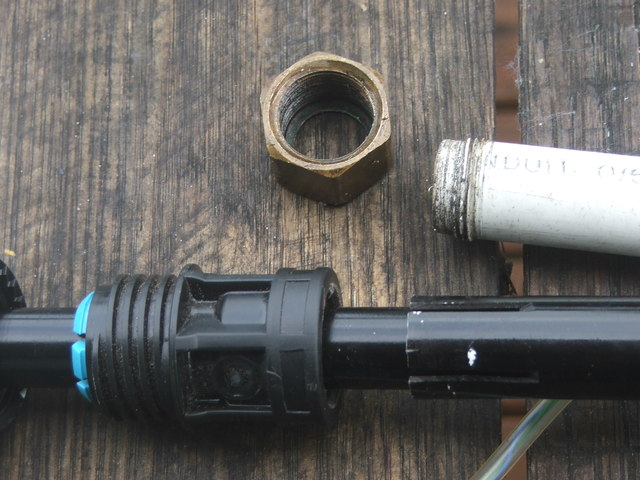

                    I investigated several ideas for attaching the clamp and thought I should describe them in case anyone can adapt them on their own project.
                    #1 Glue 3/4” threaded end of the fitting to the 25mm pipe.
                    This is how I will probably end up attaching it.
                    The 3/4” thread is a taper thread and the PVC can only be forced in about half way so a taper will be needed by filing or sanding the conduit. I will probably end up using this method as the pvc plumbing solvent cement should soften and bond to the conduit forming its own thread. I don’t think it will bond to the fitting as this is probably polyethylene.
                    #2 Melt a thread into the conduit.
                    I experimented with making a tapered thread by heating a 3/4” brass coupling nut and screwing it over the conduit and allowing to cool. This was moderately successful and could be refined to improve it.
                    #2 Thread the 25mm conduit with a suitable 3/4” die
                    It should be possible to cut a thread onto the conduit if a suitable die is available.
                    #3 Make a clamp out of the 3/4” threaded section of the clamp only.
                    A cheaper alternative, especially if the fitting I used is not readily available, could be to use any other plastic fitting which has a 3/4” F taper thread. A suitable M thread will need to be made on the end of the 25mm conduit then 3 or 4 longitudinal saw cuts made in it so that it will clamp down on the 20mm pipe when screwed on. I tried this using the back half of the fitting and it seemed to work OK.
                    P.S. The 20mm conduit is a fairly loose fit into the 25mm – to stop it flapping around I softened it with heat and forced a suitable sized wooden dowel in to slightly expand it.

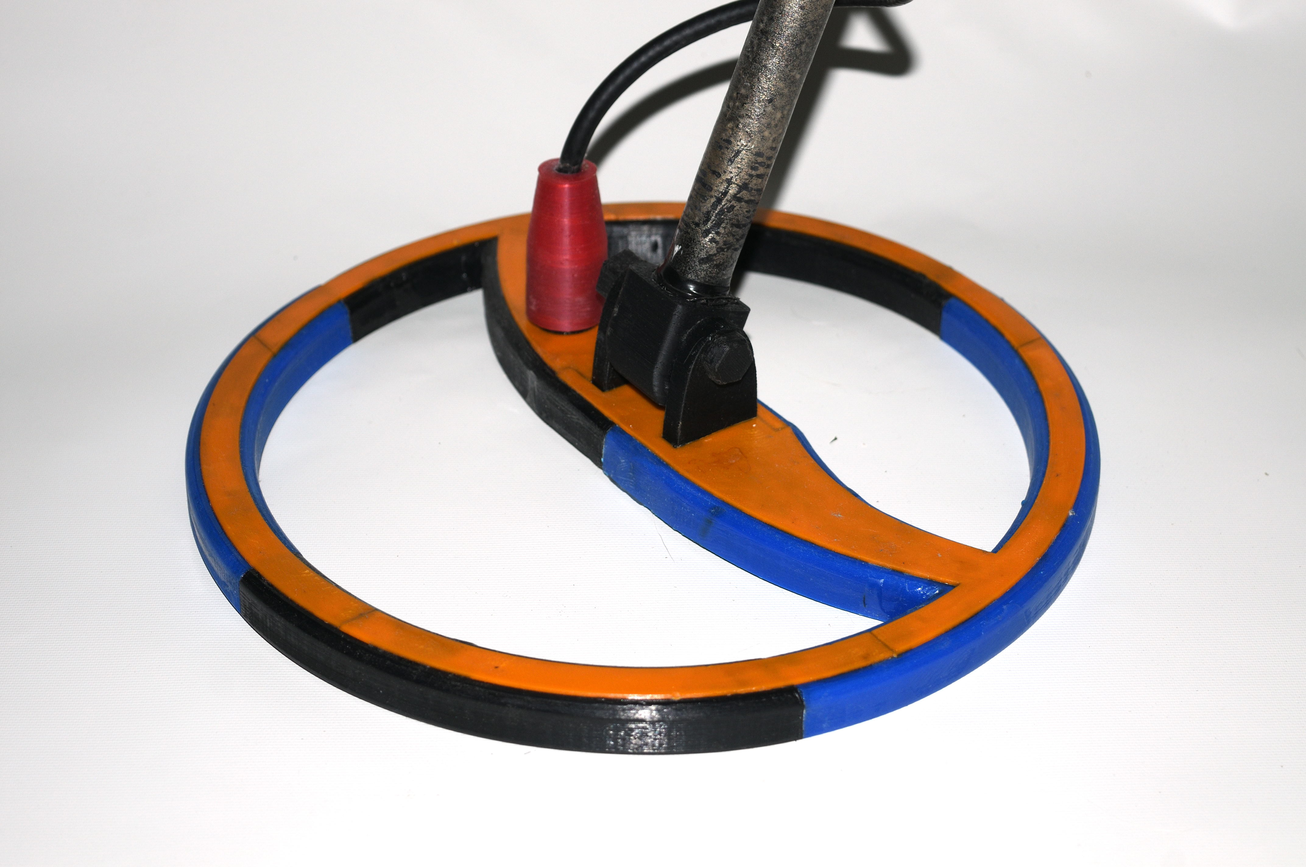

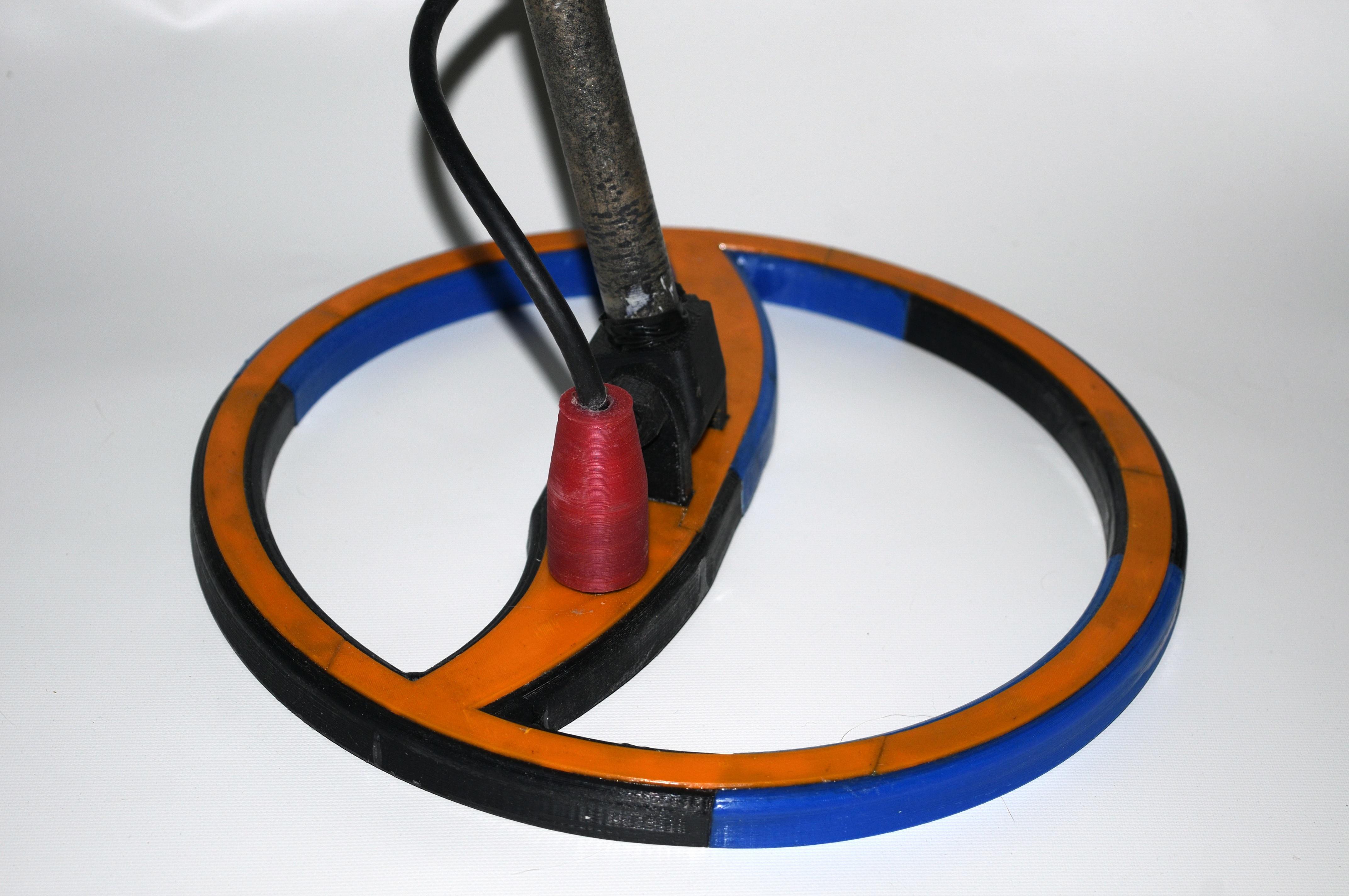

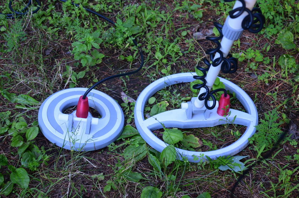

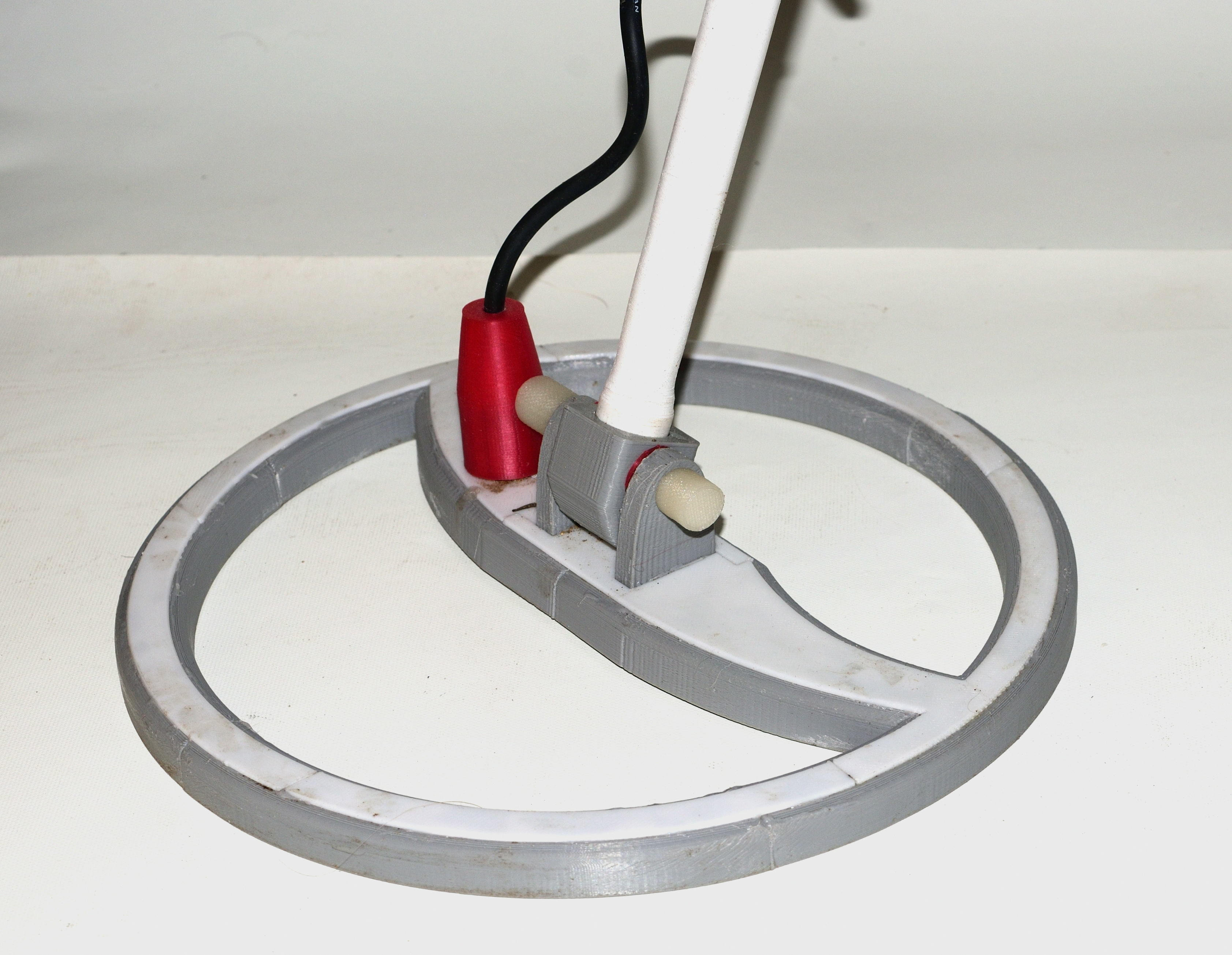

                          I 3d print my coil housings
