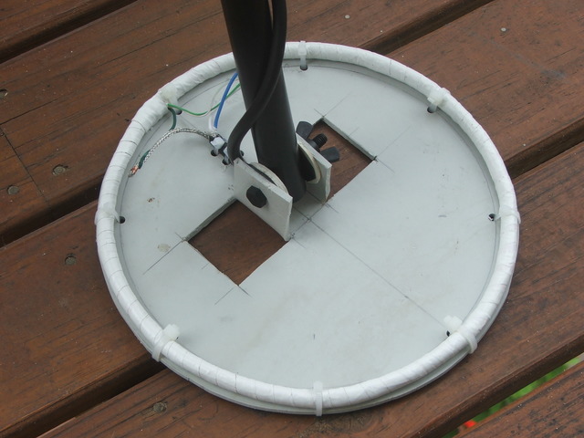

          Still a work-in-progress, this was made from 100mm sewer pipe (3mm wall thickness)
          A sheet of PVC was made by splitting a 300mm length of pipe down the side, softening it with a hot air paint stripper gun and flattening it between two sheets of MDF board.
          The 200mm diam circle was cut out using a jigsaw and the 'ears' with an oscillatory Renovator tool. The cutouts are each 35mm x 35mm.
          Once I tidy up the cable connections I will weatherproof and protect the coil with a coating of neutral cure silicone sealant
          The ears were then bent into shape with hot air and wooden blocks as formers - it pays to wear thick gloves when handling the hot plastic.
          I have also made a 260mm diameter one but it may be too flexible.
          P.S. the coil is bundle wound wire from cat5 shielded with copper tape (400uH 1.4R) - seems to work well on my Pickini.

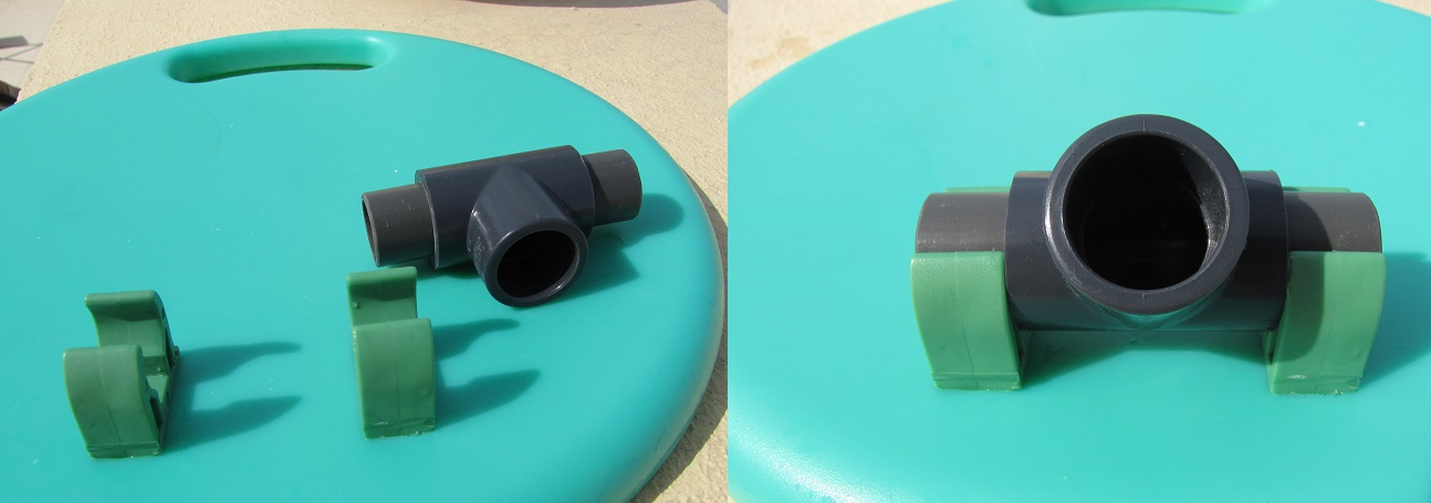

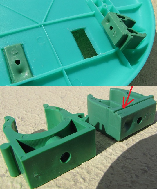

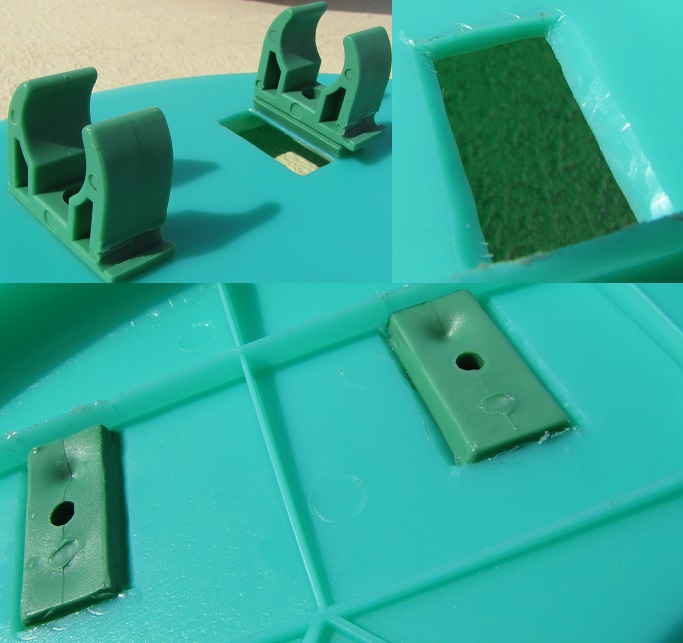

            One more suitable fold-able chair, cant say the manufacturer, bought in Carefour. Cost a bit more - 8$. Also the hinges discovered on Russian MD forums. Look at the pipe clips. I found that type which uses not only screw, but a channel and trapezoidal plug(see the arrow). Very handy, but without zeggy(jigsaw) its hard to make the holes. Time consuming as well. The hinges(clips) will be glued additionally with epoxy, just for any case.
            Enjoy

                Reading somewhere i get this idea
                https://www.ebay.com/itm/2Pcs-Nylon-...t/263755264535 and than find out the next two:
                https://www.ebay.com/itm/2PCS-Black-...g/153069266773
                https://www.ebay.com/itm/4pcs-Nylon-...p/253771685644
                ATTENTION -the deck hinges are coming at different angles. Make sure you have exactly 90 degrees one. Some of the Chinese claim they sell 90 degree but they will send you wrong one!!!
