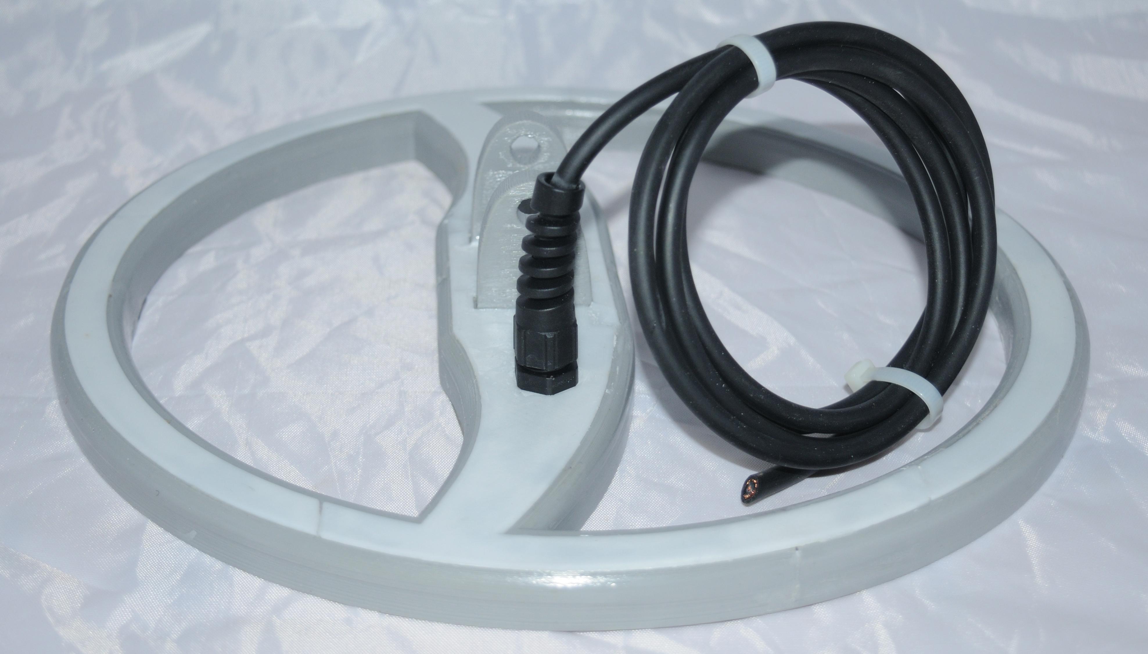

      Pm me your email. i only ask that you do not post the files on thingiverse. make sure all the flat sides are towards you build plate and only use supports for the coil bobbin file also i have modded the model to use the tails that silverdog sell but if you wish to use the one i originally designed i can share those too. photo shows with new tails.

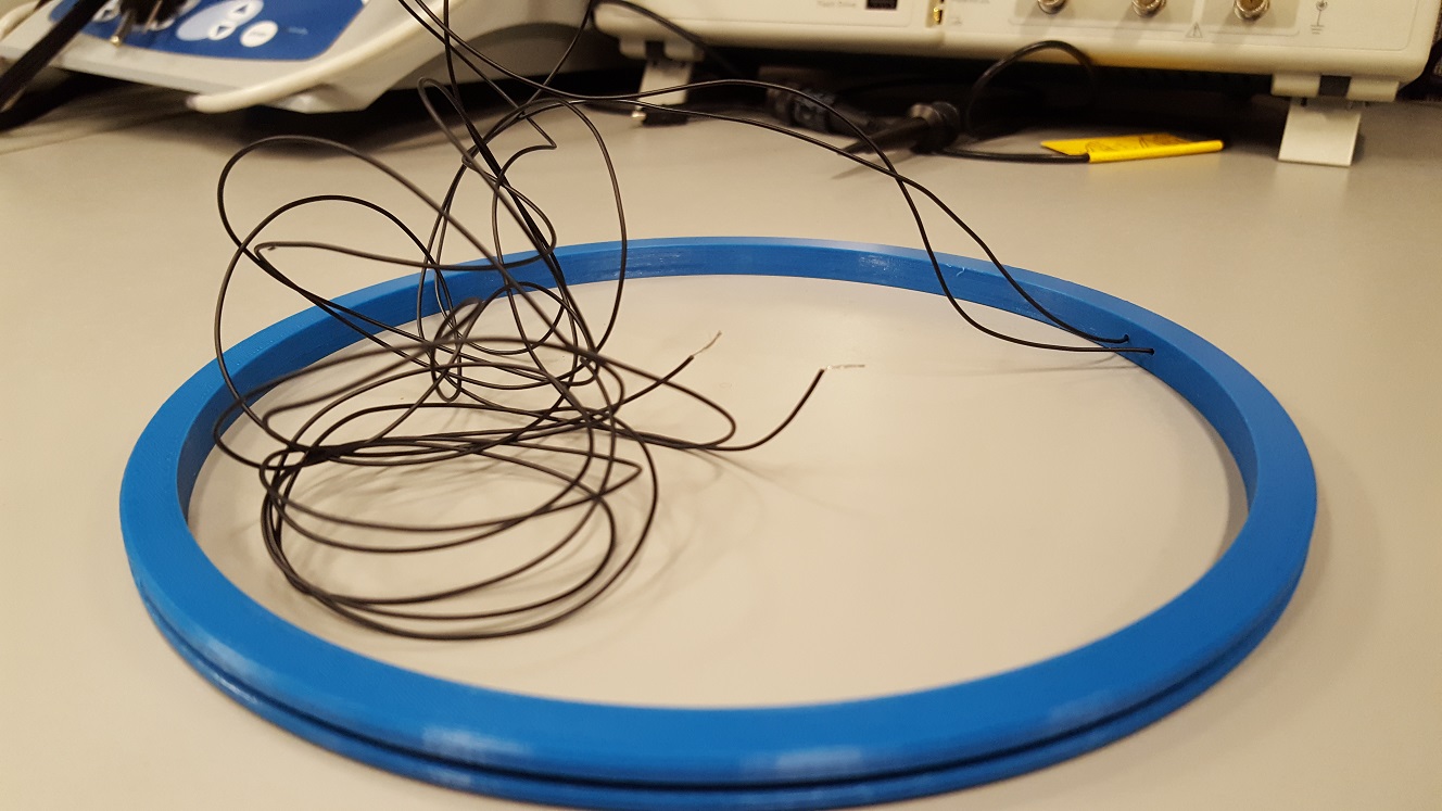

          Here is my take on 3D printed shell and coil form. Make sure you have the flow rate for your printer dialed in as the parts are a close fit (0.5mm total clearance).
          Coil winding form: print bottom as is, flip top so flat is on table, use 0.15mm layer height. Glue top and bottom with CA gap filling glue (let set 4 hours) before winding wire in slot (don't ask how I know) unless you like detangling 20m of wire. Start by drilling two small holes about 1 cm apart through slot (after gluing) so that both wires can exit coil form towards the inside away from slot. The starting wire is a no brainer to thread into one of the holes. For the end wire, after ~28 wraps of 0.4 - 0.6 mm wire you will want to wiggle the eye of a large sewing needle through the second hole and through the coil wraps from the inside so you can pull the outer wire through the wraps and out the hole, very tidy!. So be sure you can get the wire into the eye of the needle and drill holes large enough to pass the eye of the needle.

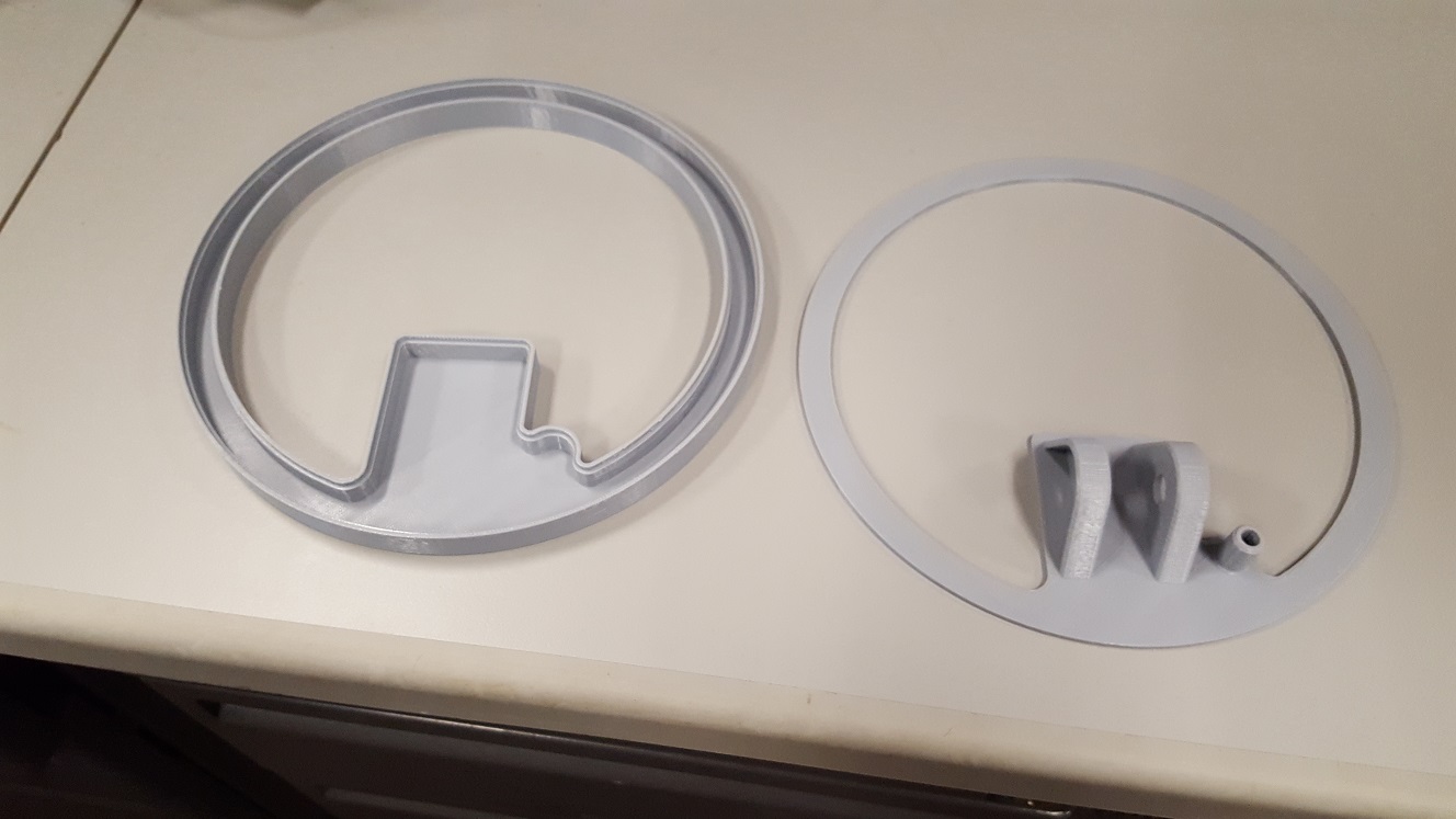

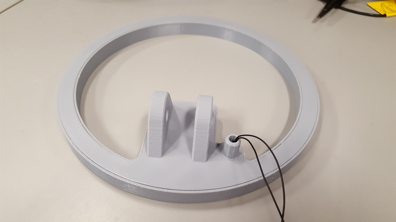

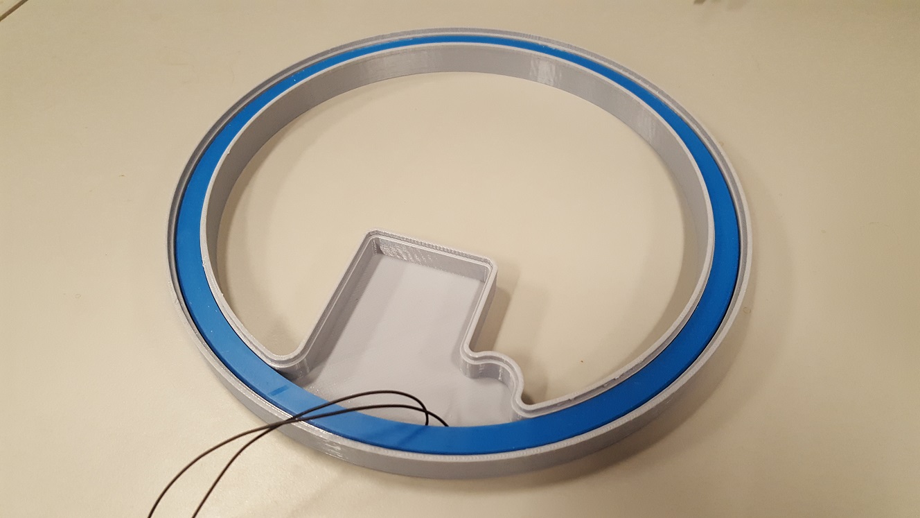

          Search Coil shell: Print both top and bottom at 0.2mm layer height. Install completed coil winding form (tight fit, can glue to bottom shell) with wires exiting near strain relief. I left two meters of wire coming out of form so I don't need to solder on a coax or other cable. Twist wires together, use heat shrink to bind wire every 150mm or so, wrap with spiral wrap and terminate with RCA connector or whatever you want. Glue top plate to bottom shell with CA gap filling glue and use large heat shrink over printed strain relief to join spiral wrap to shell.
          I am using this mono-coil for my MPP Beach Rev. E. The ear spacing is 19 mm to fit the Whites space saving rod kit.
