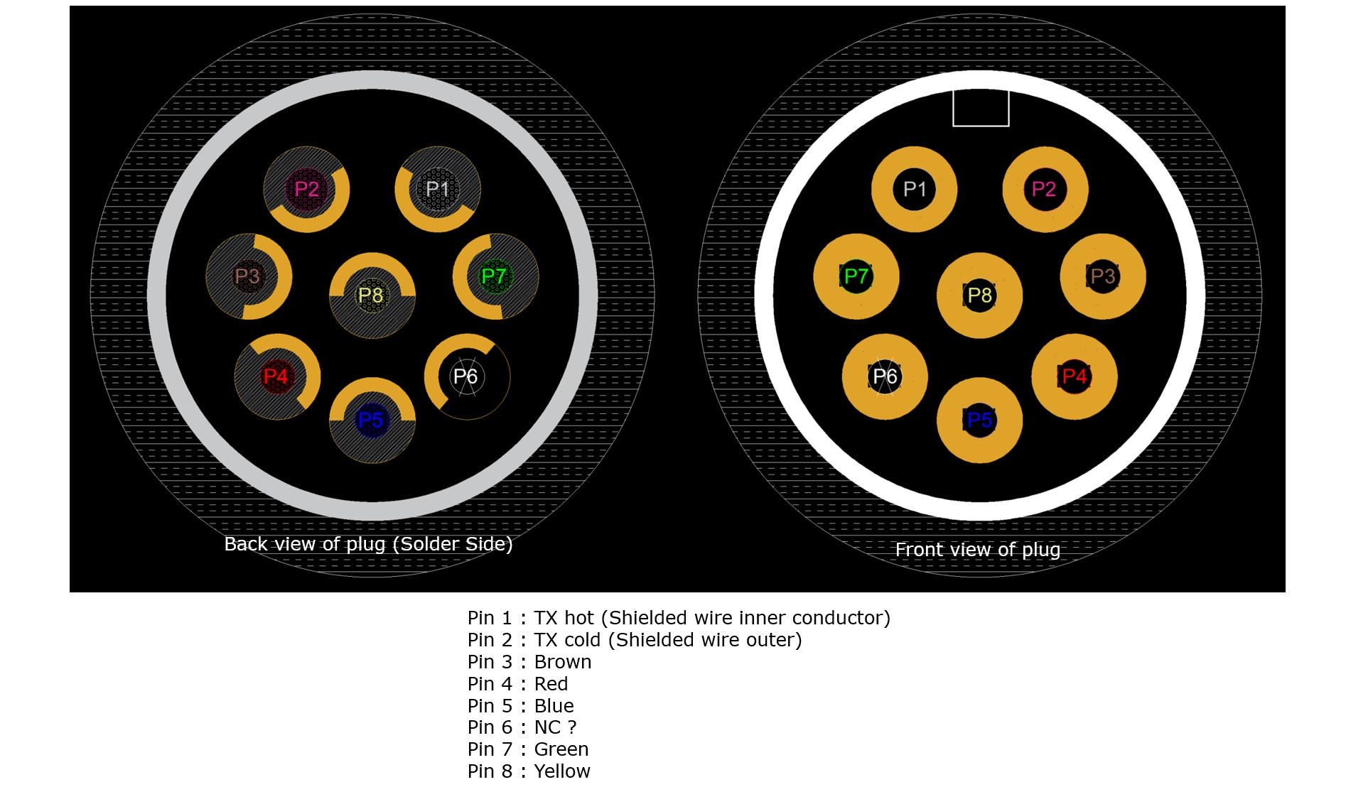

        I re soldered everything to the pinout and it still cycles like trying to start car but it just keeps turning over with the two bars and I can hear a click when it goes from cycle to cycle in the startup

          • #50
            Is this correct from the (Solder or back side of the plug) Click image for larger version

            • #51
              Your diagram looks OK to me.
              Do you have a multimeter? Here's a resistance beep-out for the other pins, which I would expect to match those of your other two coils ( though I only have the stock coil, I've not had my mitts on any others ).
              Pin 7 to Pin 4 : 2000 Ohms
              Pin 7 to Pin 5 : 2000 Ohms
              Pin 3 to Pin 4 : 2000 Ohms
              Pin 3 to Pin 5 : 2000 Ohms
              These 4 are almost certainly caused by the mystery device fitted on both output from the pre-amp ( some protection part, like zeners/transzorbs etc )
              Pin 4 to Pin 5 : 350 Ohms ( this is between the two outputs )
              Pin 7 to Pin 3 : 3600 Ohms ( this is across the power supply, and it's probably the resistor divider network creating the virtual 'half-supply' , or it's those transient protectors things again.)
              I didn't measure Pin 8, from memory it was quite high resistance.
