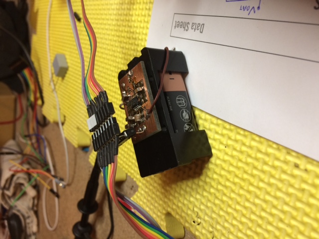

    So, I have made this ugly little thingy running off the 9V battery through a 3.3v regulator, using an etched pcb from another project. The ripple in the Vdc line is now completely gone. There is HF noise present, but it is present even when the MD is turned off.
    I can't tell if this made any different in air tests, so will have to take it out for field testing, it didn't make it worse sure.
    In air tests, generally, filtering the Vdc seems to improve TID recognition - it comes a little sooner and is more consistent from extreme distance. I don't think it improved any air test depth, nothing obvious anyway. But if TID comes stronger, it can't be bad.
    Was it worth the effort, maybe, I enjoy this stuff. Gave me a good deal of information on how parts of this stuff work.

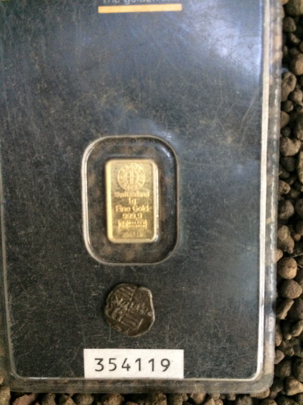

      I tested all 3 coil dimensions 6 ", 11", 12x15 " coils into Equinox .., big 12x15" coil gave the best response in Allmetal..as much less positive ID- I think it is somewhat better reach this coil - stronger received signal.
      The test results confirmed that the appropriate coil size is superior and contributes to the depth of detection.
      Even in heavily mineralized soil ... standard 11 "and large 12x15" coil proved well to detect 1gram of gold brick at 16cm depth in "black-sand" = 4% magnetite ..
      The small 6 "coil was beyond the depth of detection ... and could not detect 1g of gold brick ... at a depth of 16cm ..
        Hi EL NINO. I definitely see some improvement in target recognition after regulating the coil supply. I used soic ADM7150 for 3.3 Vdc. It doesn't feel going deeper, but TID does come more precise and stronger. Not a day and night, but noticeable improvement. I think it gives an extra sensitivity point+, in other words, for example, if I set sensitivity to 20 and can hear audibly a coin under the coil from a measured distance, but no ID, with the dongle, it does get the ID.

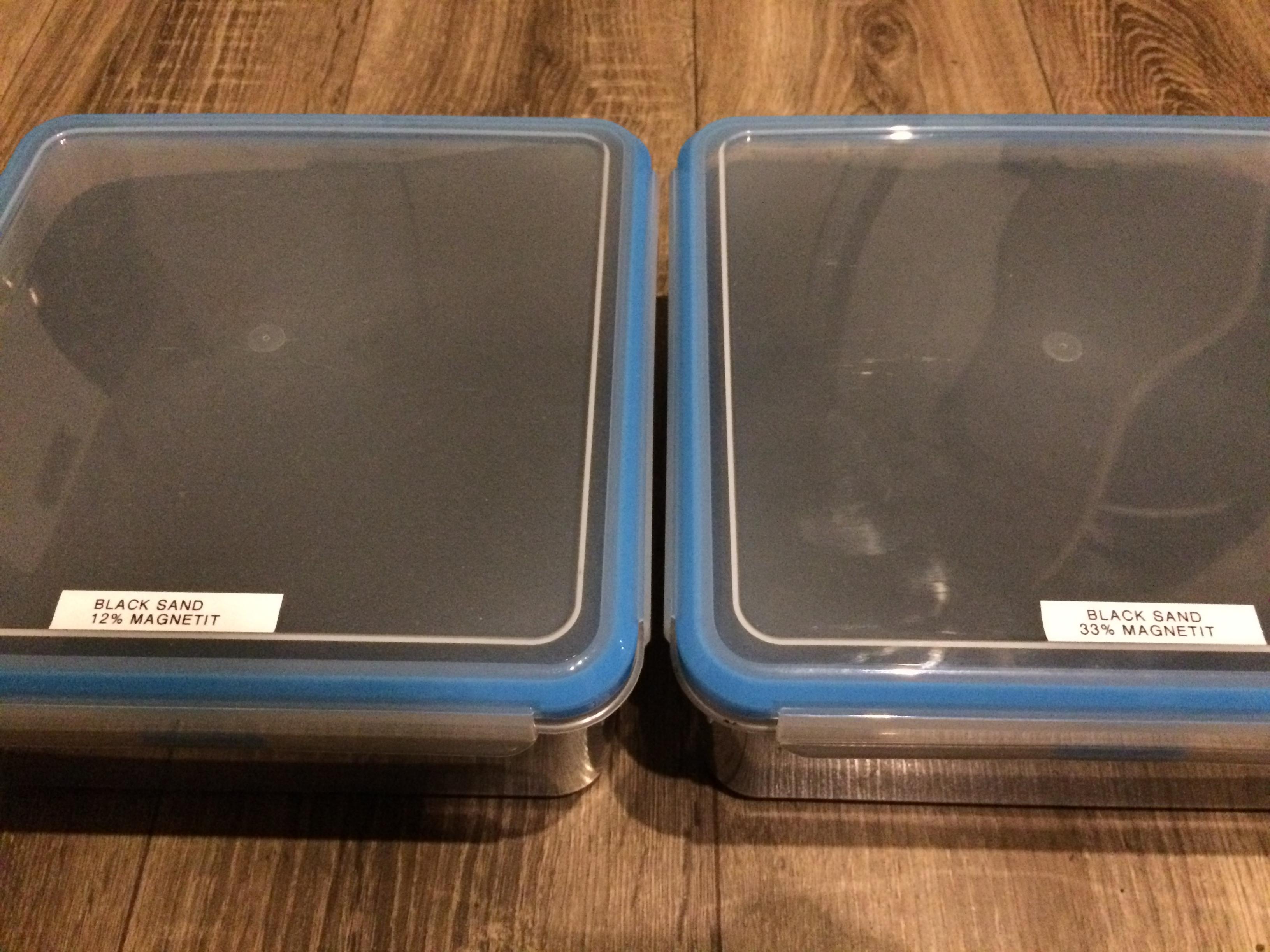

                  I got another good knowledge about Equinox coils .... in the new Black Sand box I mixed 3x more magnetite = 12% magnetite than in the first test box ... Tests are done at 10 cm depth of Black sand ..
                  The first tests showed:
                  1. Test result ... small 6 "coil at multifrequency ... / except Beach programs / no longer manages such mineralization and ... overloading ... secret weapons are here working at 1F at 5kzh, 10khz, 15khz, 20khz. ..by me there is a lower Tx performance so the received signal for the coil is still at an acceptable level ..
                  But don't expect much deep reach ... Detection of tested coin size targets is impossible through 10cm black sand ..
                  2. Surprise ... is of 11 "standard Equinox coil works well ,, and detects even at multi-frequency without problems coin size targets ...- but 12% magnetite mineralization no longer breaks strength and accuracy of multi-IQ ID .. showing ID is more like a classic Vlf detector ... shows higher and high ID numbers ...
                  In previous tests on 4.4% Magnetite mineralization, the strength of Multi-IQ ID is still maintained.

                        WM6 ... thank you ... Just your standard testing process on your 4-Bar Fe3O4 mineralized ceramic grit "Liapor" ... inspired me to further standardized tests for extremely strong Magnetite mineralization - type Black Sand ...
                        Such testing reveals many physical facts in terms of detector and coil techniques, as well as the impact of various detector settings and frequencies on the real range and also the stability of detection under conditions of heavy mineralization.
                        I use 3 "Black Sand" boxes with 4.4%, 12% and 33% Magnetite content to test the detectors in extreme mineralization.

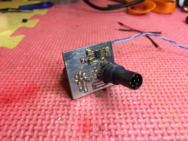

                          Hey guys,
                          I just wanted to update on the latest that I was field testing and working on, as a result I have a very stable operation on max sensitivity and noticeably clearer feedback from the MD on real targets. To what it looks to me, the main improvement lies with the rejection of noise in the power lines, both Gnd and Vdc, which is primarily generated by the TX line cross talk to adjacent lines. The magnitude of the noise is quite severe, around 180mVpp on every wire that is in the coil cable, because they are wrapped around the shield of TXN (TXP is the core) - they don't cancel each other that well really. I think it is just a poor choice of otherwise unshielded unscreened cable, that is susceptible to EMI and noise. I think, ideally, ML should've shielded the twisted TXN and TXP together, similar to CAT6A network cable.
                          While the preamp circuit in the coil appears to be quite immune to PS noise (nor anything can be done to suppress it really due to enclosed design), the very same contaminated Vdc and Gnd lines spread back to control box and seem to have negative impact on the operation. I think ADC in use has a fairly low PSRR if I recall too. I went through a number of circuits, that included even lifting the ground and letting only the differential RX signal feed directly to the control box without ground reference, for some odd reason it elevated EMI sensitivity. The best result I could achieve is through:
                          - having a ground organized in a star arrangement to avoid any loops - addresses the Ground noise going into the control box.
                          - battery powering the Vdc line through a low noise regulation. The Vdc line from the control box is lifted and decoupled to the Ground at the star point. This eliminates the noise feeding back to the control box via Vdc.
                          It looks like this in the end and seems to work very well. Fits right in between the Coil and MD connection. The copper pour on the board is NC.
