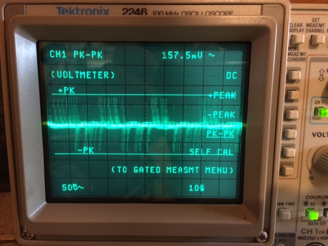

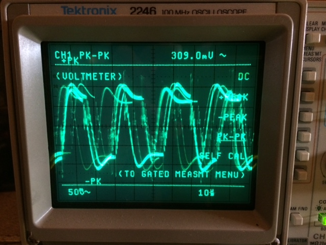

            Need someone's educated opinion. Is there any drawback nulling the RX coil using a small ferrite attached to the RX coil? Here are few screenshots of the scope before and after finding a certain place for the ferrite.
            What I see with air tests, that control box is a lot more stable with TID even significantly away from the coil. Haven't done any real ground tests though. Or is this all just worthless time waste...

            Moving ferrite around to get the lowest Vpp

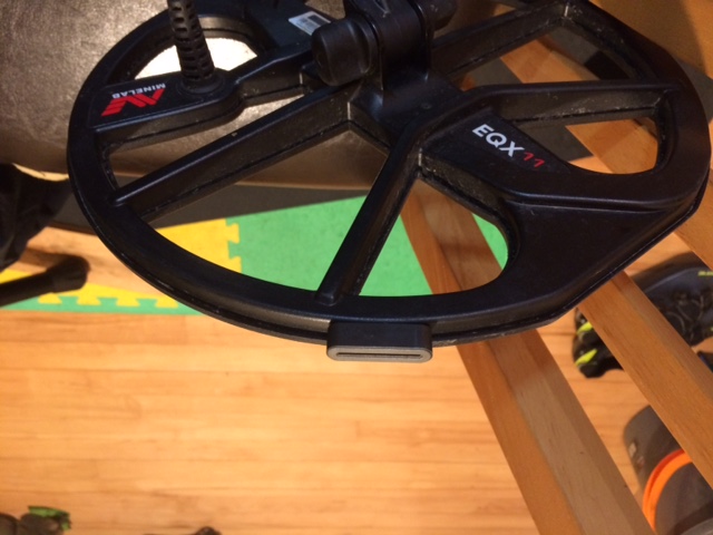

            End result
              I think it's correct to state that ML have nulled the coil correctly/adequately, from the factory. Any "Improvements" you make will have no performance benefits even if they appear to give a lower signal from the coil
              Adding ferrite ( and non-iron objects ) can affect the null, but you have to consider the wide freq range. It's no use improving the 8.2kHz null if the 39 kHz null gets worse, etc. If you have the 800 model, you can choose all the freq range, from 5k to 40k, to try out various nulling techniques. Owners of the 600 model are restricted in this sense.
              And I have to say - that effing big lump of ferrite is not appropriate. The pieces I've used on other coils have been 6 x 6 x 2 mm, it matters where you place it, of course, but in general, the less you use the better. And I should remind you that the coil needs to be kept away from all metal objects when trying this kind of nulling. No point nulling out the legs on your workbench.
              When we eventually do try and make our own coils, this 'bits of metal' nulling technique has some use.
                Thanks Skippy, much appreciated input. I don't call it an improvement, as I don't know how it will perform, but will give it a go. Kinda like this empirical stuff. I have no doubt ML squeezed most if not all from the setup.
                I haven't noticed any drop in distance during air tests, sure that is not on real ground, so time will tell. What I have noticed, that the ID would come sooner as soon as I hear iffy sound, it gets the TID rather quickly and close to real value. Without nulling, TID would jump around until object gets close enough. Gold modes on 800 were quite unusable to me due to background noise, but it is now very faint, that is actually nice. It looks like Gold modes feed audio directly to ears.
                I've tried all frequencies, all of them seem to have dropped significantly, only 40k has the largest Vpp out of all, but it is multiple times smaller than before. As you have suggested, I have tried smaller ferrite pieces I had, but they could not bring Vpp low enough, perhaps it's just the distance from the coil.

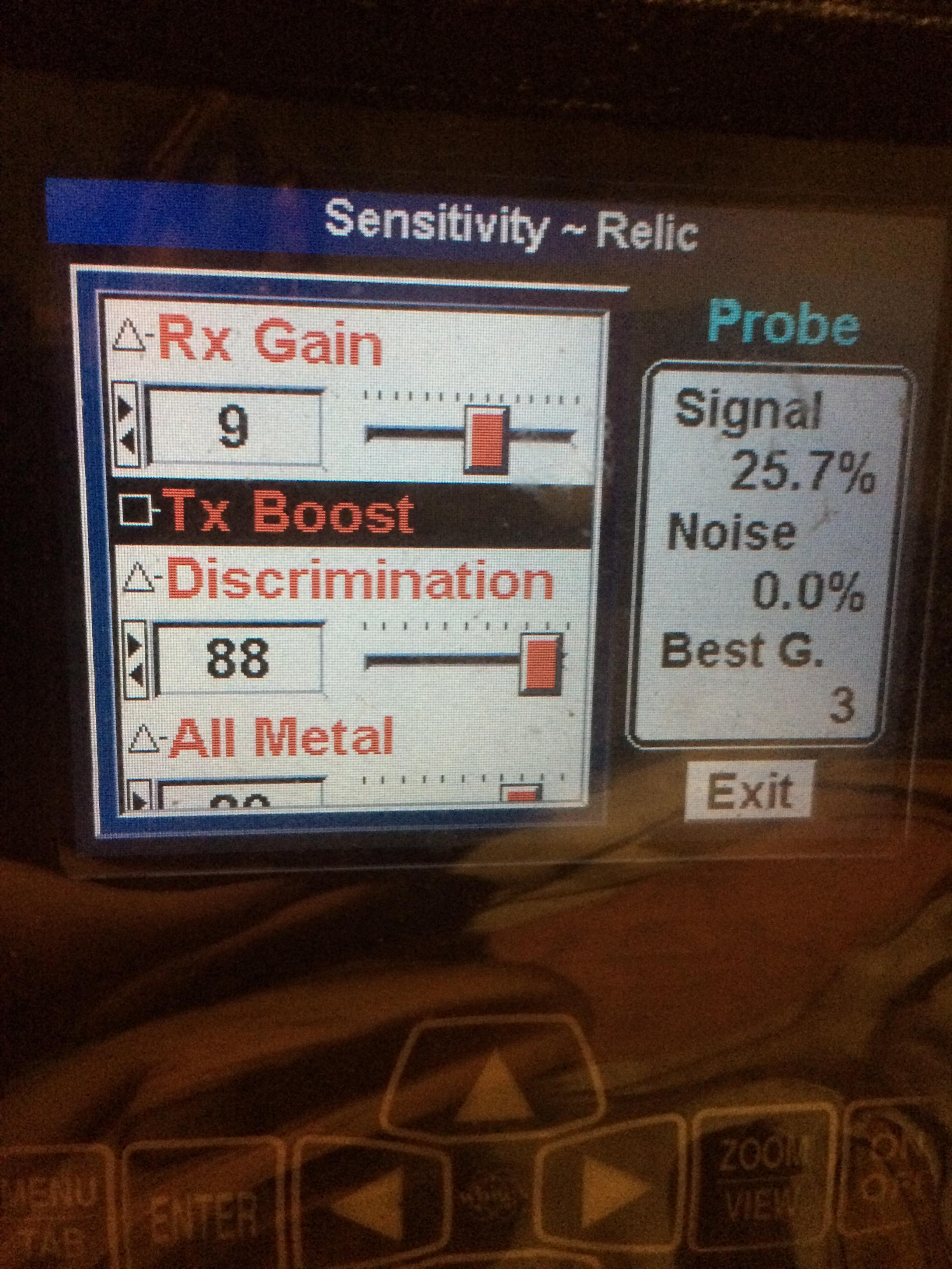

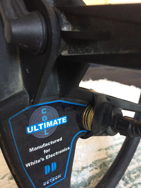

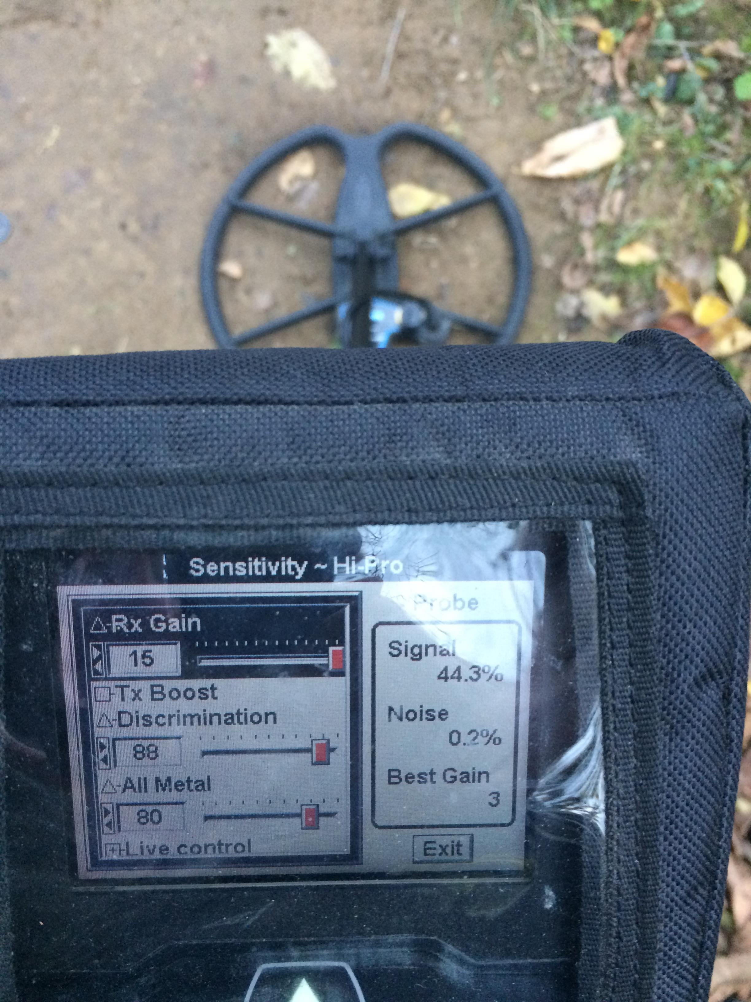

                  My experience with the multi-frequency Spectra V3 and the 13 "ultimate coil balance - with the help of the Signal Probe function - implemented in Spectra - showed that the coil, which is heavily balanced with a few 50 eurocent coins, has not lost sensitivity or reach in field tests. range was quite comparable to another 13 "coil, and better than a 12x10 sef coil ..
Name:	september 6 iphone 5S 2018 007.jpg
                  The initial value of the coil balance in the signal probe was above 65% of the signal at RX gain 9 ...
                  After adjustment, the coil balance has improved by more than 2X. The coil could then work on the maximum Rx Gain 15 ..
Name:	september 5 iphone5S 2018 039_DxO.jpg

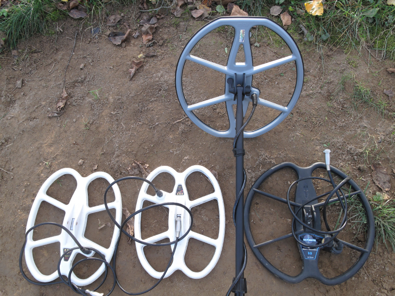

                  Field tests have shown the correct sensitivity even the depth of the 13 "coil ultimate ..

                  I would like to say that the work of balancing the coil at the multi-frequency has its meaning .. ,, and I think it will mainly manifest in more mineralized terrain, or in the separation of rough iron ..- where it is more resistant to overload ,, ...So each coil when working above its signal-before overload .. will identify non-ferrous objects as iron...
                    Thanks EL NINO. Did you notice any improvement in MD operation? I did not really. However if I make nulling twice as bad using same technique, there is a drop in detection depth.

                      Balanced 13 "ultimate works well on the Spectra .. because the Spectra V3's depth and sensitivity depend on the RX gain adjustment level ..- especially in light terrain ..
