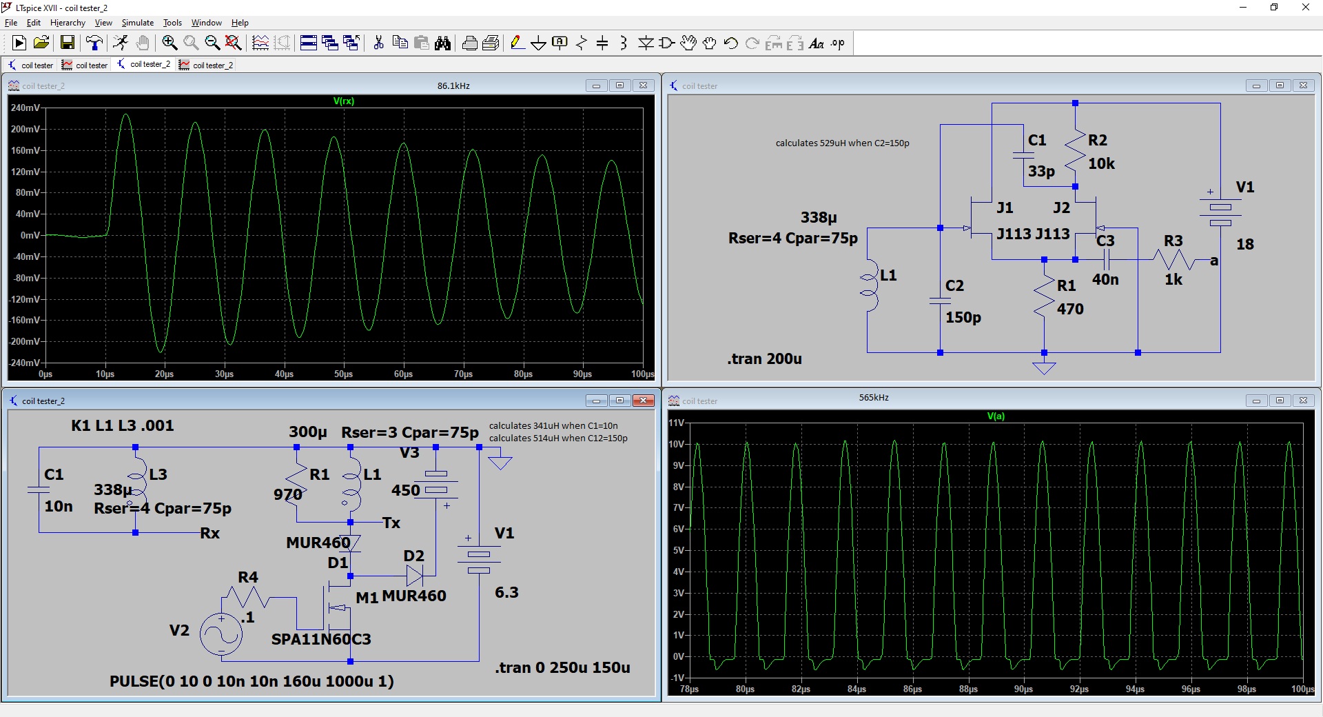

    Tried the circuit in spice. Some error, maybe due to using J113 instead of 2N5245?
      Looks like it's working OK to me. What do you think is wrong?
      It would be easier to interpret if both circuits used the same L C R for the coil, maybe fine tune the parameters so Fres was exactly 1 MHz.

          Tried your suggestion making resonance 1MHz. Right circuit looks good. Coupled circuit has error. Don't know what I did wrong yet. Thanks
          Does anyone now how to display frequency with spice?
          Tried again with 300uH, got same as yesterday. Tried with 338uH(1MHz), wasn't paying attention earlier. Cycles matched at 20us difference so right circuit looked good, off at 10us difference. Left circuit closer to calculation with spice.

            Was using circuit to measure SRF. The circuit appears to have some error with spice. Have you checked the accuracy of your circuit? Maybe the circuit is accurate enough.
              I'm puzzled by your very slow oscillation decay in the left-hand circuit. Surely, with 970 Ohms across the coil, it's heavily damped, and the ringing will be gone in a few cycles ?
                Test coil is the Rx coil on the left. Tx coil excites Rx(test)coil.

                  OK, I assumed L1 in one circuit was also L1 in the other circuit. But it's actually L3. So you're comparing the self-resonant frequency of the RX coil, an making the assumption that the weak coupling between the heavily-damped TX coil and the RX will not affect the damping of the RX .
                    Yes. Can change coupling in spice with little change in resonance if coupling is kept low. Measures closer to calculated than other circuit with spice. Wondering if anyone has measured a standard with either circuit to check accuracy.

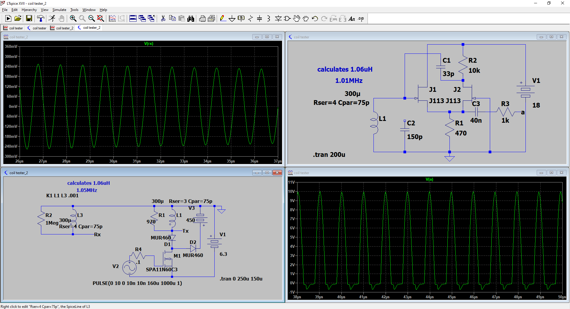

                        Would like to thank Skippy again for suggesting, calculate L and C to be resonant at a frequency that is easy to see if cycle time repeats(50kHz, 200kHz, 1MHz, one digit +0's). Was playing some more and it's a lot easier to see if simulation matches calculation.

                            Trying to understand how the circuit can work. Somewhere I'm missing something. Did another simulation. Coil by it self has a SRF of 1MHz. Both testers measure resonant frequency only. When I calculate inductance, I add a 10n or 100n capacitor in parallel with the coil. A lot higher than coil capacitance. Measure resonance, then calculate inductance using capacitance and resonance. The other tester does the same but uses 150p and resonance to calculate inductance. When I use 150p inductance calculates over 500uH. When I use 10nf, inductance calculates 341uH close to the coil inductance of 338uH. Don't see how to get capacitance or inductance for coil only just knowing resonance. Maybe someone could explain what I'm missing.
