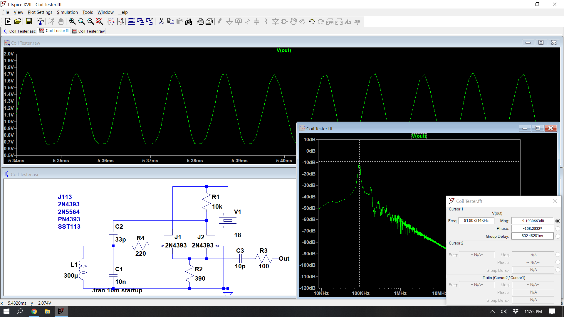

    [LEFT]Does anyone now how to display frequency with spice? No replies
    To measure waveforms frequency I right click on the waveforms title and select 1st and 2nd cursor from the drop down box. I then place the cursors on the successive peaks of waveform.

                        A few tweaks and the circuit will oscillate with 10n in parallel with the coil under test. The 10n allows for fairly accurate coil inductance determination as it minimizes the effect of coil and stray capacitances. I found that the 2N4393 gave the most accurate results as the cdg and cds are a little lower than for the J113. The calculated inductance is 300.5uH versus the actual inductor being 300uH. After you determine the coil inductance, take out the 10n and calculate coil capacitance.
                        The way I measure the frequency in LtSpice (and for that matter most USB oscilloscopes) is with the FFT function. Grab about 10 cycles from the display, select View->FFT, select "Current Zoom Extent",OK. Now you can measure the frequency. On USB oscilloscopes set your horizontal timing to show 10-15 cycles and enable your FFT view.
