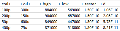

      Tried formula with my circuit since wasn't sure about 113 fets in other circuit.
      Not what I was expecting, worked good.

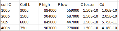

            Tried with oscillator circuit. Bottom row way off, maybe something I did wrong. Could someone could see what they get using oscillator circuit. Worked with my test circuit reply #32.
              It looks like there's about 6 pF of stray capacitance in the circuit, presumably from things like the FET gate ? Maybe a different FET would give different values, eg choose an RF fet for your model, which would I assume to have lower C values.
              The last line is clearly an error. Changing the tuned C from 400pF to 550pF would only drop resonant freq to sqrt (40/55) = 85% approx.
              I wonder about how high the Q of that oscillator is. It looks as thought the jfet gate is forwards conducting for half the oscillation cycle. If it's running at a low Q value, then the oscillation freq will be lower (than a hi-Q oscillator ), which may be why there appears to be stray capacitance. It may not actually be stray capacitance.

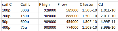

                  Did some lawn work and tried again. Lot better this time. Wasn't awake earlier.

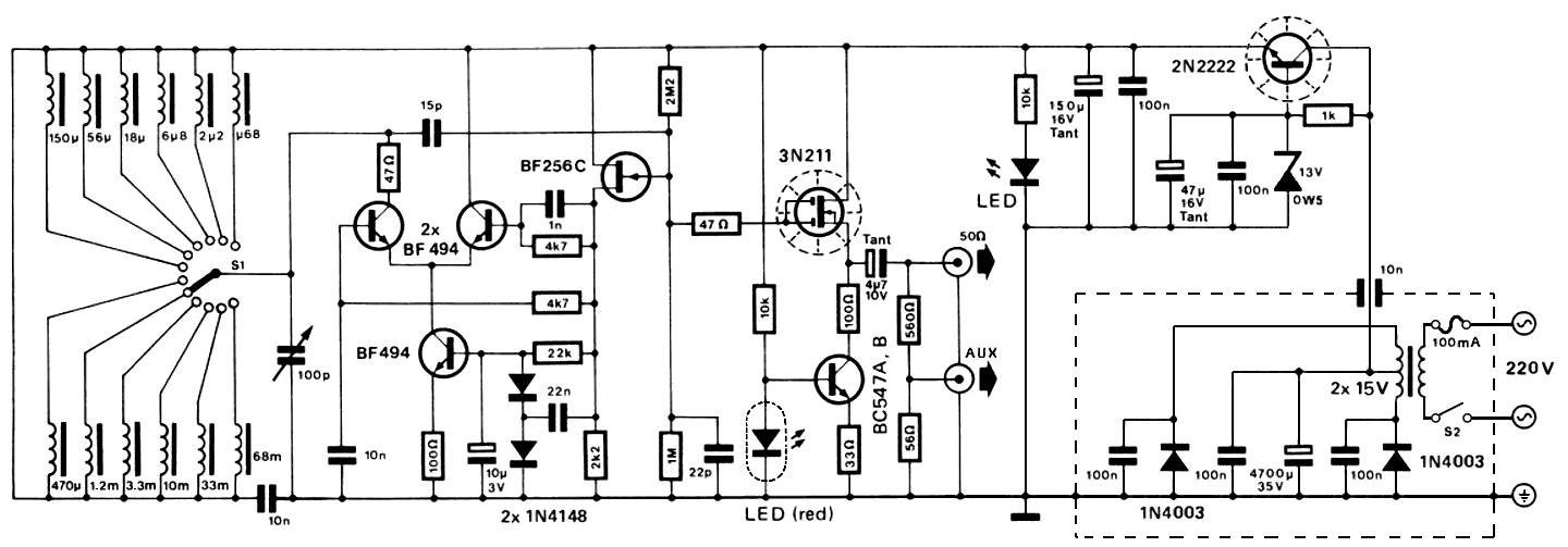

                        I was looking for an RF generator circuit for conducting srf experiments. Came across this one. 3N211 is strange. Range purported to be from 50KHz to 30MHz
                        http://www.qrp.gr/rfgenerator/index.htm

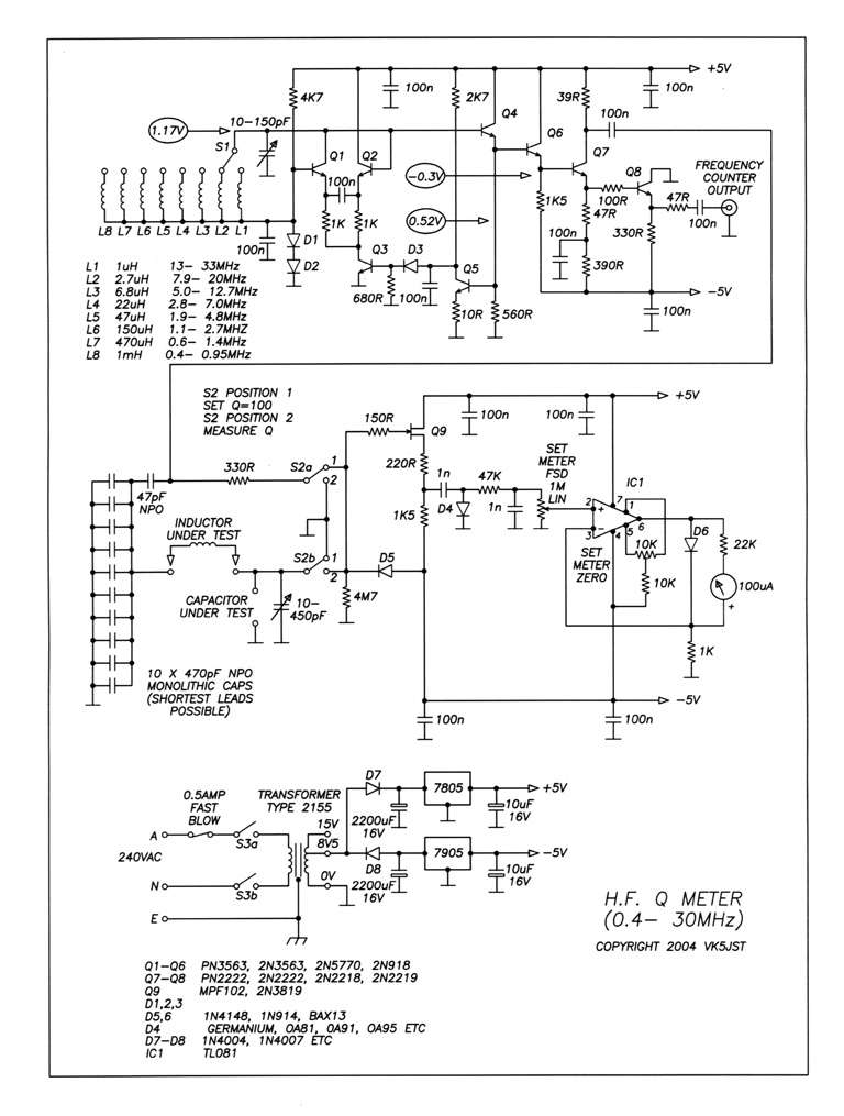

                              I'm exploring alternative methods which do not involve the use of an oscilloscope, but measuring the peak resonance response by means of a detector circuit driving a meter.
                              In the end the goal is to have an accurate and simple means of measuring coil parameters without counting cycles on a ring down waveform off of an old analog scope.
                              A learning experience in old methods.
                              Here is a schematic of a Q meter, useful device which has alternative uses in measuring Inductance and self resonance, notice the metering circuit and how it is coupled, very important to avoid loading as this will adversely affect the results.
