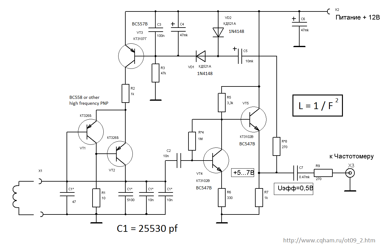

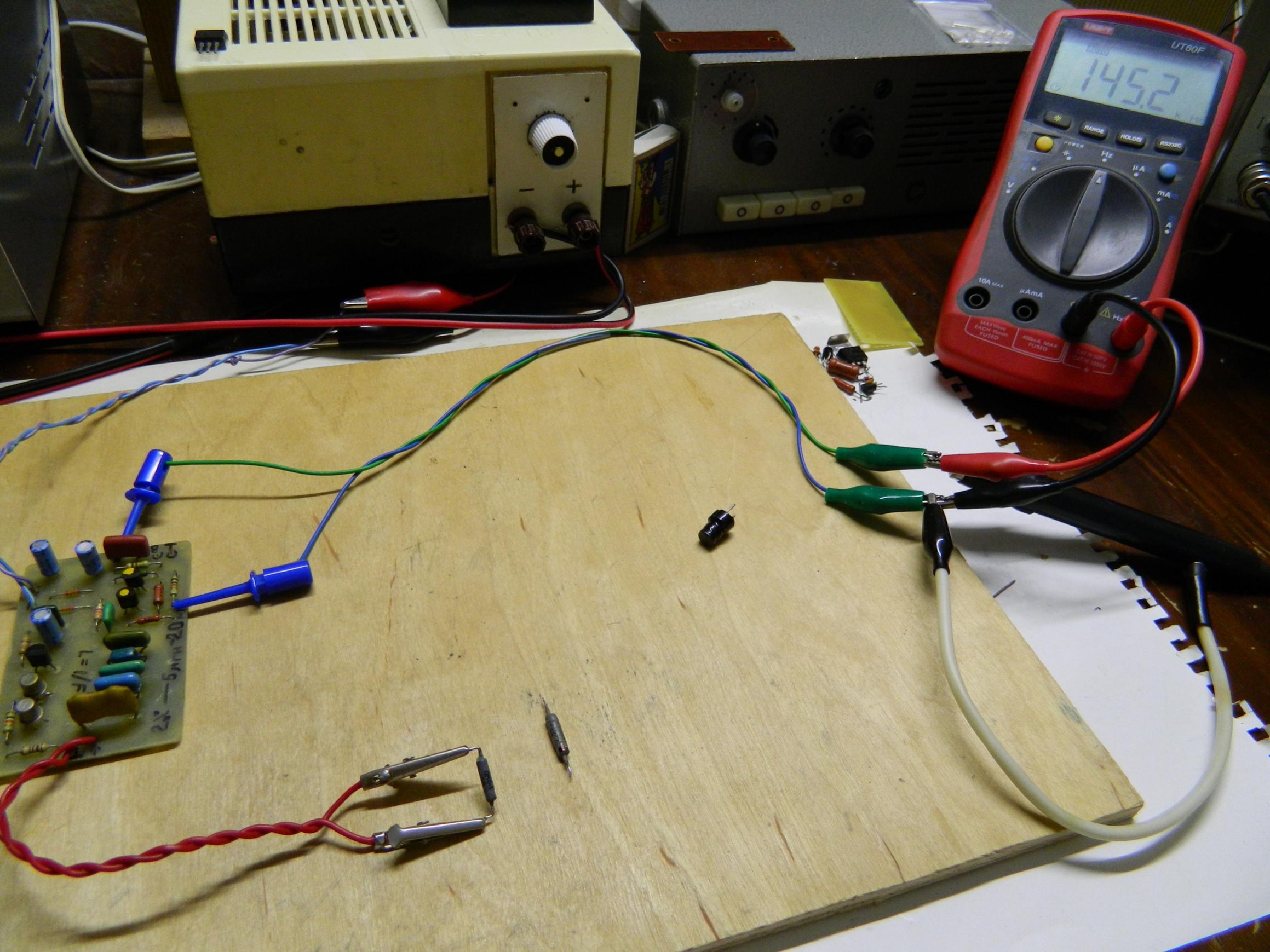

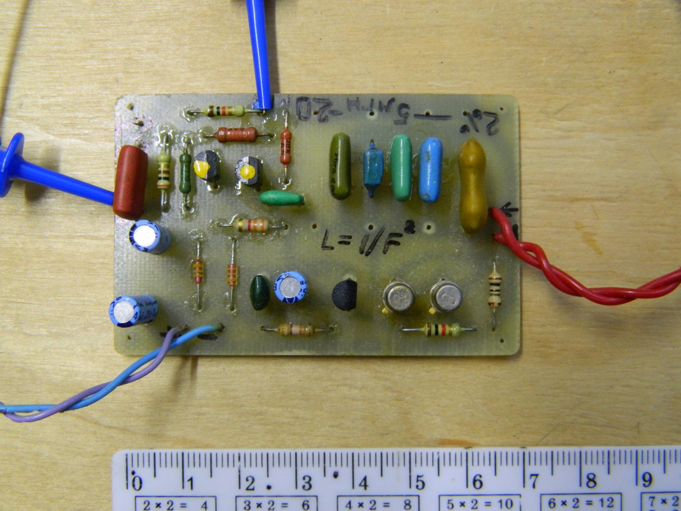

    Here is mine inductor tester with ability to measure SRF, with nice tolerance and stable output waveform.
    Based on well known LC generator circuit, but modified by ukrainian author to nicely measure inductors.
    Frequency meter and calculator needed.
    Here is simple formula: 1/F^2
    Mainly tolerance depends on how precisely C1 capacitance set to 25530 pf, and by frequency meter error.
    I make this one around 8 years ago, for FM discriminator coil tuning (for DBL1018 chip).

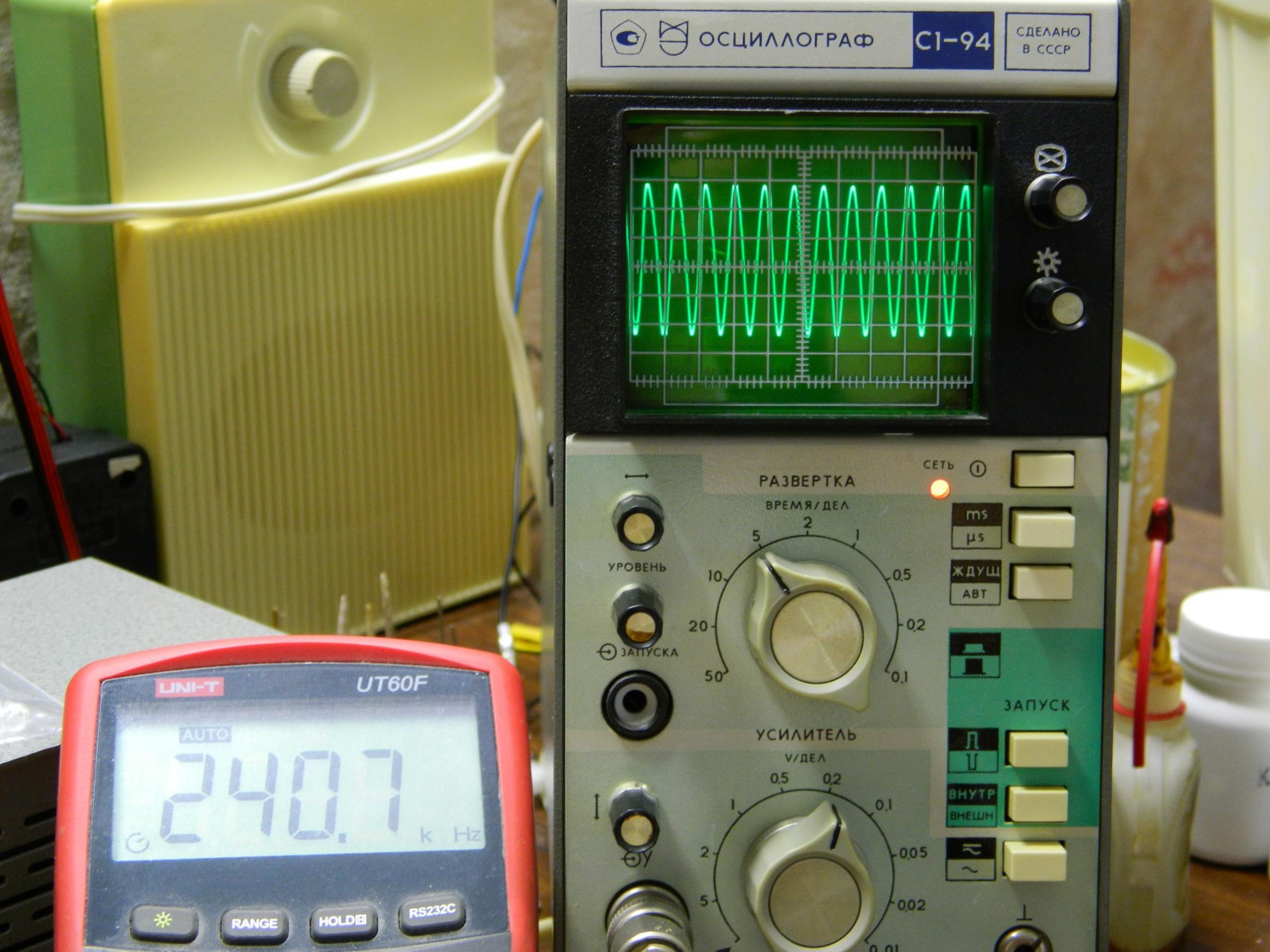

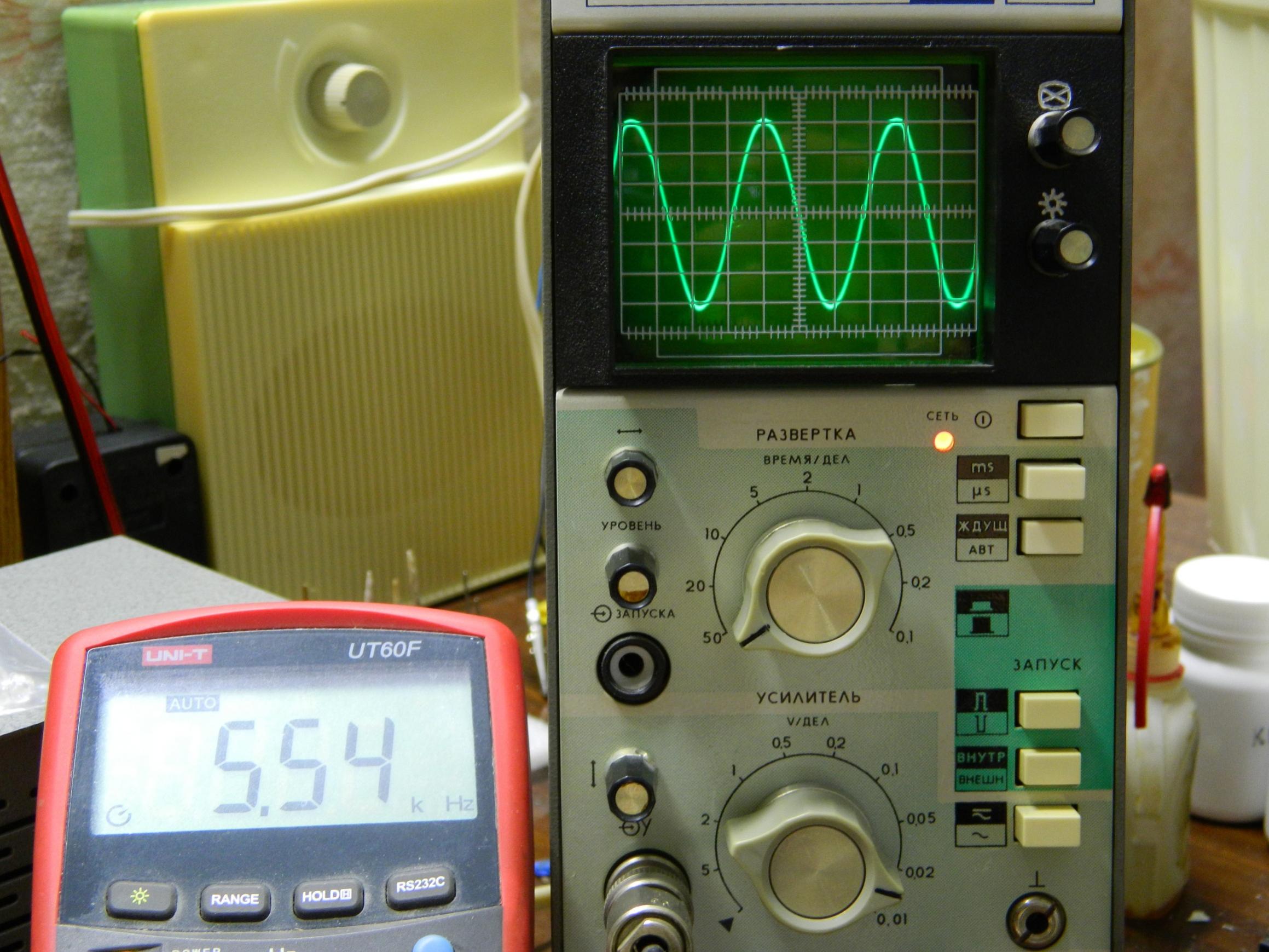

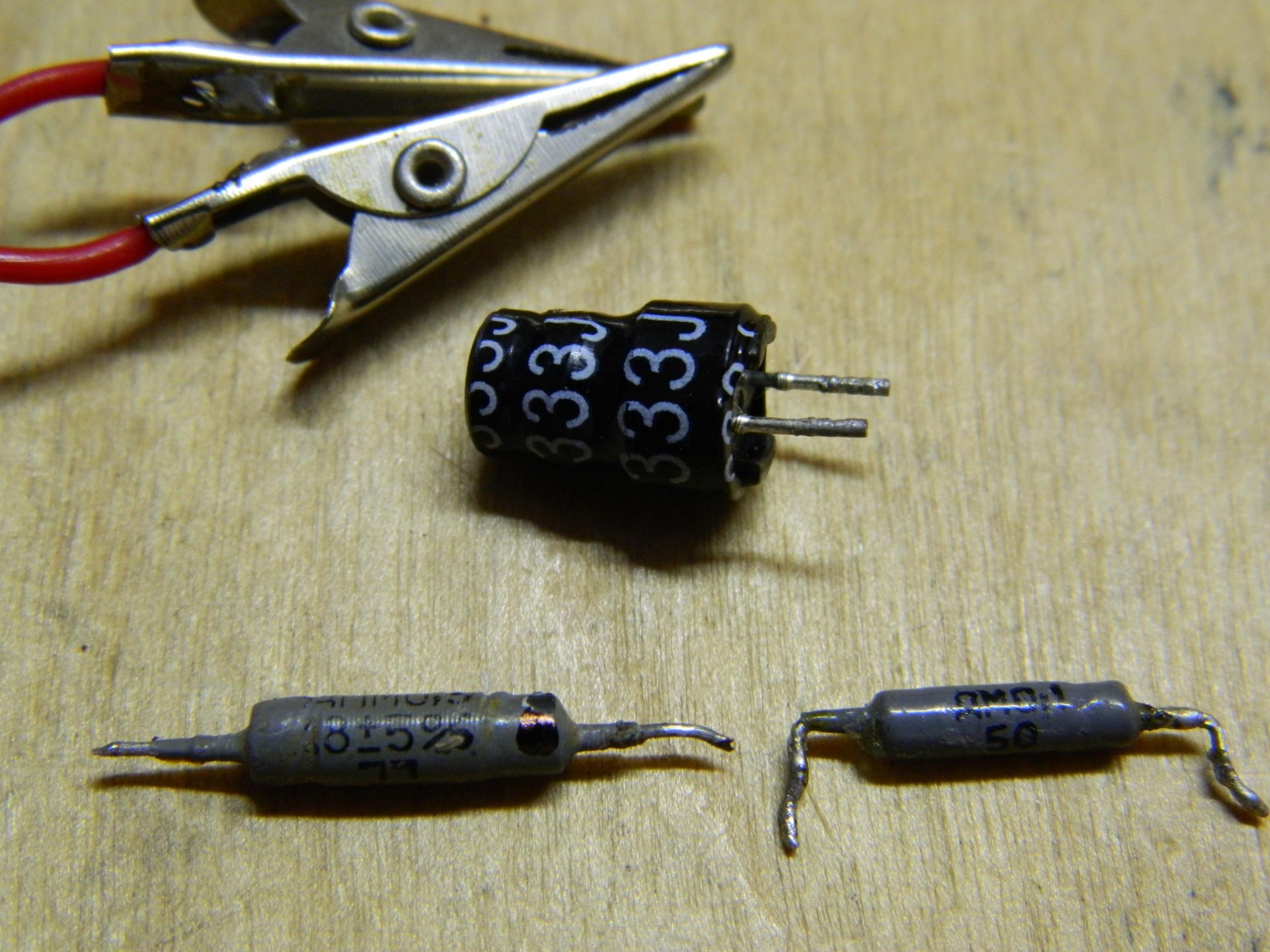

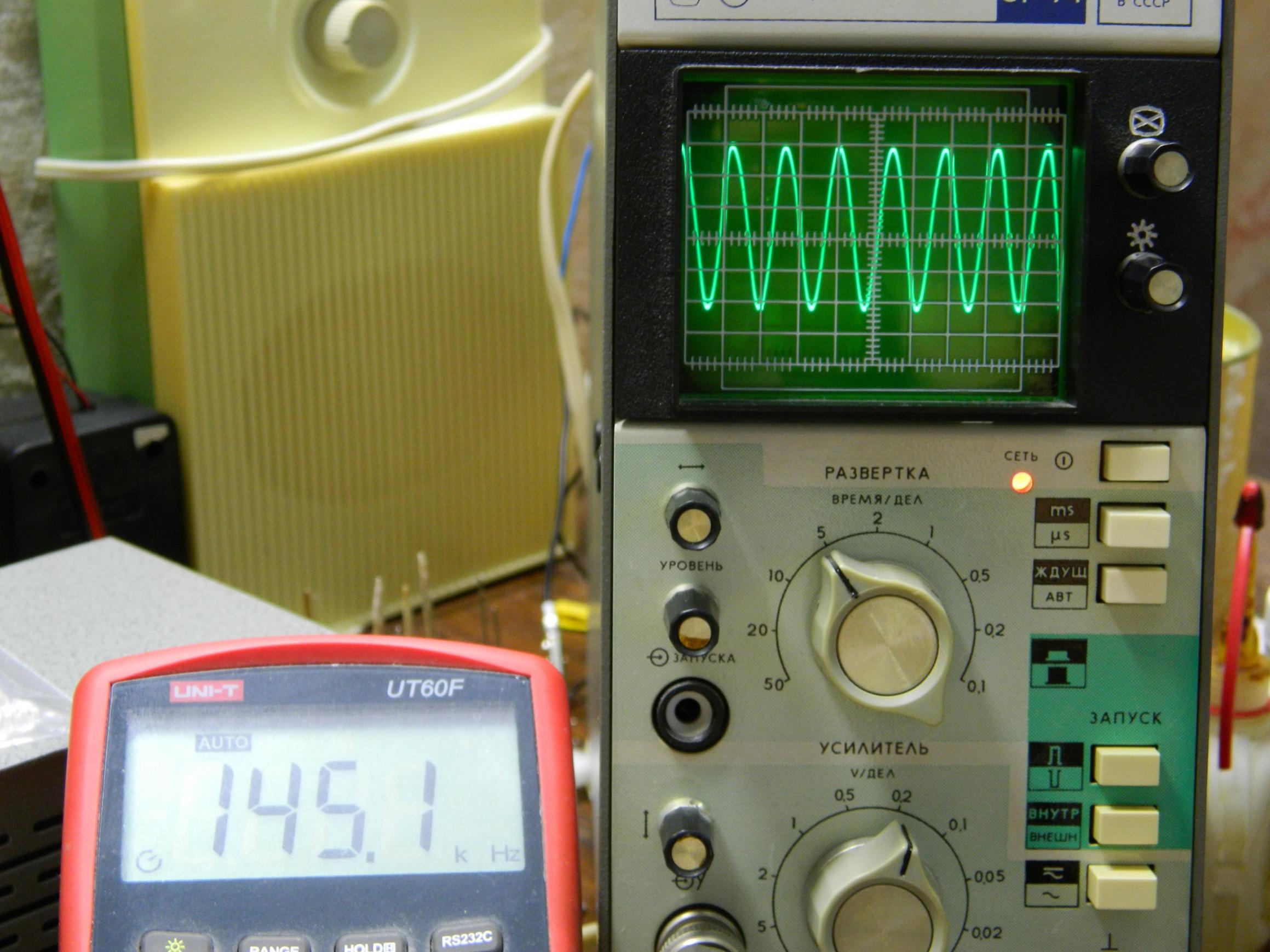

    I tested some inductors and get this result.
    333J -> 32,116 mH -2,7% error
    50 +-?% -> 47,496 uH -5% error
    18 +-5% -> 17,26 uH -4% error
    Original source http://www.cqham.ru/ot09_2.htm

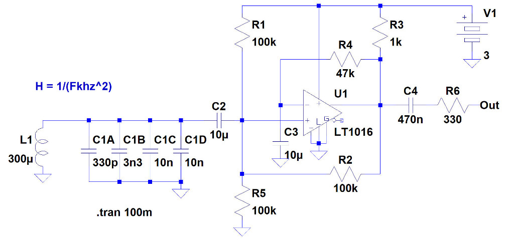

          How about an updated version using the same concept:
Name:	Coil tester.jpg
          • #50
            [ATTACH=CONFIG]50675[/ATTACH]
            • #51
              Yes, it looks more modern, only 3 volts, but i see no amplitude stabilisation and no output buffer.Last one may afect frequency meter reading. Also lt1016 are quite not cheap.
              But in the name of precision lt1016 can do work more better since it all integrated, compensated and have other good things.
