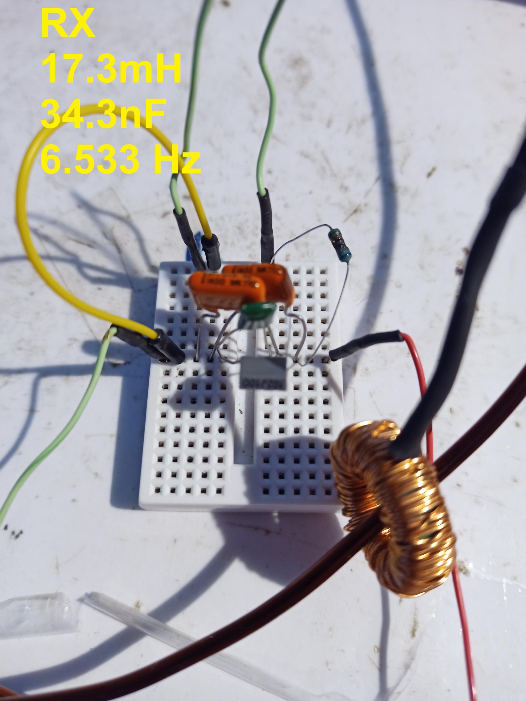

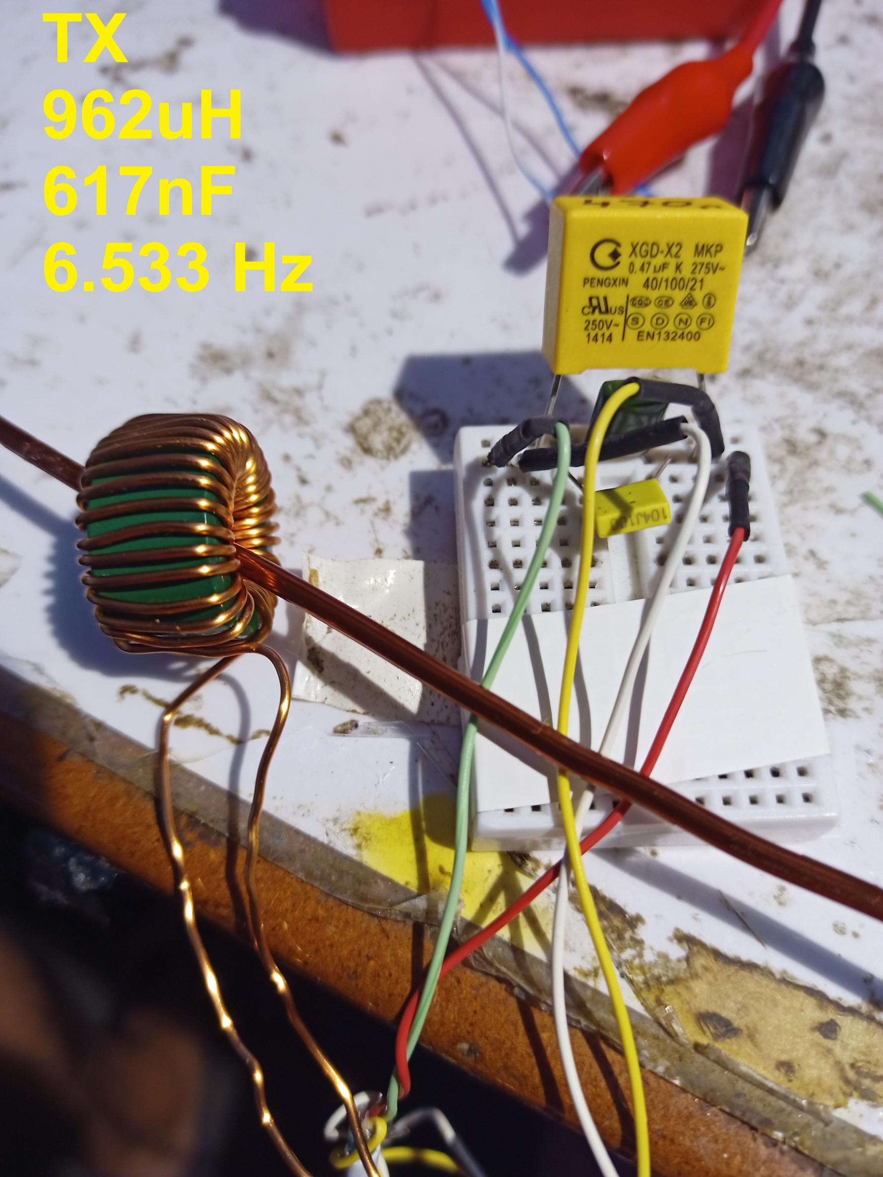

          • COILS :
ID:	415230 Click image for larger version
            • I don't know how valid such tests are.
              It is a thin wire threaded through the toroid, and the inductances are not accurate.
              And on the device there is an aluminum rod that passes through the toroid exactly and at a right angle.
              It is an old truth that without mechanical stability there is no electronic stability either.
              I didn't go into that much detail, I just copied the original. And it works correctly.
              I didn't measure anything with an oscilloscope because there was no need.
              The less I know - the better!
              The quality of the coil is certainly influenced by the regularity of the winding, the right diameter of the wire
              and the right choice of toroid material, because toroids differ drastically in permeability.
              In addition, the way of coupling the coil on the toroid with the antenna is such that in such a cramped workshop the antenna will pick up all possible interference.
              The most difficult part in the production is definitely the antennas as well as the coupling itself. That's where I paid the most attention. Not by measuring,
              but by precisely copying the original, as well as paying special attention to mechanical stability.
              In one part, the antenna is connected directly to the boom, which is certainly not the same as copper wire threaded through the toroid.
              That is a "feed point" and the opposite side that is in direct contact with the boom is the lowest potential,the ground.
              I don't know what to say... improvisations will not produce results.
              While on the opposite side it is completely isolated at the point of passing through the boom.
