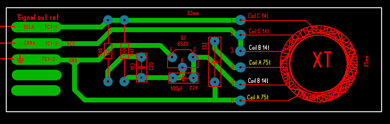

      Look at the photos of the TX board - see where the thick wires go. You have the power supply conected directly to a short circuit, ffs. And you have it reversed. It's a PNP bipolar transistor, the emitter goes to the +ve supply, the collector to the -ve supply.

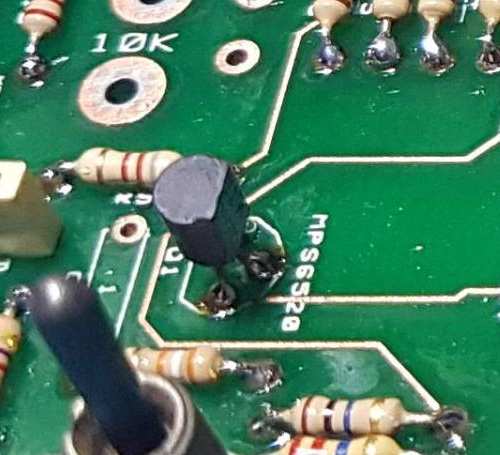

      Are there any other '6520' transistors on the main board ? That way you can find out if it's pnp or npn. Edit, yes there is, it's an MPS6520, which is npn, that's one problem solved.

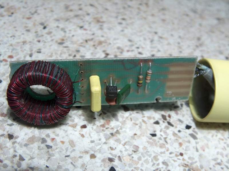

      Got to say, the two photos of the TX board show completely different wiring of the toroid. Confusing.
      If you zoom a bit into this photo; you'll clearly see it is MPSA6520, NPN transistor.
      I don't see any short circuit!??

        Actually... the way it is on last photo I posted; fat wire, red one, 75 turns, goes between Vcc and GND and in that case you are right, there is short circut (disregarding small 75 turns resistance).
        But I posted this photo now, second ago, previously I think i did nothing wrong on drafts??
        Damn this is confusing!
        One thing is for sure; it is MPSA6520... unless somebody purposelly placed it there to make such photo!
          Thing is; I don't have TX pcb. I only have dozen photos downloaded from various topics in time.
          So... sane logic confronts with what we see on last photo that i posted.
          I am confused...
          For the RX pcb I can asure you it is alright, because i checked it.

              MPS6520 from your main board photo: attached.
              It's curious that only one winding is 'thick'. Obviously a feedback winding that coupled to the base of the transistor would only need to be thin.. but the second thin one?
                After you warned me that something was wrong there; I reviewed all the photos I have and really something is not right there !?
                I guess some of the pictures were taken by someone who was messing around on a TX pcb and tying the wires wrong.
                Either by accident ... or deliberately fooling others who watching. There are all kinds of them... the people.
                So we don't need to take those photo for granted.
                That is why I trust only and exclusively in my work, of this kind. Because I saw a lot of pranks of various pranksters.
                That's why I did everything from the beginning on the main pcb. And that's why it is working right now. And I will solve this too.

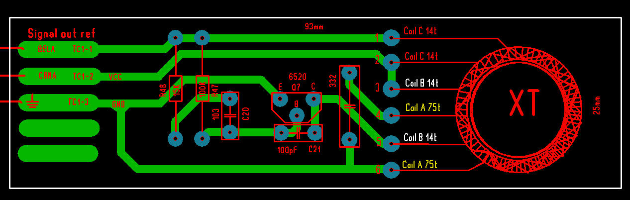

                  This is the only proper version, I think:
                  CBE pads are correct on pcb.
                  MPSA6520 is having EBC pinout and that's why it must be rotated, which is not on a drawing.
                  Not a problem as long as it not confusing the observer.
                  But here it is the way it should be:
                  On a photos however, MPSA is turned alright, rotated. That's the correct part.
                  Only the wires on the photos are soldered wrong.

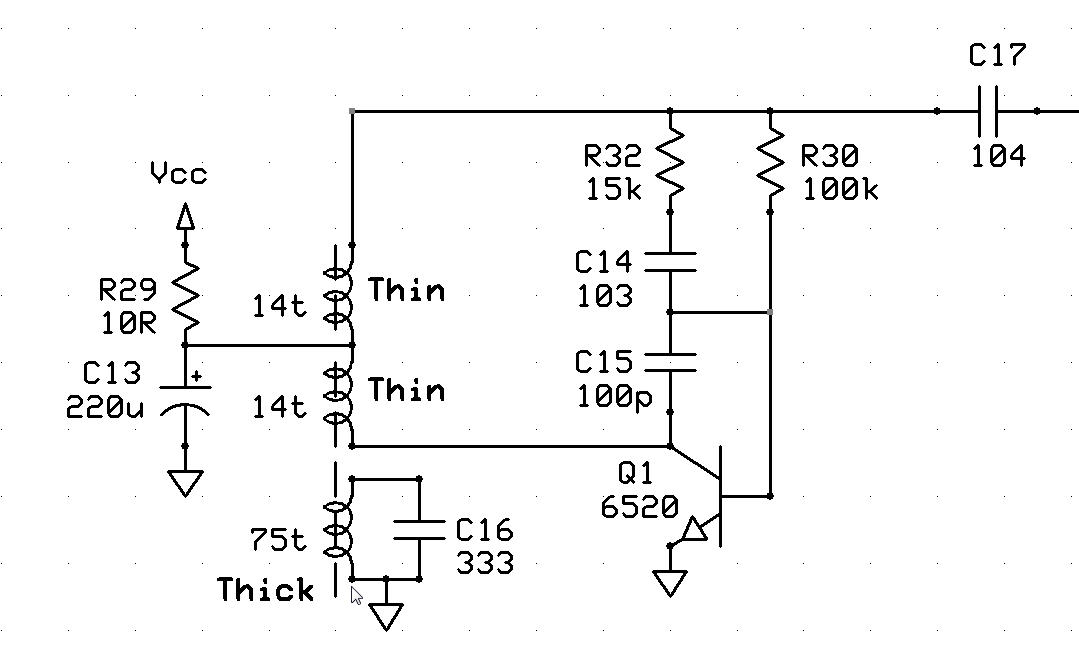

                    If my version is correct; than schematic will look like this:
                    I am still drawing it, not finished yet.
                      It might be wise to add two pcb pads in parallel with the 33nF TX tuning capacitor, so a little more capacitance can be added, like on the RX board. Sure, small caps can always be tacked on the underside of the board.
                      Use one of the spare edge fingers as a second 0 Volts ground. And add a 100nF decoupling cap across the power rail. Maybe a tantalum / electrolytic cap too.
                      I'm unsure what effect the single short-circuited turn of the main TX coil will have on tuning. It's going to add damping, but probably won't change the frequency much.

                        Yes, a very interesting way of inductive coupling! And it makes sense, if you look at it as an ordinary transformer!
                        You have a bifilar center tapped ciruit that is "drive" and act as "primary", and you have an LC tank with thick wire and many more turns, acting as secondary.
                        Also preciselly tuned to RX with same thick wire and same number of turns.
                        An aluminum antenna passes through the toroid, acting as an elongated core, a special shape that "radiates" just like any antenna.
                        A coil with a thick wire, "secondary", in this case amplifies both the voltage and the current at a given frequency, because it has a larger number of turns,
                        it acts as a transformer that raises the voltage ...

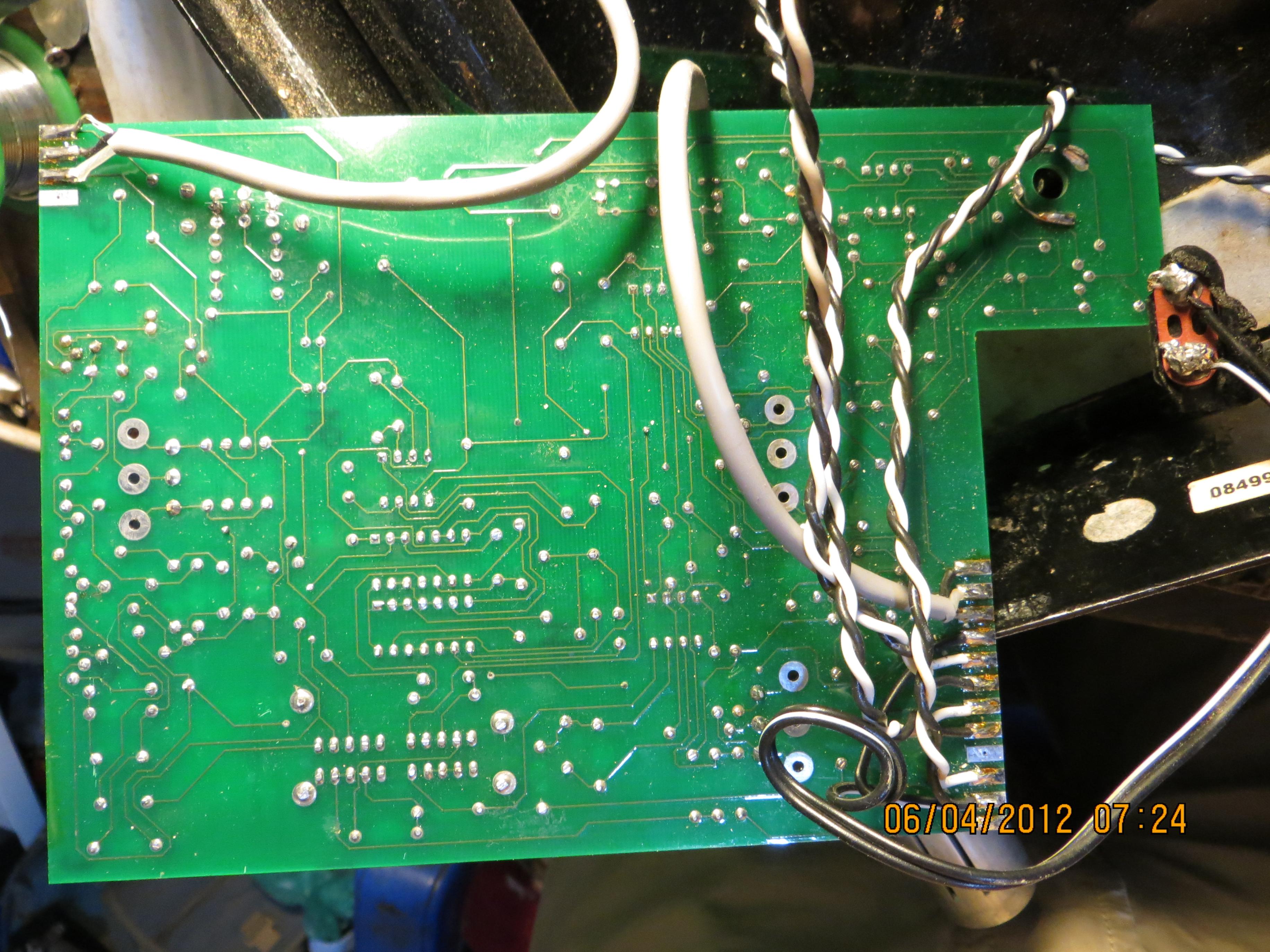

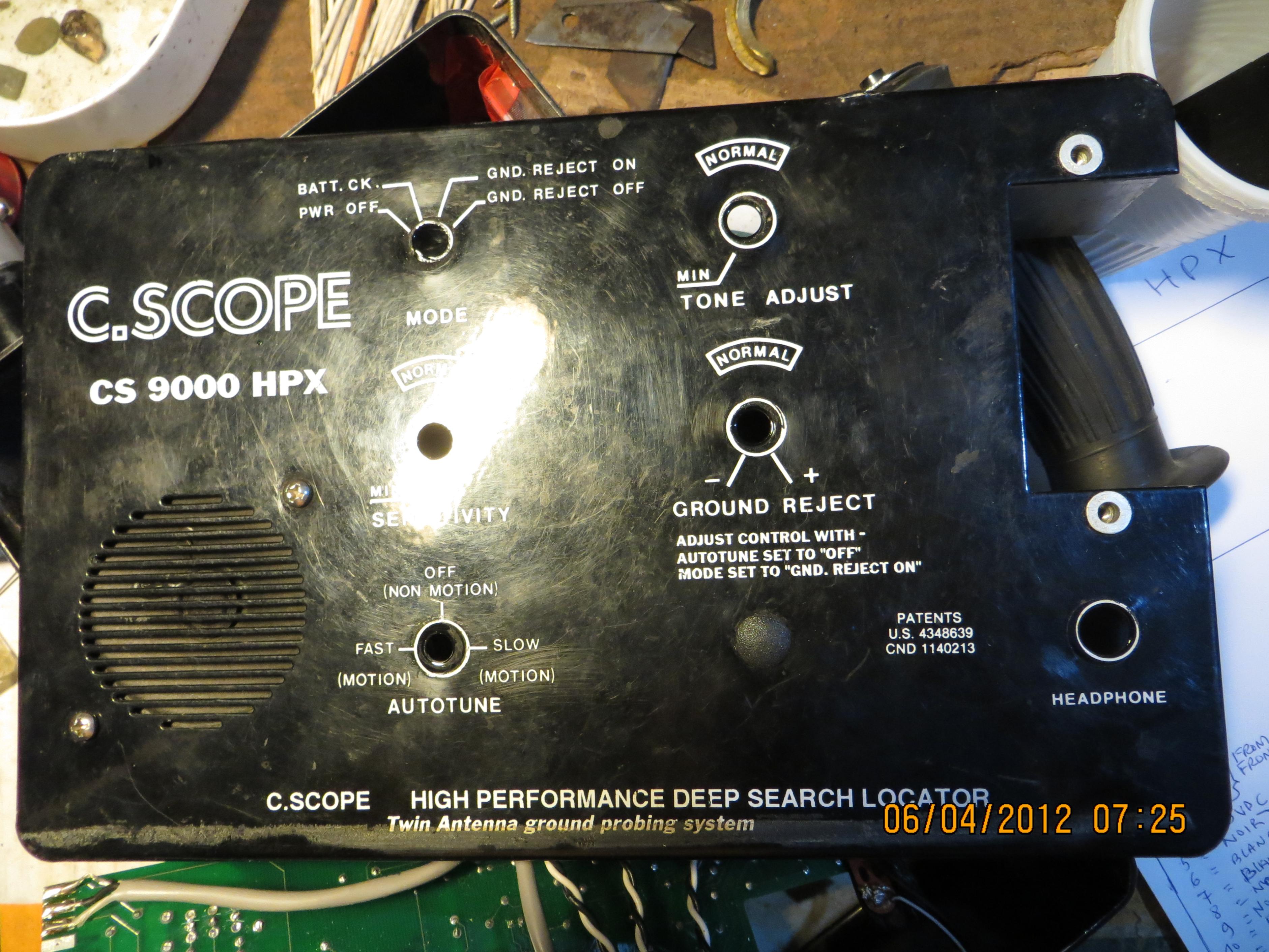

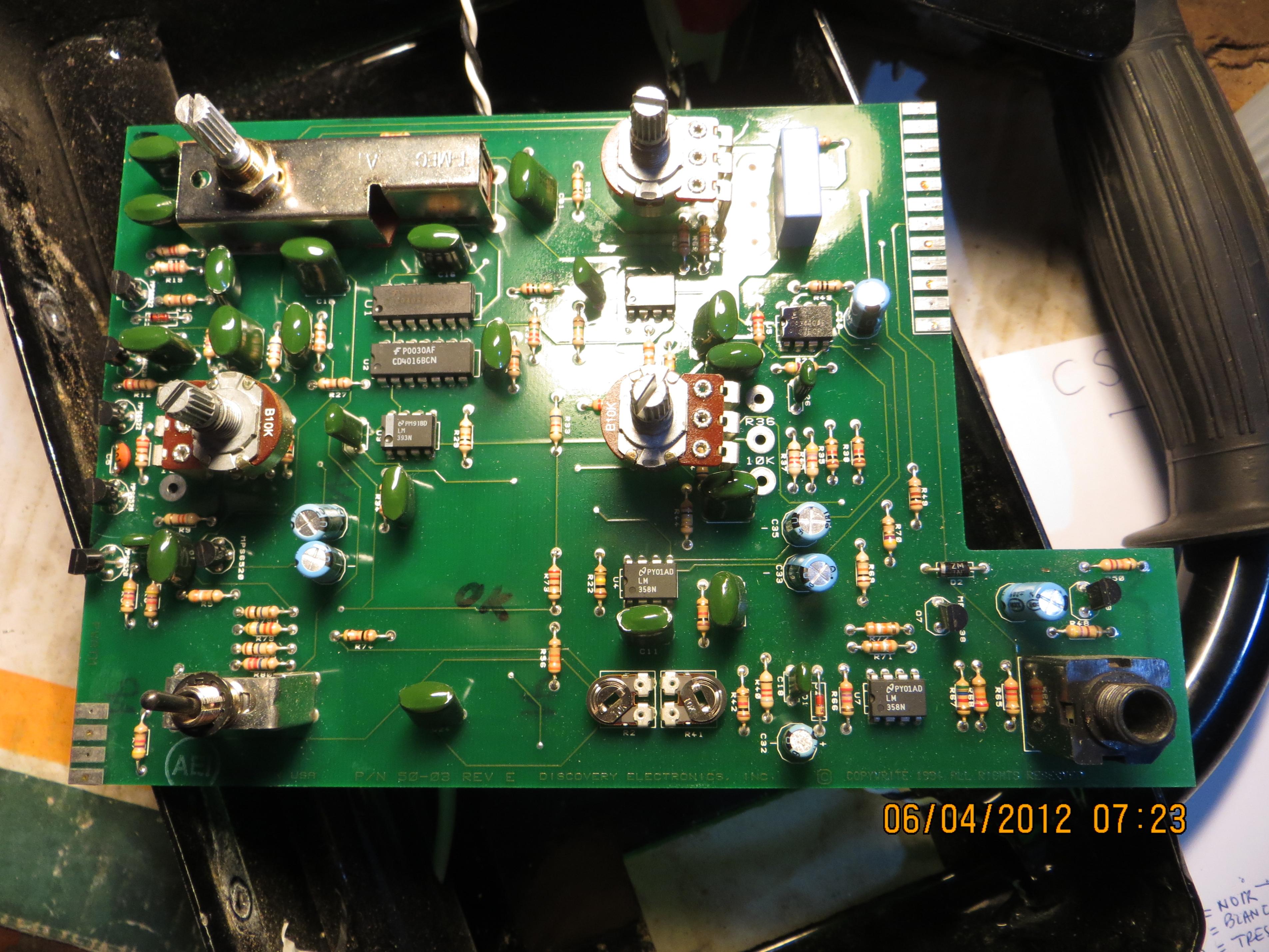

                                hello , pics of C-SCOPE TF9000 HPX , same board but mine is populated and yours not, why ?
ID:	363064Click image for larger version
ID:	363065Click image for larger version
