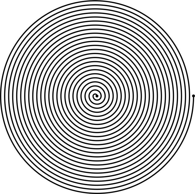

                In few minutes was created by Corel Draw program:
                20 cm diam, 24 turns, 1 mm, spaced 3 mm, aleatory, only for to try the program.
                You can print with laser printer in good quality magazine paper and transfer with hot iron.
                Here the original 200 dpi:
                http://www.mytempdir.com/1092611
                • #83
                  I'm dizzy...
                  • #84
                    Yes, look for hipnotism!
                    In used magazine paper or directly in virgin paper for this purpose, this is for magazine, print in laser printer your design. Look the process and the high quality PCB you can make! (but is in Spanish):
                    http://www.xbot.es/webs/robotika/prensador.htm
                    • #85
                      I'm dizzy...
                      Careful .... watch out for these LRL guys.
                      Your eyelids are getting heavy .... you're starting to feel vvveeerrryyy sleepy....
