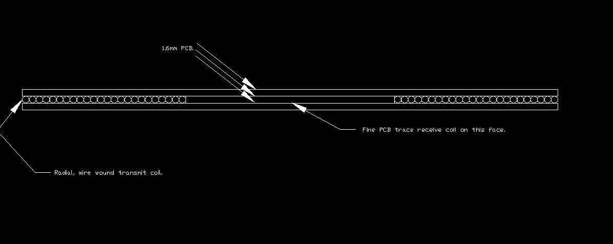

                • #98
                  Hybrid coil
                  Hi bbsailor,
                  Will do that chart and post the results here, obviously I am after the highest inductance with lowest capacitance.
                  Attached is an idea I had for a hybrid coil. Radial wirewound for transmit and a thin sparse spiral for the receive in the middle.
                  I can hear you thinking....why not leave space in the middle of the rx coil pcb for a pre-amp !
                  bugwhiskers
                  • #99
                    Good idea, if you put the PCB trace on the inside, then the thickness of the PCB serves as the spacer for the shield. I recommend that you measure your coils with shielding included. Without a shield you can not get much sensitivity.
                    Tinkerer

                        • Coke can test
                          Hi bbsailor,
                          It would seem the best combination for a hybrid coil would be a Helical coil (best inductance/capacitance ratio) coupled with a spiral PCB coil in the middle (best for pinpointing). I hope to make one within the next week.
                          As for the flexible plastic, I am going to find an offcut of 12" OD PVC pipe to be used as the former for winding only (later potted with the PCB coil in epoxy.
                          Today I did the coke can test (aluminium) and my PIMD with the 300mm*150mm PCB coil detects at just over 500mm. A 2 Euro coin is picked up at just over 250mm.
                          bugwhiskers
