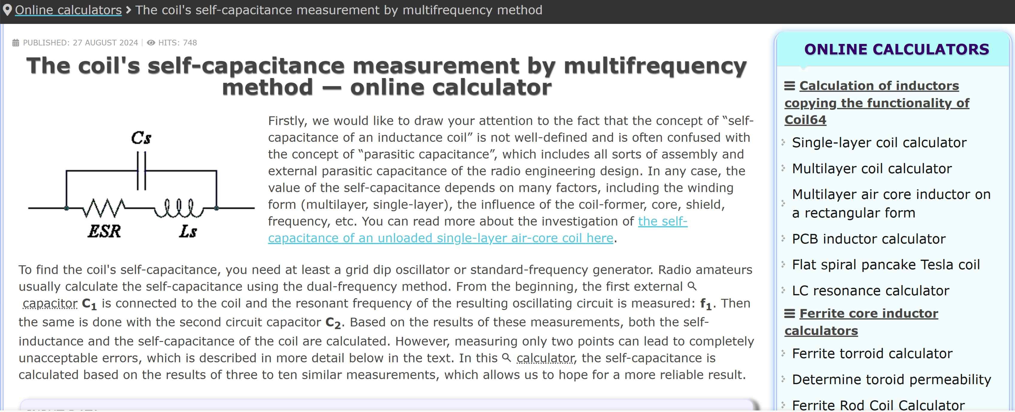

            Best selection of inductor calculators
              Originally posted by Eddy71 View Post
              https://coil32.net/online-calculators.html
              There is also a fantastic coil calculator available for download on the same website suggested by Eddy71.
                  Thank you Eddy71, excellent link.
