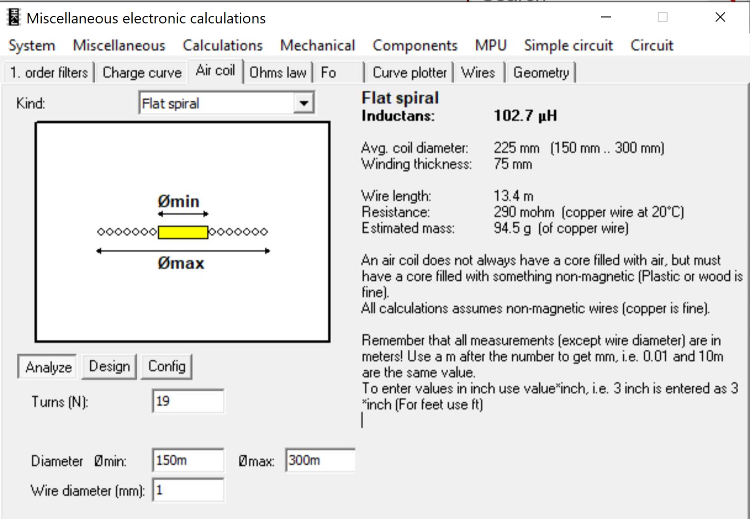

                    How do you build the flat TX coil with 300uH inductance, 0.4 Ohm and 300mm outer diameter?
                    • #55
                      And what is the difficulty? If the diameter of the coil TX is 300mm, then the length of the coil is 940 mm. In order to get 300 uH, only 19 turns are needed. I leave the choice of the wire diameter to you. The technology of winding any flat coil will not be difficult for you to find on the Internet. It is possible technologically with templates pre-made on 3D printers. But, if for 1 sample, it is possible, with the help of ordinary thick paper / cardboard and glue, to make 19 turns. The first turn (internal) is more difficult to make, the rest will lie next to it easier. Believe me, it's nothing complicated. It will take no more than 1 hour)...maybe faster when you practice). Try it, there's nothing complicated!
                        I have no problem building the actual coil, but first I want to get the numbers right.
                        To compare the bipolar TX with the monopolar TX of a traditional PI, We need to have comparable parameters.
                        The Minelab mono coils are well known. This is why I want to use a known Minelab coil for comparison.
                        The Minelab coils are quite specific in their parameters, This is where the numbers: 300uH, 0.4Ohm 300mm diameter, come from.
                        • #57
                          There's nothing wrong with that if it doesn't work out the first time). This is normal! Make 1 test run for 20 turns. Measure the data...and you will understand what needs to be changed. More or less turns. With regard to 300uH...this is a conventional conventional meaning...if there are small deviations plus/ minus...It won't matter. With regard to the resistance of the coil itself. It's not that simple. Yes, of course, it is desirable that it tends to zero (ideal). BUT! As a result, we need to create a field... That is, you need to take into account the power supply of the circuit...6/9/12V. I mean, you can make more coil resistance, but then you need more power. The field will end up being almost the same. The choice is yours).
                          • #58
                            The spiral coil calculators will probably get you close enough. For 1mm wire, I find that N=23 is just slightly low and N=24 is slightly high. I would go high and then remove an inner winding if needed.

                            The best way to wind a spiral is to print a plastic holder. You can spray adhesive on a disc, but I found that it's not tacky enough and dries out before I get done winding. So instead, I sprayed adhesive on a disc and then laid duct tape adhesive-side-up on the disc. The duct tape is very tacky. For a starting inner diameter I used a plywood disc purchased from here. In fact, I bought a bunch of their discs and made bobbins for winding coils 3" up to 12".
