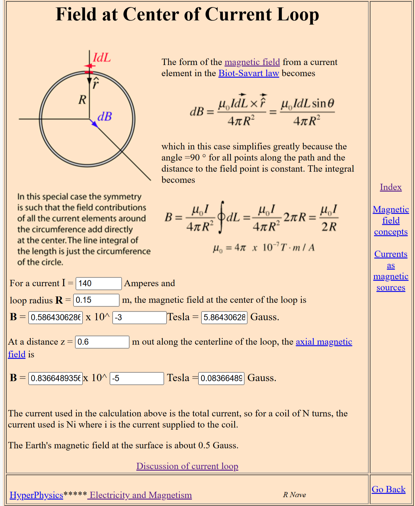

              Since we have all the experts assembled, let's look at the possibilities of a coil for a CCPI. (round scramble-wound), diameter 300mm, 70 turns, 2 Amps current,
              di/dt = 140/10us. At a distance of 600mm this gives us 0.0836 Gauss.
              This is possible for a CCPI, but would be an unusable coil for a traditional PI.

                This is where directly comparing CCPI with monopolar PI is tricky. It is dB/dt that determines the induced target kick and, in your example, that would be 8.37uT/10us = 0.837uT/us. Let's compare that with a monopolar design, where the coil is limited to, say, 20 turns but can turn off in 2us. The magnetic field at 600mm (for the same 2 amps) is now 2.39uT so dB/dt = 1.195uT/us, which is actually higher than the CCPI case. However, the CCPI can likely run a much higher N on the RX coil without compromising the timing. The bottom line is, it's hard to see all the gotchas involved so you almost have to build everything out and compare with real targets to get an accurate answer.
