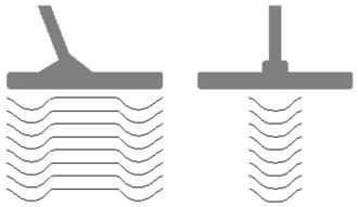

                DD coils give a good sweep area, but less depth, a typical tradeoff.
                The concentric coils give a reduced sweep area. The concentric, induction balanced coil give less depth and less sweep area.
                DD isn't as great on sweep area as manufacturers would have you believe. Here is an illustration from one manufacturer:

                Here are measured results, comparing a White's 950 CC with a Fisher DD:

                Only for very shallow targets does that DD (black curves) give the alleged "windshield wiper" pattern. As you go deeper, they converge to about the same coverage.

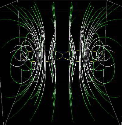

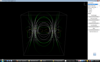

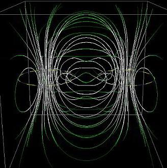

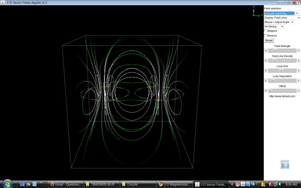

                                Here is a visualization of the magnetic fields of a Tandem coil in opposing and in aiding configurations. Click image for larger version

ID:	431646 Click image for larger version
Name:	Tandem_same phase.jpg
ID:	431647 Click image for larger version
