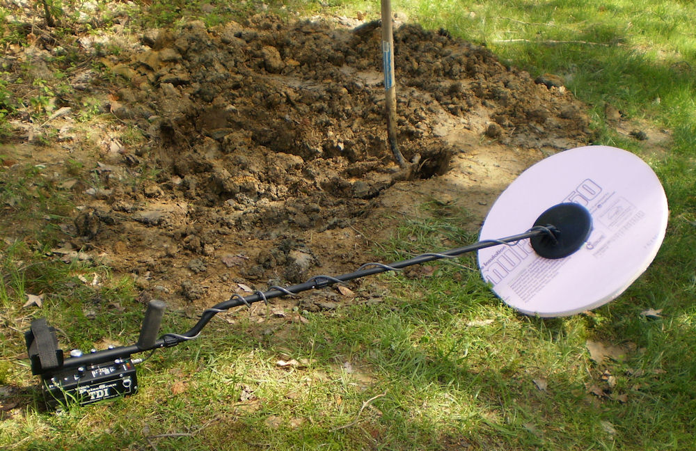

    If you are looking for deep caches, you can be a bit sloppier. Below is my 30-minute quick-build disposable 24" coil for cache hunting, made specifically to find a 3-pound cache of silver coins buried 2-feet deep. Unfortunately I cut one too many corners and did not bother to shield it, and it was just too noisy.

      Out of interest - did the TDI manage to detect the cache?
        In the air, it would detect a same cache at 27-28". But it was just too noisy on the ground to distinguish such a deep target. Interestingly, TDI found 3 really deep nails that I had missed when I cleaned out the cache site.
        Once I got 8" of soil off, both TDI and V3 detected the cache.

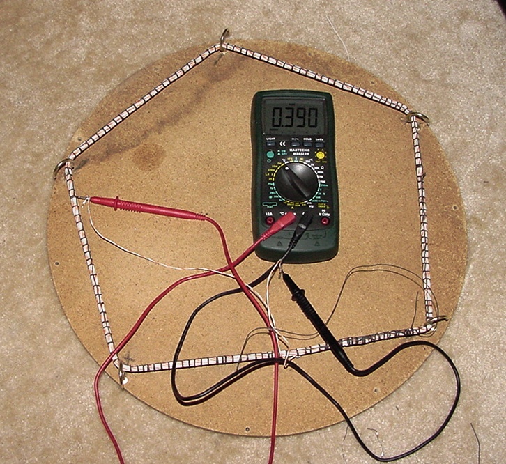

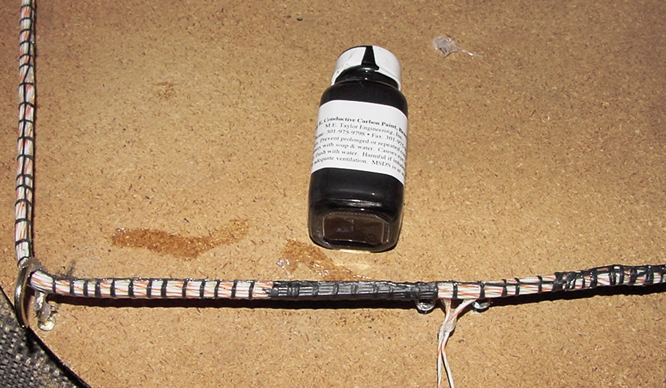

                        I have a question to Doc, Reg or whoever might know the answer.
                        As some of you know from the TDI forum I have built a 7" TDI coil with much help and encouragement (on line) from Reg. I am in the process of building a second TDI coil. I used the scotch 24 tape as shielding on the first coil and was planning on using some Conductive carbon paint I purchased as shielding on the second coil (18"X14"). However I read a statement by Reg that the conductive paint should be low resistance.
                        The carbon paint I bought has a resistance of 1200 ohms according to the manufacture which seems typical of conductive carbon paint.
                        Ok, finally to my question: Resistance wise, should this paint suffice as shielding for the second coil? Also, if so, can I paint it directly on my coil which I have half hitched and siliconed or should I first wrap a layer of the spiral wrap on the coil?
                        I did paint a 2" section of the coil just to see how it applies and acts upon drying.
                        Thanks,
                        Terry

                          Hi Terry,
                          The shielding paint normally goes on the coil housing on a PI. I know a guy who did apply the shielding to the coil but added a layer of tape first and painted the tap. This was for a coil for a VLF type detector, though. PI's require more shielding to be effective.
                          Now, I suspect the conductive paint you have will not be low enough resistance to work properly on a PI. I have a piece of the shielding paper from a Coiltek coil somewhere. If I can find it, I will measure the resistance of it. For some reason I think the resistance was somewhere around 40 ohms an inch or so, but I will check if I can find it.
                          Reg

                            Thanks much Reg for the quick reply. I have found some 18% silver paint online that is said to be .4 ohm/in. I guess that would should work but it's much more expensive than the carbon paint. The scotch 24 seemed to work fine but takes a little time to cut and wrap and add another series of half hitchs to hold it firmly in place on the coil. Just looking for a way to reduce my time and labor without sacrificing quality.
                            Terry
                              Hi Terry,
                              I found the old Coiltek coil and measured the carbon paper. It measured close to 75 ohms per inch.
                              Now, I don't recommend the copper or silver paint. The resistance will be too low. This can interfere with the depth and may be detected.
                              In other words, you can't have the resistance too low or too high when using a shielding paint. This is not the same as wrapping the windings in terms of how it works. You can have a highly conductive tape you use for wrapping the windings and that will not have a negative impact as long as it isn't detected.
                              I have some graphite based paint I need to try again. I suspect it will require several coats to get the right resistance. Also, I may try some y-shield before it is all said and done.
                              As for the use of the scotch 24, you can simply tape one end, spiral wrap it on the winding and tape the other end to keep it snug. Then simply add a layer of electricians tape over the shielding to keep it snug. I don't add any half hitches on the shielding.
                              Reg
