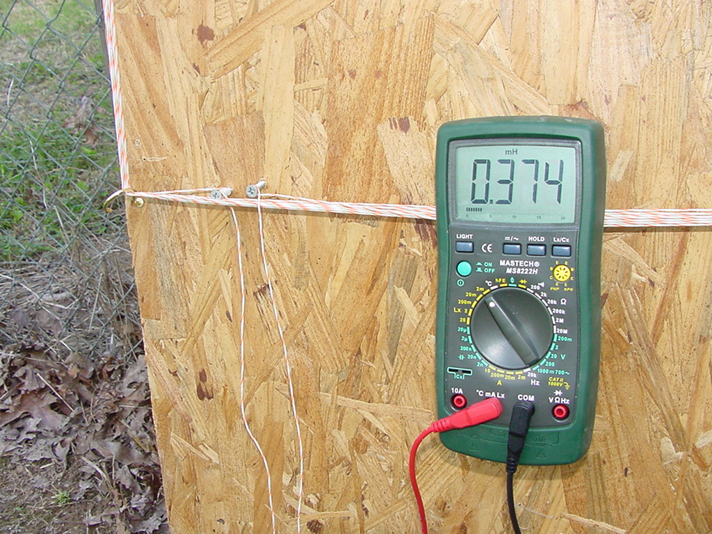

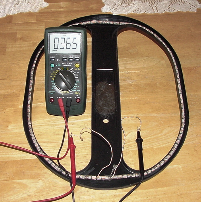

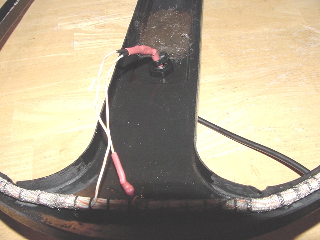

    Reg and others, I have always had problems with meters that I wrapped a wire around like the example of the LCD meter where the coil wires were wrapped around the probe tip. Does this give any false signal when measuring ?
    I have another lcr that only has blade slots and what can i use for a probe in that case, thanks Wyndham
      Wyndham,
      I'm not as knowledgable as Reg when it comes to electronics but I doubt that wrapping the ends of a coil wire around a probe a time or two will make any significant differance in your coil inductance readings. As to your other meter having "blade slots" I can't help you there. Maybe if you send a pic in your meters connections I might be of more help.
      Best Regards,
      Terry
        Hi wyndham,
        I have three different LCR meters and all have wire leads as a means of connecting to the coil. However, one of the meters does have slots also. Normally I only measure capacitors with the slots but I guess one could use a stiff wire inserted in the slot and then connect the winding leads to the stiff wire.
        As for any inaccuracies because of the meter leads and the possibility of any winding of the lead around the coil, please keep in mind that most of these meters only have a 2% to 3% accuracy to begin with. Any error as the result of LCR probe interaction is going to be far less than the general numbers of the coil, so I don't worry about it.
        Just use common sense when measuring the final result. By this I mean, don't set the coil windings on a metal surface, or have large metal objects under them. Keep everything relatively neat, so there is no wrapping of the coil leads around the meter leads.
        Finally, when in doubt simply check. If you wonder if something might alter the final results, simply try it to see. That is the best test and then you will know for sure. Make sure to test several times to be sure of the consistency of the testing until you are assured of the answer. A test of one seldom provides a truly accurate answer.
        Reg

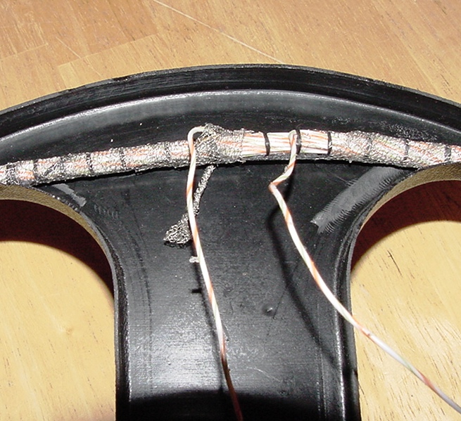

                Finally almost finished my 18X14 TDI coil
                After making 3 18X14 coils I finally got the 3rd one large enough to fit the housing I purchased. The first two are both less than an inch short but no cigar. I'll use those later on with some home made housing maybe make one round and one a 22X6 or something like that.
                The positive side of having made several is that I can now put a good working coil together very quickly. I started this evening about 4PM and by 8 I had put it together almost from scratch and briefly tested it. The only thing left to do is to epoxy or foam foam the housing and seal. It works great though at least with air testing especially in "ALL" mode. I didn't know I had so much metal junk in my yard! Seemed to work fine even with the pulse delay at 10.

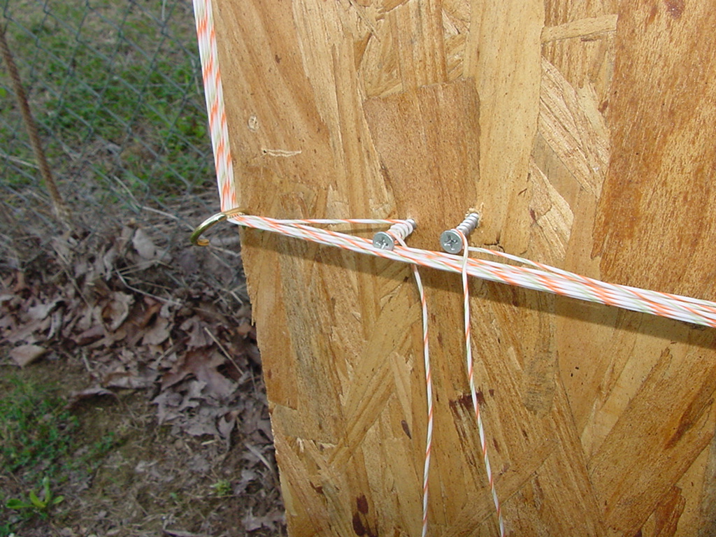

                Here's a real quickie explanation of how I made this one:
                I already had a set of hooks screwed into wood to wind the coil on, I just added an additional loop to lengthen the coil. I tightly wound my 24ga teflon coated stranded wire around the hooks till I throught I might be close then I checked the inductance with my meter. It came up 180 uh so I wound about six more windings around the loop and it came up about 330 which is about what I was looking for. Then I cut the wire from the reel giving me an extra 8" or so and wrapped the end around a screw 2 or 3 times to keep the winding tight. I then made a series of half hitches all the way around the coil. Then I took my cauking gun and ran a bead of silicon all the way around the top of the coil winding. Then I smeared the silicone all over the surface of the coil. Without letting the silicone dry, I wrapped a single layer of scotch 24 shielding tape around the entire winding except for about the last 1/2" as you don't want the shield to form a complete loop. I have found that winding the shield over the wet silicone really helps to hold it in place once it's dry. I then put just one half hitch or 2 at the beginning and one at the end of the shield and leave about 3 inches of shield at the end that I twist up till it looks wire like to give me a lead I can solder to. At this point I usually check the inductance of the coil again to confirm all is well. I have found that wrapping the shielding directly to the coil affects my inductance reading a bit, usually less than 40uh so I like to see my pre shielding inductance between 330-350. Some recommend using a wrap material between the shield and the coil to help reduce any interaction but I unknowningly wound my first coil without the wrap and it worked great as does this coil. I probalby would have used the wrap with this coil as I have some but the wire I'm using is 24ga and it makes a pretty thick loop and I wanted to avoid making it any thicker. Had I used 26 ga wire or thiner I might be tempted to use the foam wrap but I got a great deal on 2Kft of this wire so I'm gonna use it. Moving on, I then run my single conductor mike cable into the coil. I try to keep it as short as possible inside the coil as it contains metal of course. I solder one side of the coil wire to the mike center conductor and the other coil wire goes to the coild shield and to the mike shield. Of course I use plenty of shrink tubing on all wiring. Then I solder the other end of the mike cable to a 5 pin mike connector. The ground side goes to pin 1&5 and the single conductor to pins 2,3&4. I split the mike shielding in 2 parts and solder to pins 1 and 5 for extra strength. Slide one large piece of shrink wrap over the 5 soldered connections and shrink. I once again check my inductance before testing the coil by connecting one lead to either pins 2,3 or 4 and the other lead to pins 1 or 5. Your inductance should be very close to your last check as adding the coax should cause little change. Hope this helps someone. A month ago I had no idea where to start when it came to building a coil but thanks to Reg and his posts and his generous sharing of information both here and at the TDI forum I have learned so much but for sure still have so much more to learn. Thanks again Reg.
                Terry
                  Hi Terry,
                  It looks like you are doing just fine in the coil making arena. Now, my question to you is, does this large mono coil work at the minimum delay setting of 10 usec? If it does, you are really doing exceptionally well, since that is very hard to do. I would think it may need to have the delay adjusted up just a little.
                  Now, as for your coils that are too small, you might look at another housing reasonably close and you might want to try something different with them. You can take them apart of course, or you can form them into two coils and use it in the 14" by 10" housing. In this case you will form a figure 8 with one part of the eight smaller. The larger one will form a large mono loop around the outer part of the housing and the smaller coil will fold back into the large coil and fit in the narrow center zone of the housing. This will give you sort of a dual field design and still be a very large elliptical coil. I am not sure this makes sense to you so if it doesn't I will try to draw something to help.
                  Anyway, it does provide a way of using your other coils you wound.
                  Now, getting back to your large coil you just made, do you have a particular use for it in mind?
                  Reg

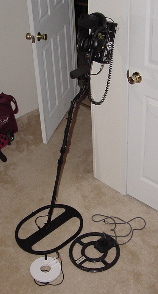

                    Extra coils
                    Reg,
                    Thanks again for the advice. The large coil does seem to work at 10 but my initial feeling is that it may work better at the medium setting. I'll test it better later but I'm off to the beach this AM to visit my family.
                    I wondered if I might make a DD out of one of the extra coils but you confirmed it. I really don't want to take either back apart so I think I might try and make a DD.
                    I figured I would use the 18X14 in areas where there is little trash and targets are spread out a bit. When I was at the beach recently I found places where targets tended to be far apart. If I every make out to gold country again such as at Rye patch I'll definitely use this coil some and it might find use looking for metorites as well.
                    I'll soon make a test garden so I can better compare my homemade coils with each other and with the stock coil. However, during my quick backyard test of the 18X14 I definitely had to lift the coil much higher off the ground to loose the signal compared with the stock coil.
                    Terry

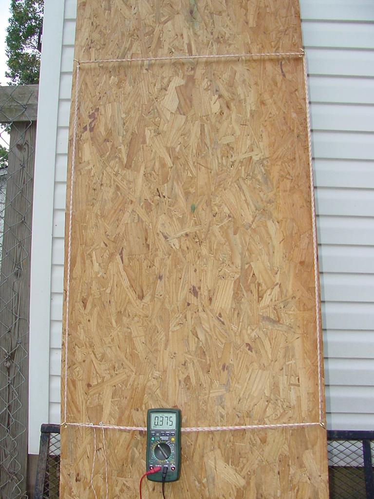

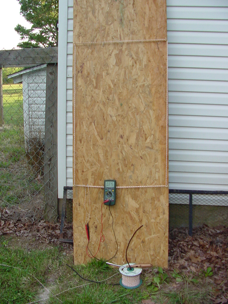

                                Start build of 1 Meter coil
                                To Doc, Reg and all,
                                Just got a start on building a 1 Meter coil. For the moment it's actually 28X44 due to the width of my backing.
                                Building it simple and sticking to what has worked for me so far.
                                For wire I'm using 24ga stranded single condutor teflon coated wire. 10 turns of wire seems to give me a suitable inductance reading of about 370uh. 9 turns only came up to 290uh so I went with 10 turns. Attached are a few pics. Will add more info and pics as I go.
                                Terry
