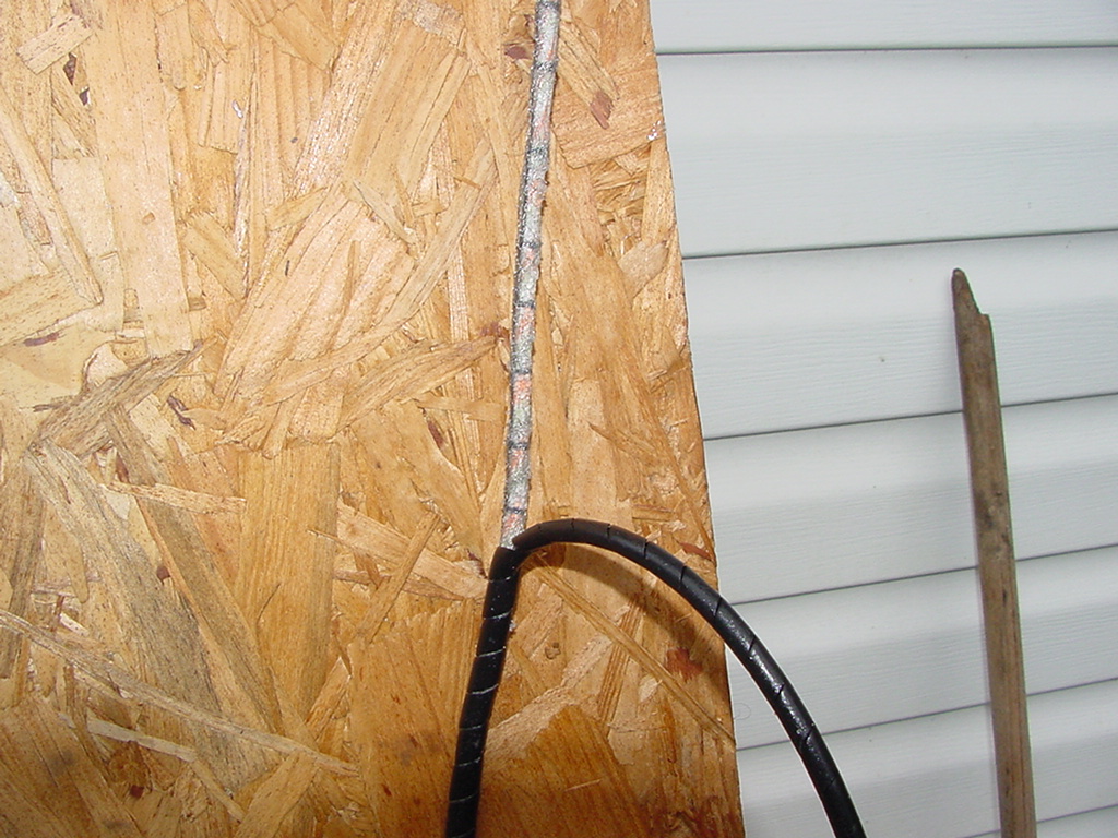

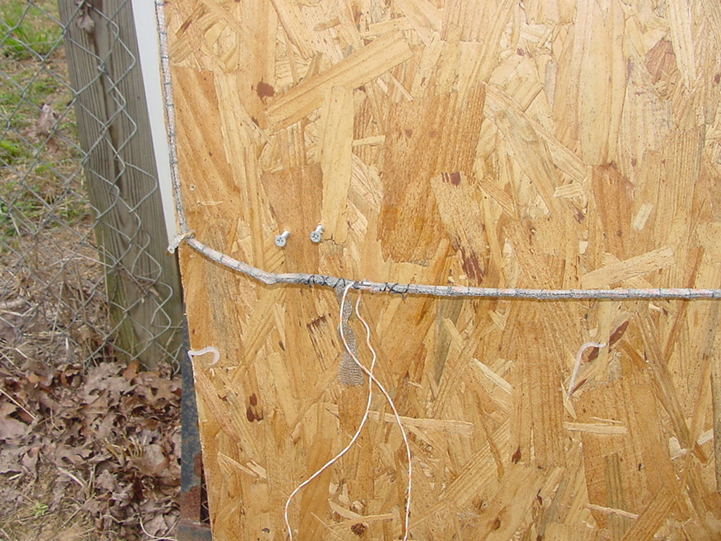

          Affect of non Ferrous metal on coil inductance
          ISM,
          I had looked around our place for something non-ferrous to set the coil on and take an inductance reading but I couldn't find anything with large enough surface to do a proper test.
          I relooked at your post tonight and realized we probably have some pans or something related to cooking that would work. Anyway I found a electric grill made with aluminum and did a little check with the coil laying on it. Is appears it very much also affects the inductance and even more so than the ferrous surface did. On the table it read 346 and on the al griddle it read less about 100 less at 242.

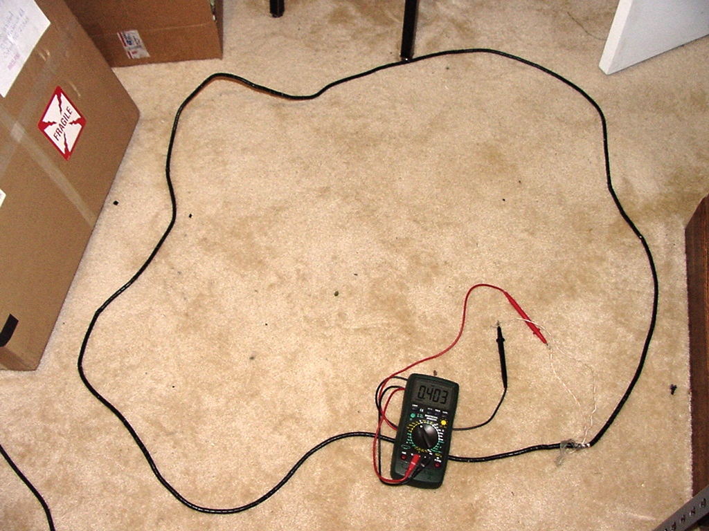

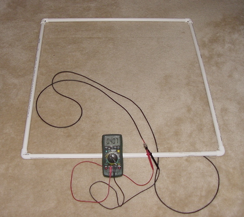

            Near finished with 1M coil
            Hello all,
            I am near finished with the 1M coil. I also pretested the coil prior to trying to install the coil in 1" 600 PSI PVC. I say trying to install it in the PVC as that was the biggest challange and pain of this project. If I had to do it over I would use a larger diameter tube pipe.
            Here is basically what I did to get it to this point:
            Pretty much built it like the smaller coils.
            10 wraps of teflon coated coated 24ga stranded wire
            around 4 hooks&eyes, Measurement of coil is 28X44, 370uh initial Inductance. Wrapped coil with a series of half hitches using archery serving, then coated with silicone II and let dry. Then added another coat of silicone and wraped 1 layer of scotch 24 shielding slightly overlapping around the coil on the still wet silicone. Then apply more silicone over the shielding and applied a layer of spiral wrap over the wet silicone. I then added a layer of electrical wrap over the spiral wrap.
            Here are some results of the pretest prior to installing in the PVC. At Regs suggestion I wrapped the coil in several configurations to note the results:
            Initially, the plywood board the coil wire was laying on wasn't wide enough to fully open the coil into a circle, so I laid the coil out oblong. I turned off the GB and started out at 10 for the delay. It seemed to work at 10 but I don't think it was really working correctly untill the delay was at 10 oclock. What suprised me was the lack of noise. With the GB off I could turn up the sensitivity to 9+ and the noise still not bad. This is when I realized I don't think I had yet hunted with this detector with the GB off. When I turned on the GB the noise I was used to hearing came back and I had to turn down the sensitivity to 3-4 to get a near steady threshold tone just as I have to do when using the stock coil.
            I wasn't quite happy that I couldn't test the coil as a round loop so I found a 3Ft piece of plywood and laid it on the board crosswise so I could open the coil into a circle. I mostly used a steel 12" 3/8 breaker bar as the target. I could hold it up about 3ft above the board and still detect it but the impressive thing to me was that I could stand back 2Ft from the coil and almost 3ft above the board and I could still detect it. Meaning this 3ft coil might give me close to a 7" wide effective target zone. I tried a quarter and the depth wasn't impressive, maybe 15" air test but I won't be looking for small objects when I use this. Also, with the GB on it would not air test nearly as deep even in the all conductivity mode but again, I'll be running this big coil with the GB off where ever possible.
            I then made the coil into a figure 8. I didn't see much if any change in the noise level but the delay seemed to start working right at about 7:30 instead of 10:00 but the depth wasn't as good.
            I then formed 2 coils from the large one, one inside the other with about 4" spacing between outer and inner coil. Depth was suprisingly good, nearly as good as when the coil was full size. Unfortunately I didn't test sensitivity on this dual field configuration, nor did I turn the GB on and test it but I bet the sensitivity was as good as the depth. I plan to later build some smaller duel or better field coils as I now see thier potential. I also have seen the depth potential of the non GB mode of the TDI with these large coils and will use it more especially where trash and mineralized ground are not an issue. As soon as I complete some finishing touches to this coil I'll do a more comprehensive testing and post the results.
            Terry
