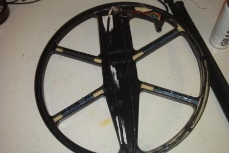

            Sure.. when i"ll finish the coil i will inform all forum. I sprayed every coil 4 times with graphite33 and now i have a resistance about 1.8k/". I put the coils in the housing, i fixed it after the null and now it is ready for the resin..... but i have not resin . This time i am busy, so i can't looking for resin, maybe next week. Of course i took some photos at any construction stage.....
              Hi.

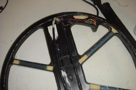

              I finished the construction of coil.
              I need to put resin also, but this is not problem. Today, after the null i tried it. Inside Lab results was very good. There are some place in the lab where there was not erratic signal from economy lights.... power supplies etc.
              Generally i am very glad with this 15" coil. I will go out at shops to find resin glue to fix it, so to go for really test at farms.
              Thanks all for your help.....

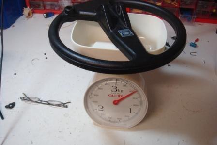

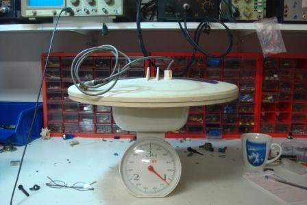

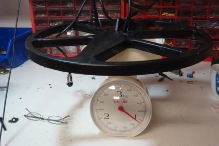

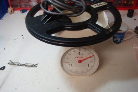

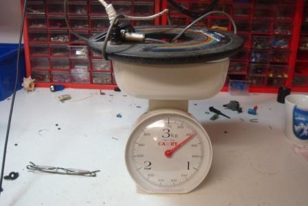

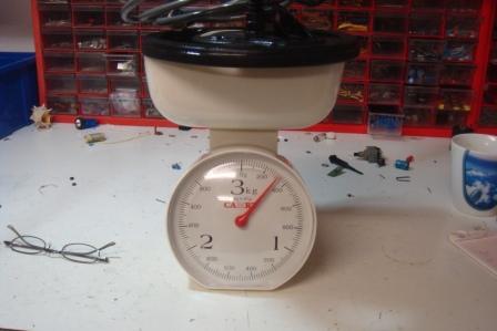

                But the main problem is other...., the weight...... After the resin, the coil is very heavy. I weighed it and it is 1040 gr. The same time i had in the lab some coils so i weighed them. What i found????
                My 15" coil is 1040 gr...
                The Whites Blue Max 950 is 420gr
                The Whites BlueMax 1500 is 1100gr, yes it is more heavy than mine
                The Minelab Tornado 1000 without the cable is 430gr
                The TDI 7.5" is 310gr and
                The TDI 12" is 510 gr.
                If somebody has a WOT 15" coil, i want to tell me who is the weight of this coil.

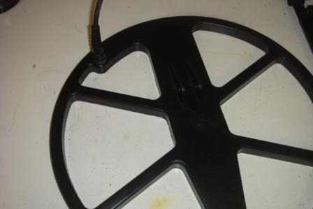

                  Nice work.
                  Can you tell me how you null the coil?
                  I see some kind of deformation on RX centre.
                  Weight is ok.Its big coil.37cm right?

                    Hi .
                    Weight is not good, maybe the balance point is wrong.
                    Beleive me, it looks very heavy.
                    Now about the null.... i connected the Txcoil to the sovereign and i connected the oscilloscope to the coil (one channel to Tx so to see the phase between Tx and Rx and the other channel to the preamplifier out). Null was very critical, and when i put the resin i destroed a little the null. After it i connected a wire in series with the Rx winding and i move it until to see again a good null. Again some resin and it is OK.
