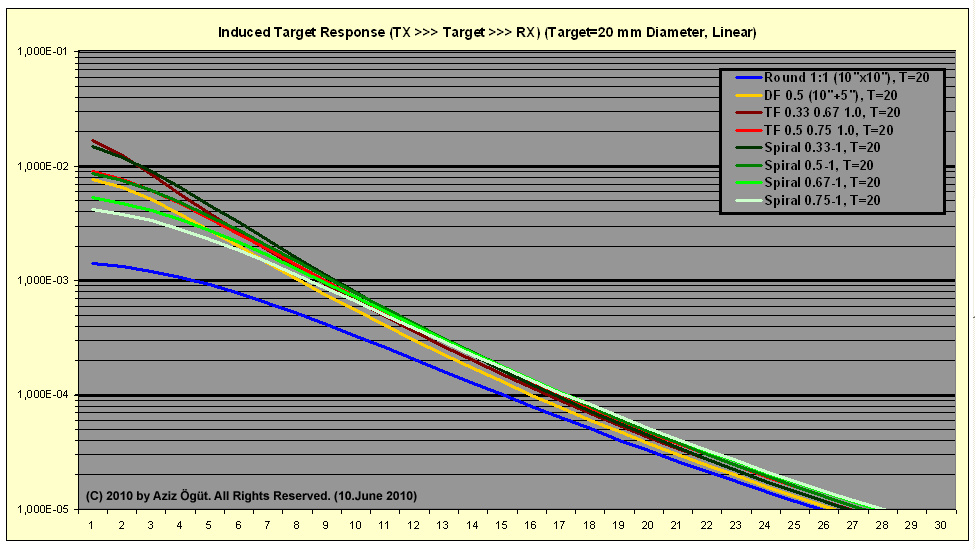

      Outperforming the Dual Field Coils
      Hi all,

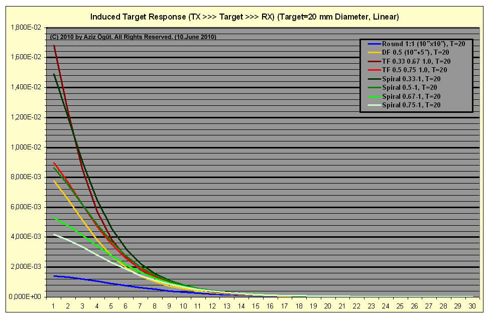

      I will show you, which coils are performing better.
      I proposed a Tripple Field coil and Spiral coil former. All together in a comparison shows, how they perform.
      TF 0.33 0.66 1.0 means (Tripple Field Coil):
      Coil1 at 0.33*R, Coil2 at 0.66*R and Coil3 at 1*R, where R=outer radius of coil.
      TF 0.5 0.75 1.0:
      Coil1 at 0.5*R, Coil2 at 0.75*R, Coil3 at 1*R
      The Tripple Field split coils have all the same number of windings.
      Spiral 0.33-1 (Spiral Coil):
      Spirally wound coil starting at 0.33*R and ending at 1*R. The number of windings are evenly distributed from starting radius to ending radius.
      and so on...

      PS: the last picture is a log-scale (not linear as shown).

          But I would like to know, how the proposals behave in the field. I hope, you are willing to share your experiences. Some feedback would help to optimize the coils further.
          I would suggest to try the spiral coil 0.66-1 or the 0.75-1. The first few detection cm's can't be used either. To make the design easier, it could still be a rectangular spiral coil.

            I forgot the give an unit to the x-axis on the graphs.
            The target distance is given in cm on the x-axis.

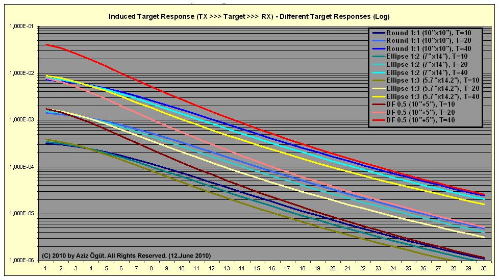

                  Further Dual Field Coil Analysis
                  Hi all,
                  I want to show you, how the Dual Field coil behaves to different size targets. And how the Dual Field coil compares to other coil types (see below).
                  T=10: 10 mm target diameter
                  T=20: 20 mm target diameter
                  T=40: 40 mm target diameter
                  Aziz

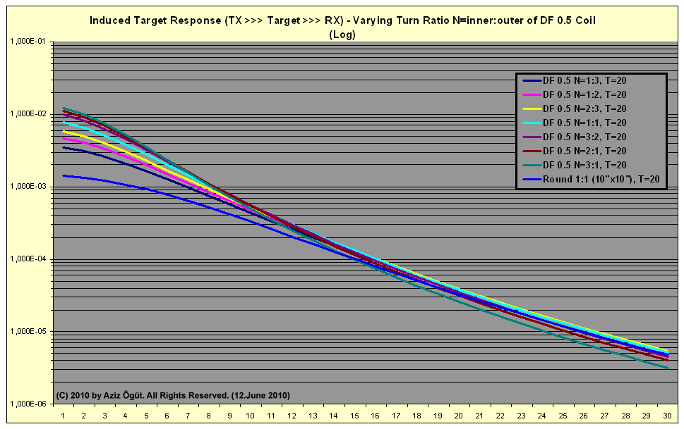

                    Dual Field Coil Turn Variations
                    This is the Dual Field 0.5 coil, where the turn ratio of the inner to outer windings are varied (see below).
                    Syntax:
                    N=inner:outer windings turn ratio
                    N=1:3 means, the outer coil winding turns has 3 times more windings than the inner coil
                    N=3:1 means, the inner coil winding turns has 3 times more windings than the outer coil
                    All variations have the same inductance L and same coil flux area of 500 cm² (outer coil).
                    Aziz
