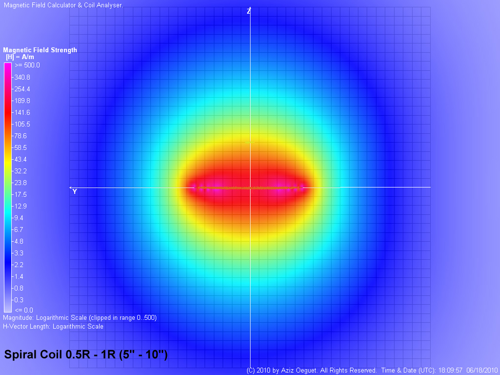

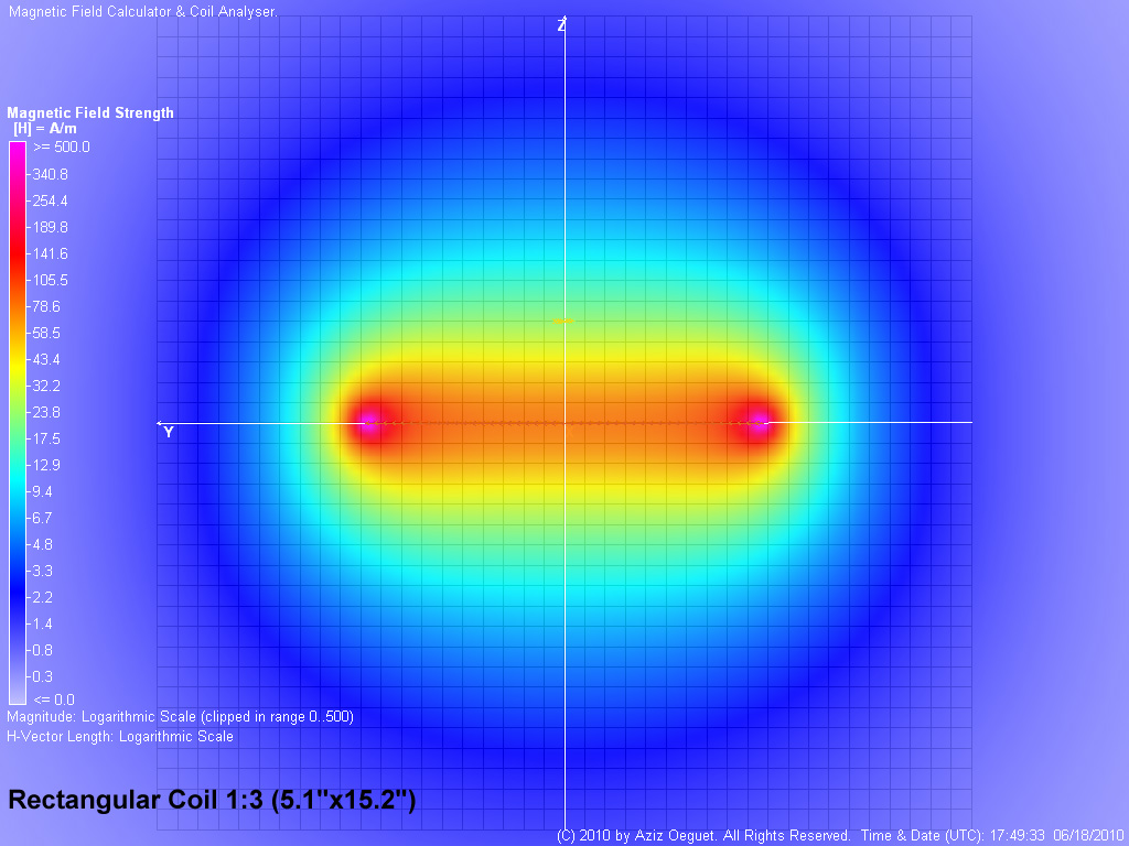

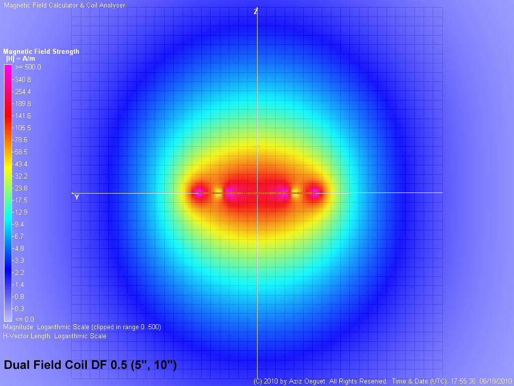

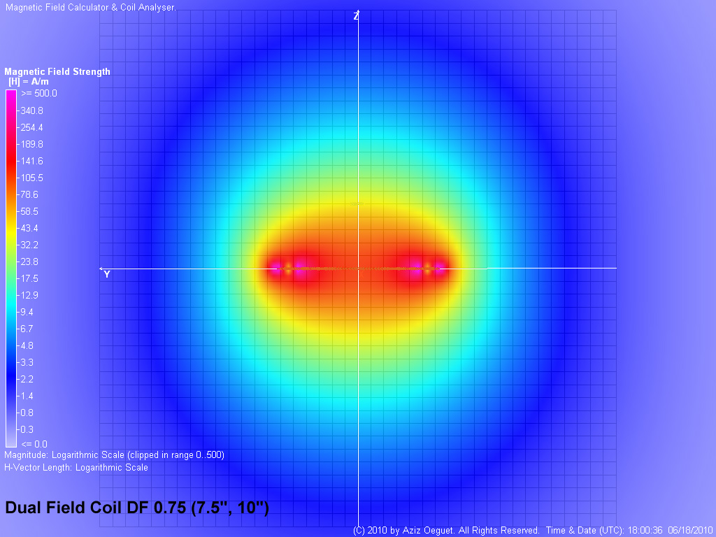

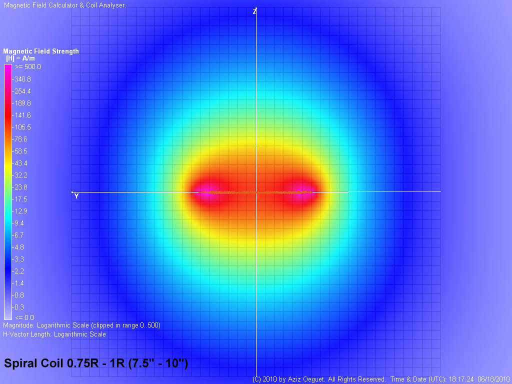

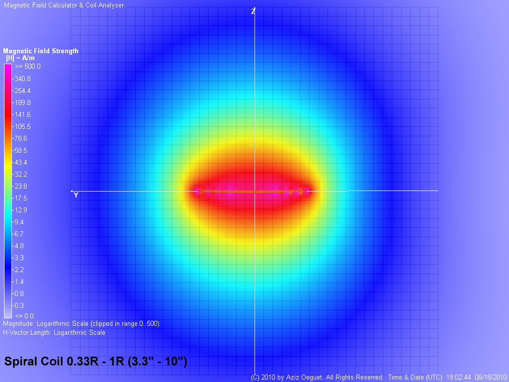

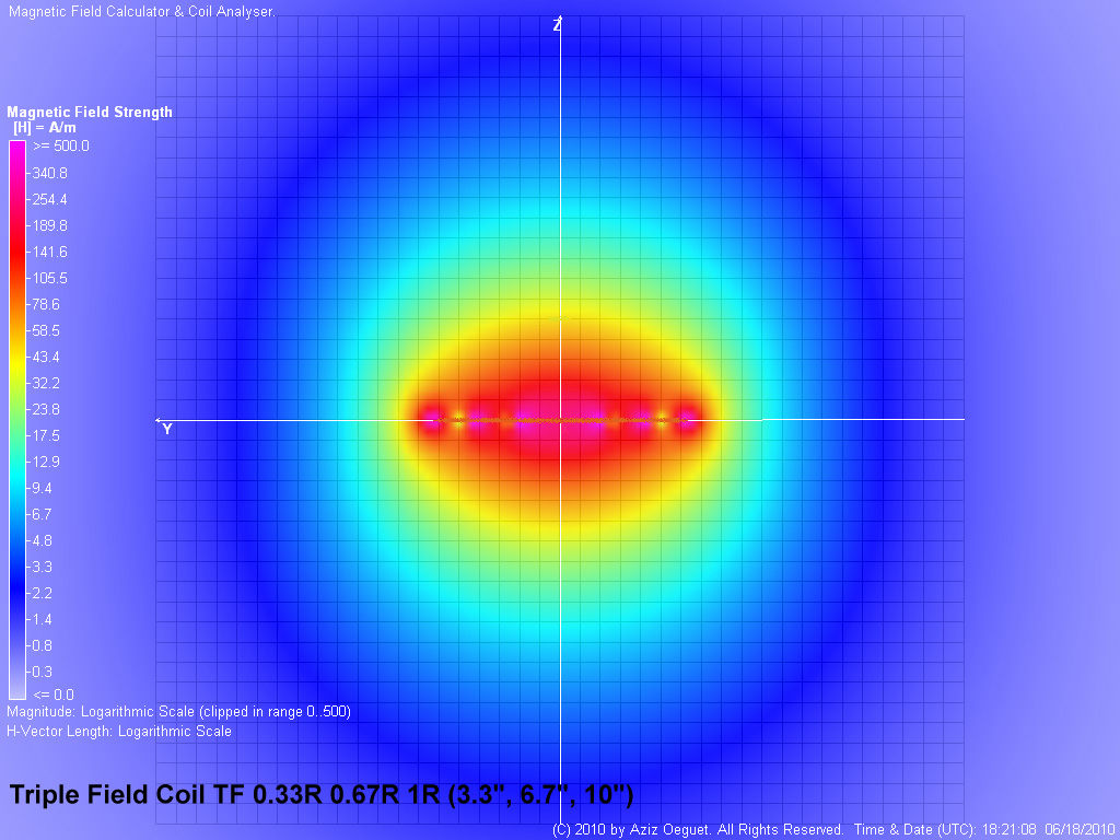

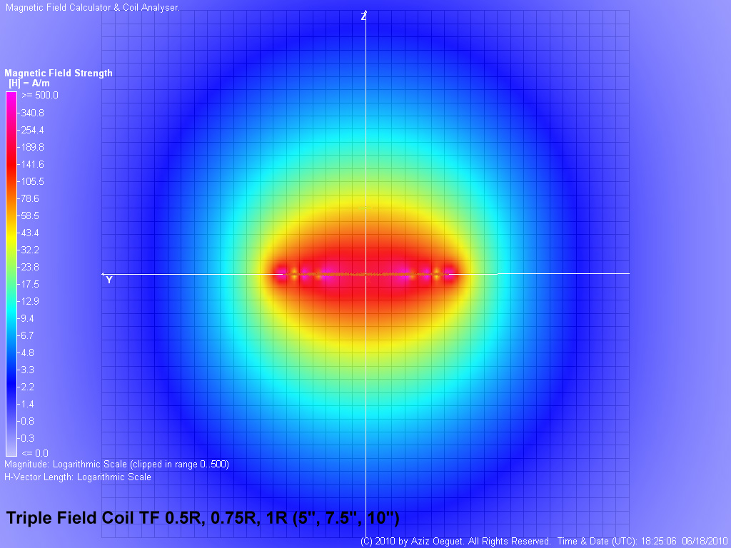

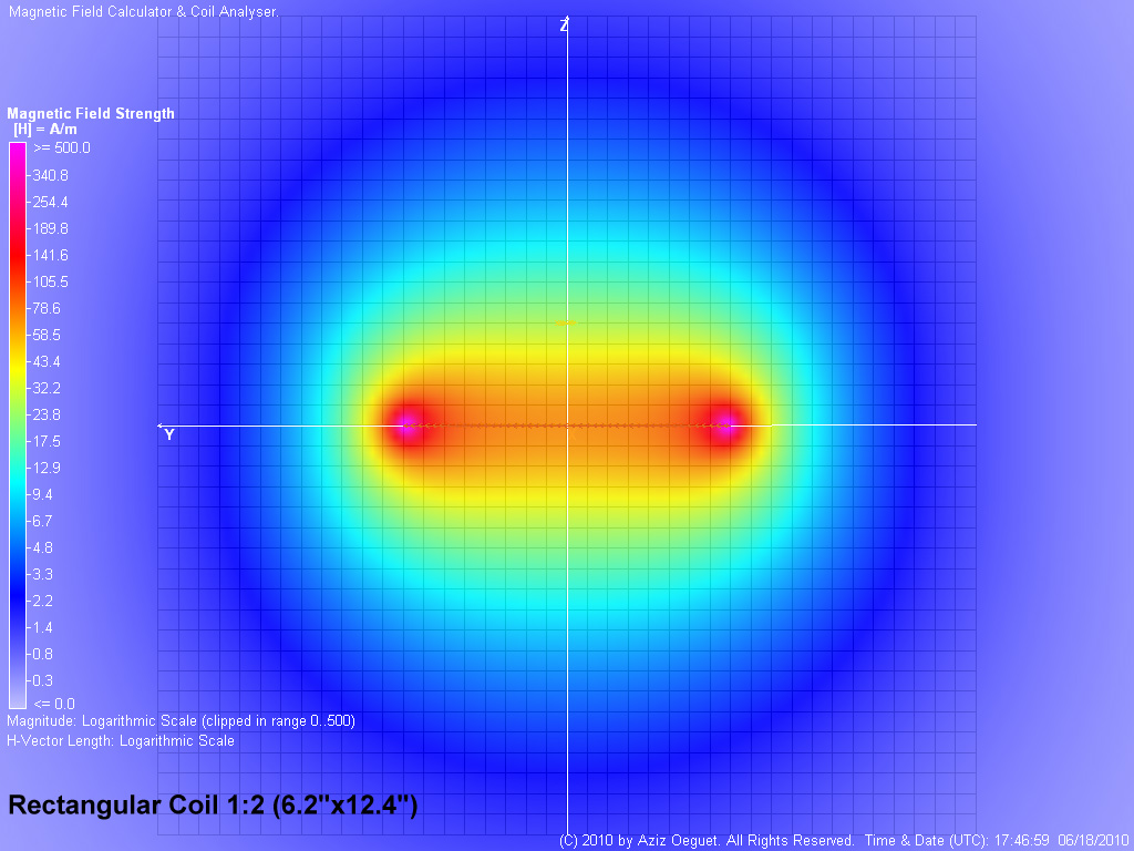

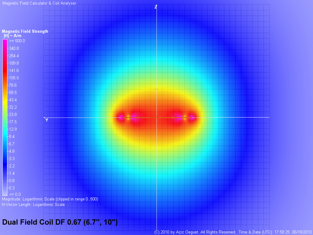

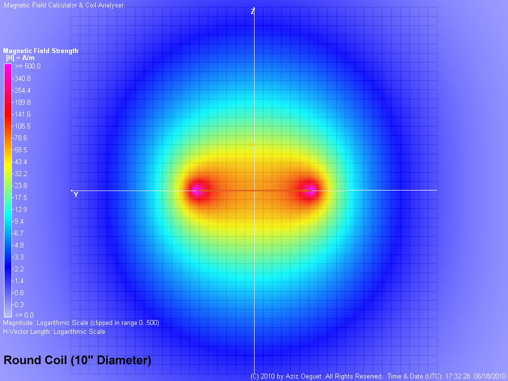

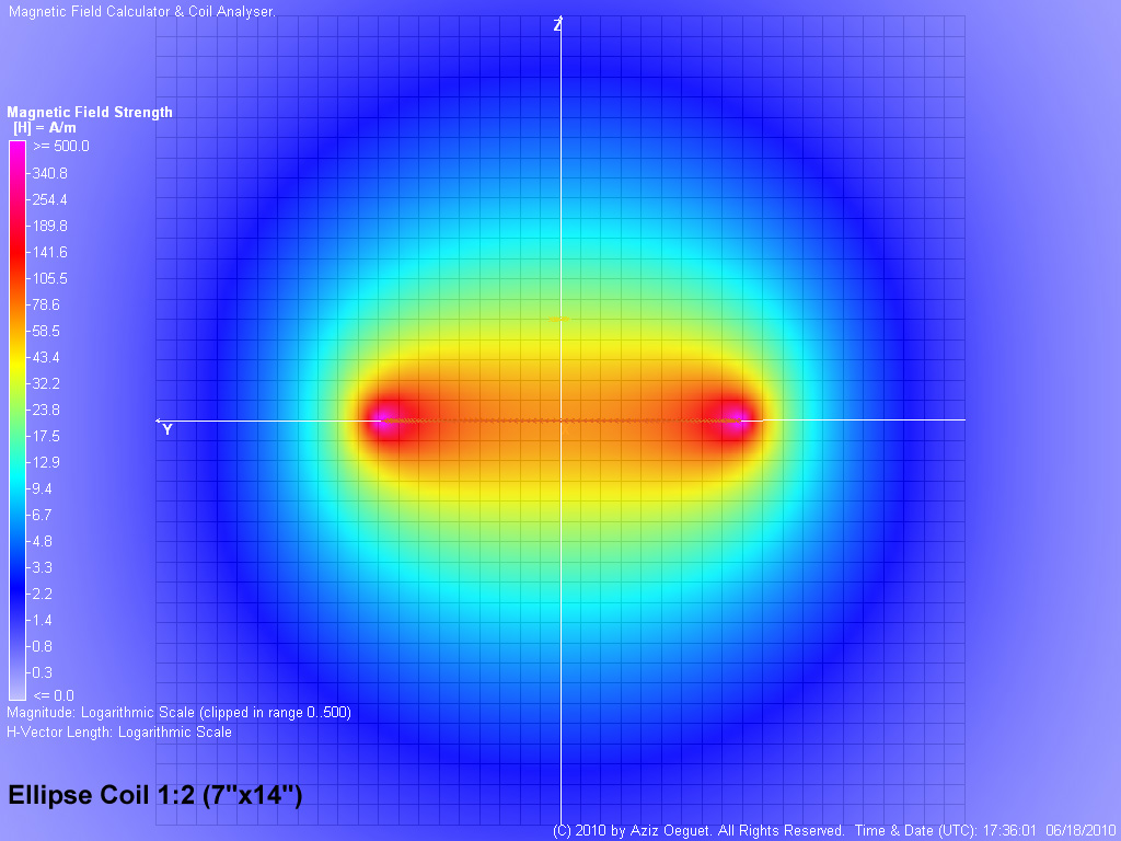

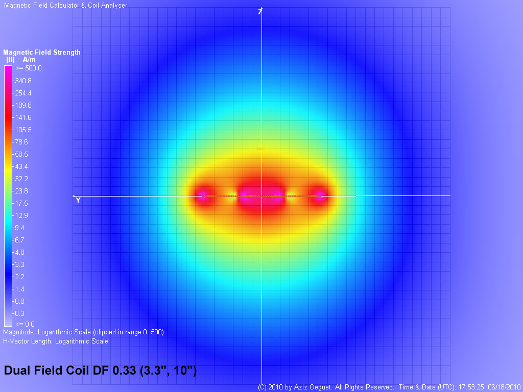

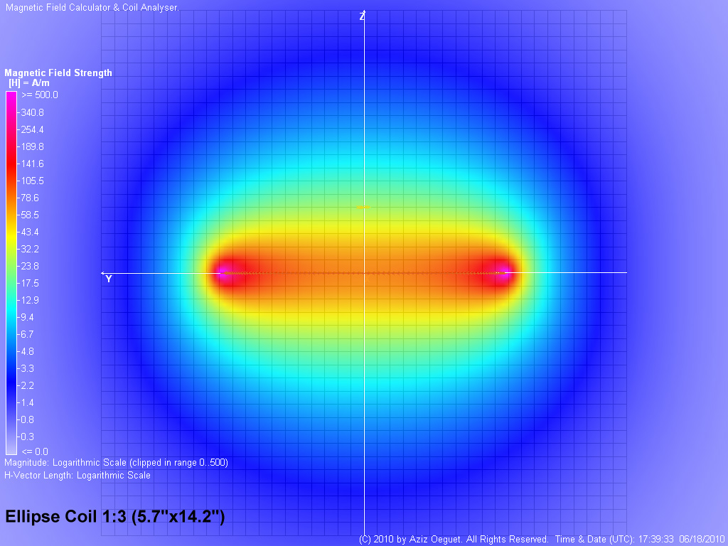

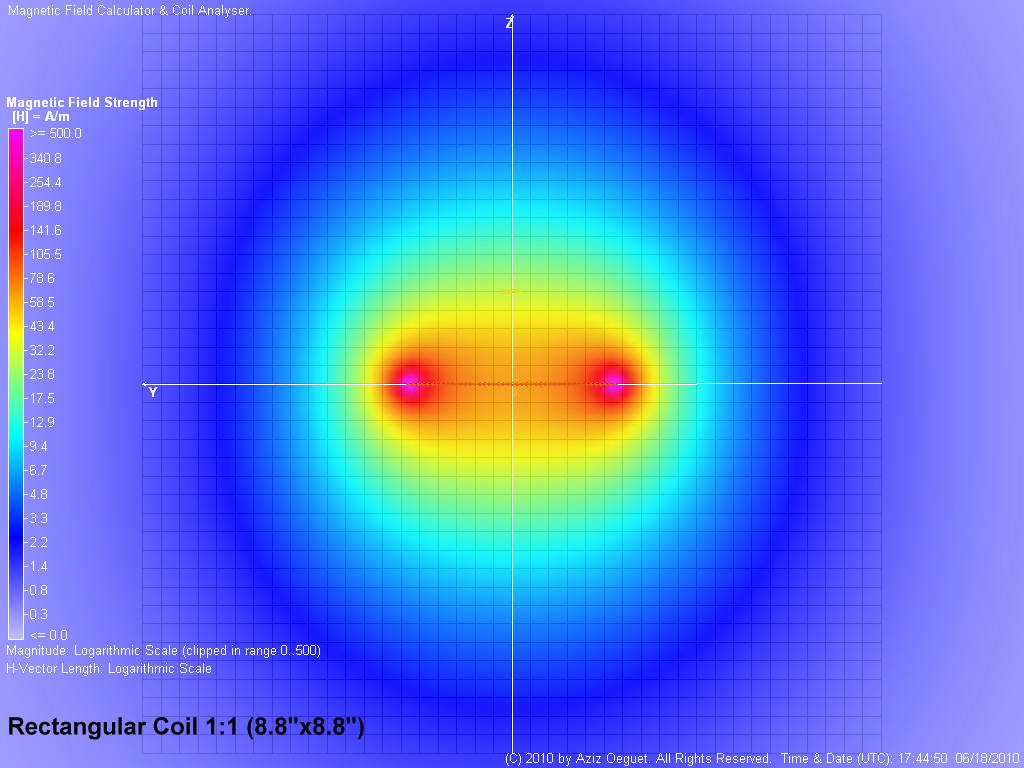

    Hello friends,
    is anybody interested on the magnetic field strength (MF) pictures of the compared coil configurations?
    I am sure, you will be.
    Ok, eat this.
    All pictures have the same 3D projection parameters. The x-axis is not shown (going from your eyes into your display). The y-axis shows the longest coil dimension. The z-axis the height/depth above/below coil. The small target is still placed at z=10 cm (can you see it?). The axis length is 40 cm (going from -40 cm .. +40 cm). It is divided every 2 cm for a better comparision. So you can orient at it.
    16 MF pictures will follow now ...
    Have fun,
    Aziz

        Thanks Aziz,
        These are excellent visualizations.
        Tinkerer
        • #51
          Aziz, really cool visualizations! Interesting that the triple coils appear to have a "cold" spot between the two outer coils. It's too bad there isn't a way to reflect a magnetic field so that less energy is expended on the upper side of the coils. Have you tried simulating other shapes that are asymmetrical along the z-axis such as cones?
          I'm new to the forum, so I'm curious about the software you use, too!
          -Stefan
          • #52
            Hi Stefan,
            thanks, it was a long way to achieve this. The coil software is written by me. I am adding as many functionality as I need. I am not giving the coil software away to ensure that coil improvements will be shared in the public domain.
            This "cold" spot does not matter. The coil housing won't allow targets to come too close the coil. The one sided exitation of magnetic fields isn't possible.
            This wouldn't make much sense or get some benefit.
            Aziz

              Hi Aziz,
              I mentioned the asymmetrical shapes because I was curious whether a field could be produced that was larger on one side of the z-axis than the other. I understand that for a given segment of wire the field is symmetrical, but is it possible to change the shape of the field over a collection of turns? That is, does the shape of the field always follow the contour of the wires that generate it?

                Hi Stefan,
                Hi Aziz,
                -Stefan
                have a look at the following sites:
                http://en.wikipedia.org/wiki/Magnetic_field
                http://en.wikipedia.org/wiki/Maxwell%27s_equations
                http://en.wikipedia.org/wiki/Gauss%27_law_for_magnetism
                The Gauss's law states:
                <damn, the formula can't be displayed here>
                This law does not allow such wishes. No magnetic mono poles exist.
                Answer to question 2:
                The coil geometry defines the shape of the whole magnetic field around the coil. Every small part of the coil segment (filament of wire) produces it's own magnetic field lines. At a point of interest (x,y,z) , all magnetic field lines at x,y,z produced by every filament add up together (vector addition).
                I am sure, wiki can explain it better.
                Aziz

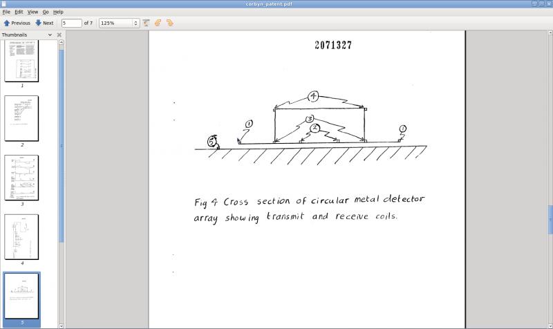

                          Hey ... not the Corbyn Patent again !
                          Last week I got the filed application but forgot to post the info here. It's on my desk at work, I'll try to remember to post it tomorrow.
                          errmmm .... isnt the Corbyn patent a "dual field" coil ?
                          "1" and "2" are tx coils.
                          Regards Moodz.
                          • #60
                            An induction balance co-planar coil is also a dual field coil!!!
                            An anti-interference coil (figure-8, double D) is a dual field coil too!!!
                            Aziz
