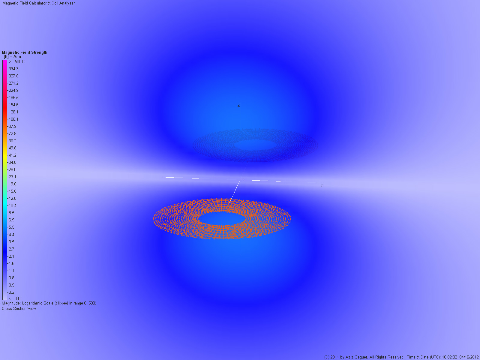

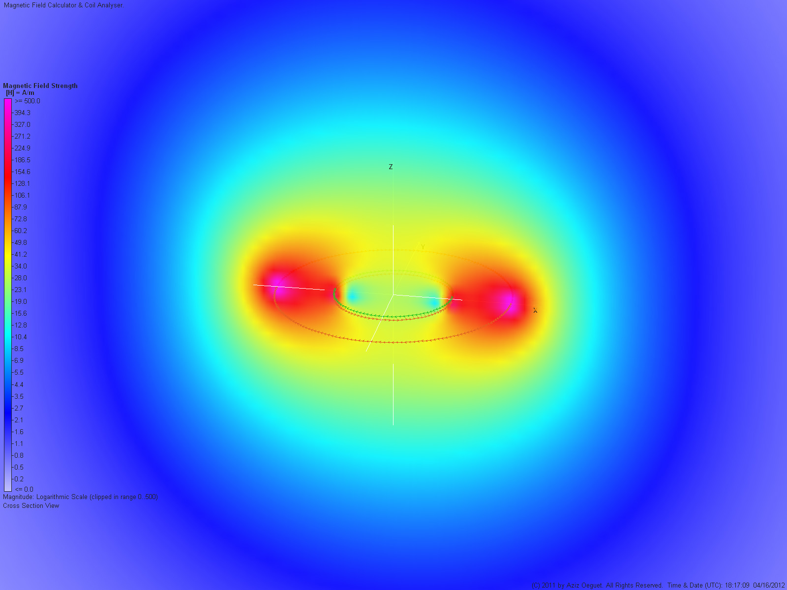

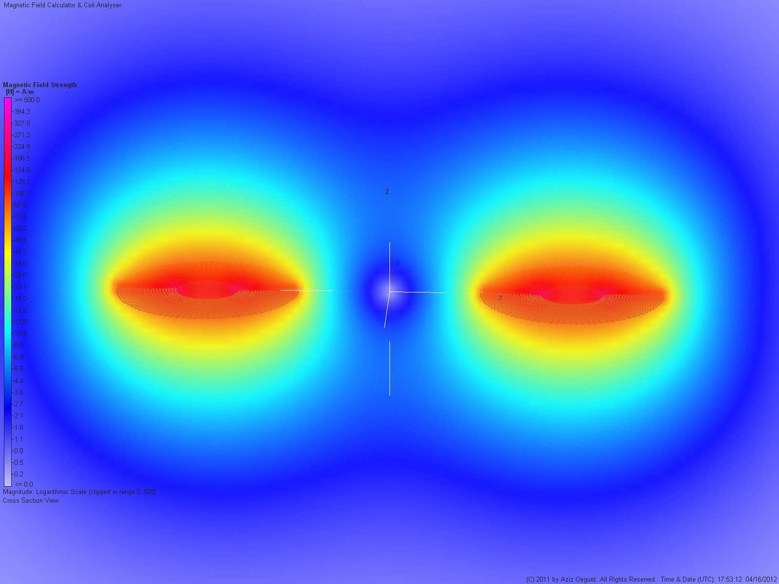

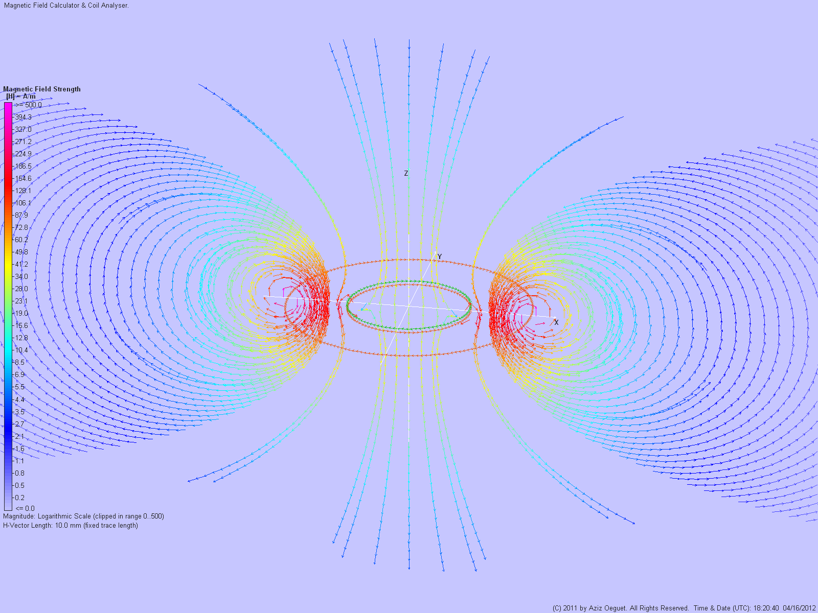

Tinkerer, can you provide pohotos of concetric loops?
1. reverse current in inner half scale of outer dia of 25cm and inner about 12,5cm
2. same values but current in same direction in both coils.
