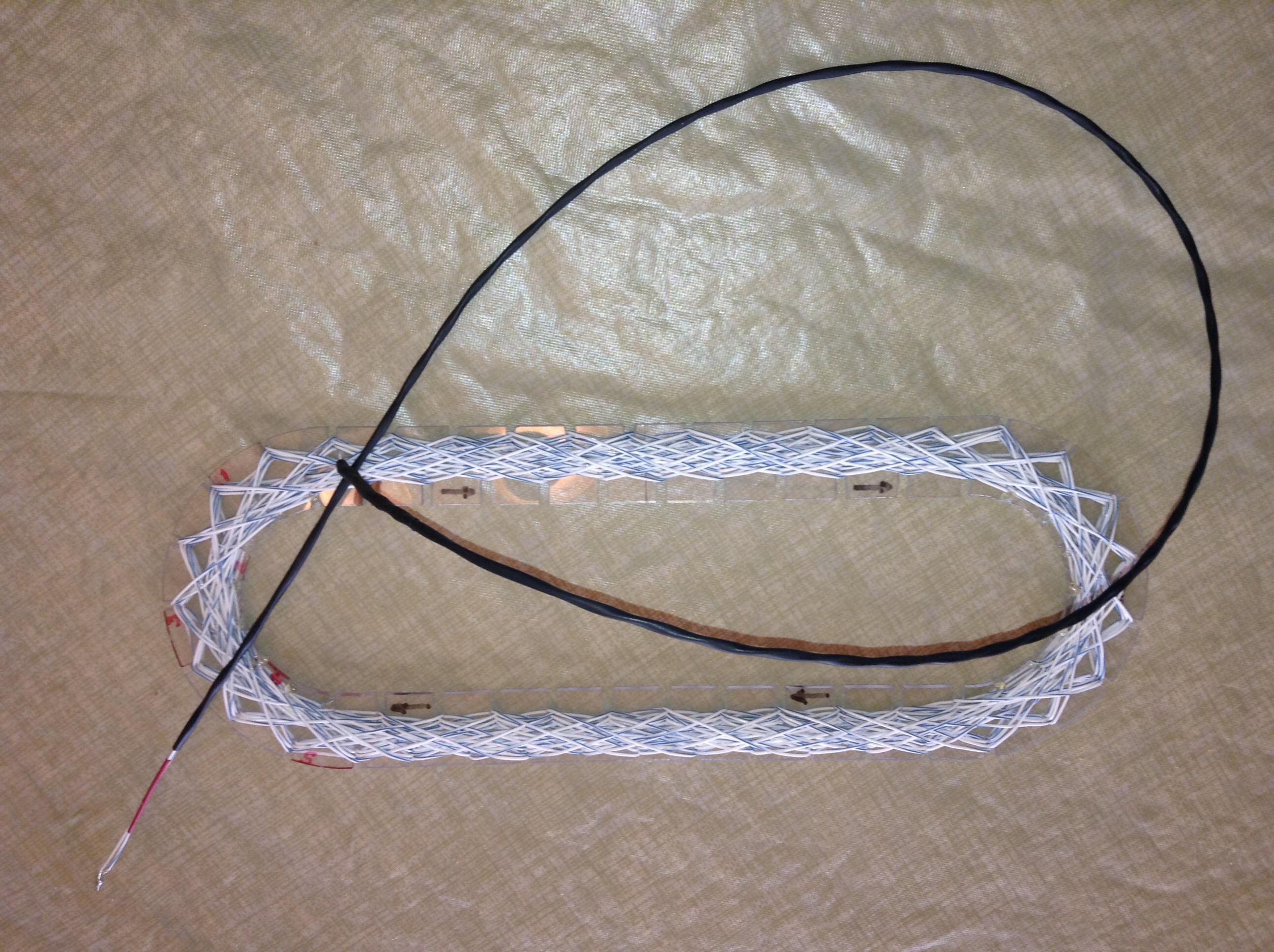

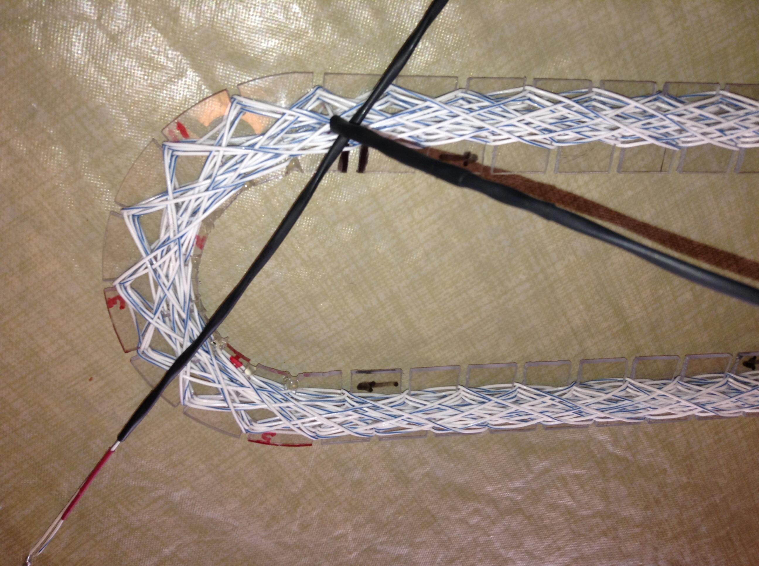

          • Attached is a photo of my oval 4" X 12.5" coil showing the Lexan form with 28 turns of 24 AWG, 600 volt PTFE stranded wire yielding 328 uh and a SRF of 965kHz with 37" of twisted pair feed that is just a continuation of the coil winding and twisted at a rate of 2 to 3 turns per inch. The feed line sheathed with 2 layers of 1/8" shrink tube and the coil end has 2 additional layers of 3/16" shrink as reinforcement to snugly fit into the neoprene cable fitting not yet shown. The exposed wire end with the red heat shrink indicates the innermost wire end that must be tied to the hot or high side of the detector coil connection. More construction photos to follow as the build continues.

            • One more picture of the whole coil.

                  Hi Kellogs,
                  It is very resourceful of you to make your own vacuum forming rig and I'm sure will use it for all kinds of things for years to come. I have no experience with the Surf PI so I guess I'm not much help to you. Thanks for the kind words on my my new oval coil. There will be ongoing posts on its construction to completion.
                  Best of luck on your projects.
                  Dan
