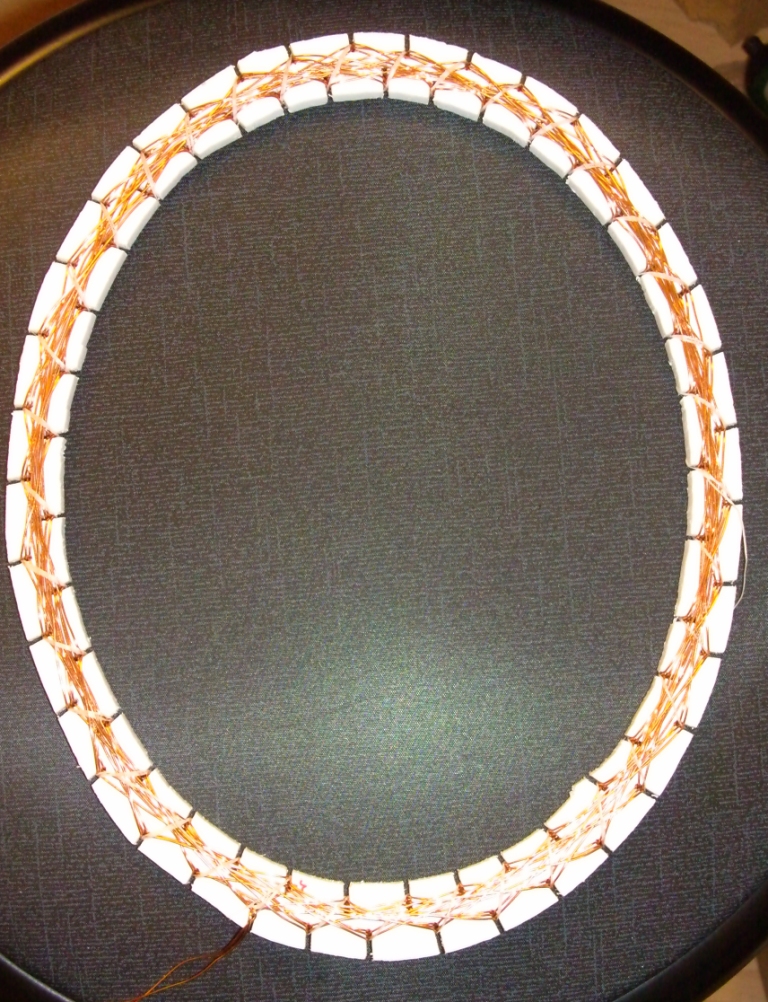

    • i made this crazy thing too, but in another shape, seems to work

            • Just wound a new oval 'Racetrack' spider coil 4" x 12.5" with 8.5" parallel sides using 24 AWG 600 volt PTFE/Teflon wire on a .093" thick LEXAN form. It measures 325uh with the coil and 35" feedline attached SRF is 1.070 mHz. On my CHANCE PI with 2 stage preamp it detects the following targets (in air) repeatably at the distances shown:

              Next step is to encase the coil in fiberglass and I will post these construction details/photos as it progresses.

              • What type of wind are you calling a 'Racetrack' spider coil ????
                • "Racetrack" refers only to the shape of two parallel sides with two half circle ends. It is the generally the same image as in post 134 of this thread but with .5" inner slot depth and made of LEXAN. The wind is the same self shielding 'spider coil' wind you and I have done in circular coils and by the way this coil does not see my hand fully grasping it.

                  • OK racetrack got it. tnks. Also the test with the Al can is a good indicator.
                    • With this racetrack design the objective is to build a fast 3:1 self shielding spider wound coil with a blade type of field to be used to quickly cover ground in search of small gold nuggets. The length of the 'blade' is about 8" and it appears to have good depth and sensitivity. Initially I intended to build an elliptical coil (see 'Elliptical Coil Question' thread)for the same purpose but then I found some threads Eric posted a while back about the performance of coils with 3:1 & 4:1 profiles. After doing some prototypes it appears that the 3:1 coil is best for my purposes. I am anxious to get this coil out in the mountains once the snow melts.
