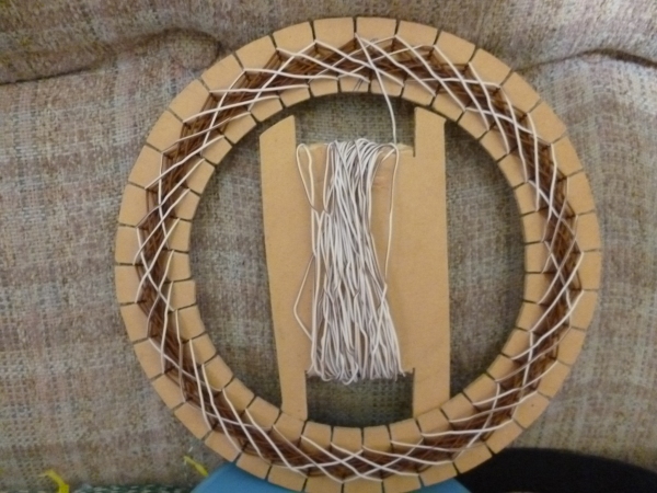

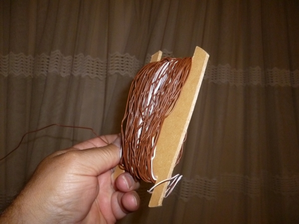

  • I wound the wire onto a spool made of scrap MDF to make it easy to move the wire in and out of the former.

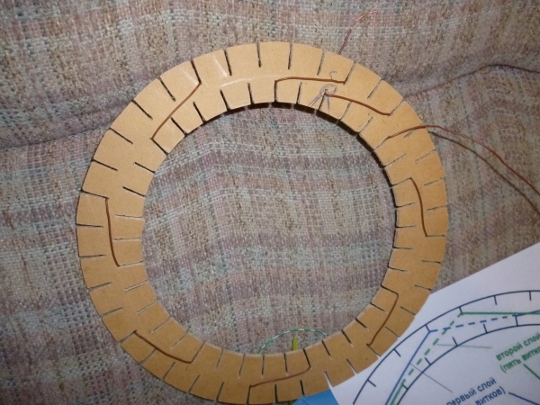

    • After one turn.

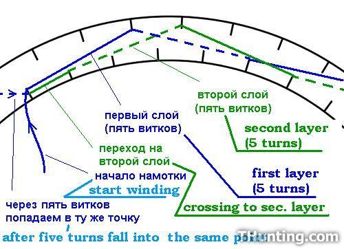

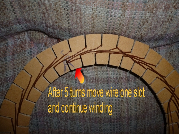

      • Now here is the trick to making this coil, after 5 turns the wire will fill the same slot from where you started, move the wire one slot and continue winding another 5 turns and then move the wire one slot and continue , you should not have any parallel wires, and the wire should stack up in the slots.

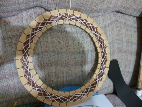

        • I finished the last few windings in white wire so you can see the pattern.
          • When completed 33 turns gave me 320uH.

                its called 'transfer on following/another layer'
