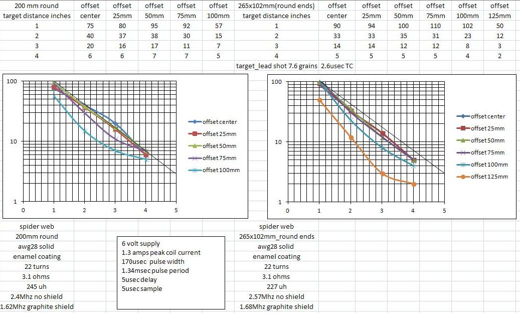

                    Here is a test I did awhile back. Not sure if what I'm doing compares with your testing. At one inch distance the rectangle was better. Farther out the round coil is better in the center, 25mm and 50mm offset. At 75mm and 100mm offset the rectangle coil was better. The rectangle has round ends, the circumference is about the same as the round coil.
                          If I understand and calculated correctly the circumscribed area of your round coil is about 314 sq cm.
                          The circumscribed area of your 265 X 102 mm coil is 243 sq. in. assuming a 50mm end radius.
                          The round coil has 24% more area than the rectangle coil within it's perimeter. I think this gives the rectangle coil greater flux density/sq. cm. than the round coil.
                          In Eric's post on rectangular coils he pointed out that 3:1 to 4:1 coil ratios were quite good and that is what I have been investigating with this latest 4 X 12.5" coil that has almost identical circumscribed area to my 8" (7.7") round coil.
                          All in all it sounds like your tests on round coils are similar.

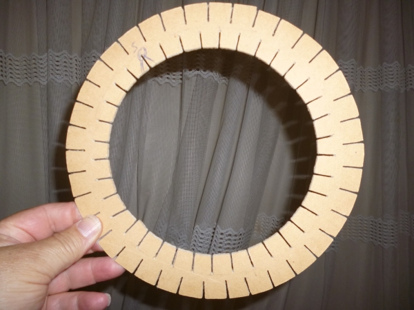

                              • I had a try at making the spider coil and it turned out ok
                                the former was made from MDF board, which is cheap compressed wood fibre board,
                                cut out with jigsaw.
                                8 inches.
