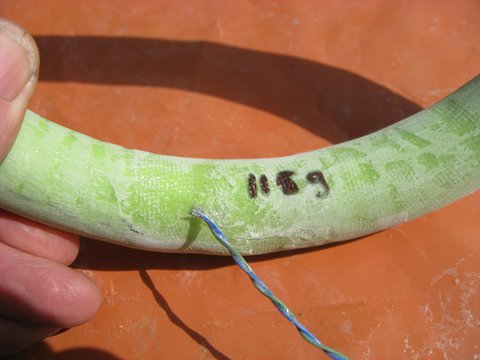

      • Originally posted by Goaty View Post
        Yes, you're are probably quite right! I guess I can always cut it off flush with the coil housing and seal it over with glass if it not effective. It would be interesting to see if the un-connected shield still has any effect.

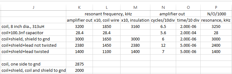

        Also, I would be interested to know if you measure the resonant frequency of your coils and, if so, how you do it. I found an earlier post in this section describing an oscillator to test coils and may have a go at building it when time permits.
        I always measure the Self Resonant Frequency (SRF)of my coils as it is very important to know. Actually what I measure is the SRF of my coil and its integral feed line made of a continuation of the coil wire twisted at about 3 turns per inch.
        There are two methods:
        1. Use a frequency generator and an O'scope to determine the point where the signal peaks as Homefire describes.
        OR
        2. Use another PI detector to excite your undamped coil and a scope to display the resonant ringing of the test coil. You can determine pretty well the SRF of the coil/feedline using the scope time base i.e. if one full cycle of the ringing frequency is 1us then the SRF is 1mHz (1/1us)
        Dan

            I use method (2). Usually connect scope probe to PI bench circuit amplifier out exciting the test coil. A test with the scope probe connected to some different locations on the test coil to show effect on measuring resonance. Test coil, 8 inch diameter, graphite shielded, 31 inches twisted pair lead, 285uH. Have tried laying probe next to test coil, connecting scope probe and ground lead to twisted pair lead wire insulation looks a lot better.

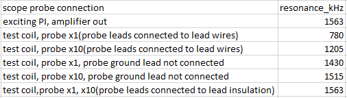

              • Thanks to everyone (all the gurus) for their suggestions for measuring PI coil SRF. I agree that it is an important parameter to quantify and document along with DC resistance, inductance and wire characteristics (stranded/solid/litz, insulation type and thickness and conductor cross section area so that other coil builders can compare their efforts.
                Where the difficulty arises, especially for new constructors like me, is with the variety of techniques and equipment used to measure it and the potential for error and variation in the results which can make comparisons meaningless.
                For example, the feedline type and length can make a large difference to the measured SRF and many constructors include it as it is relevant to what the control circuit 'sees'. Also, the feedline is often made as a continuation of the coil windings as a twisted pair to reduce capacitance and avoid joins at the coil so it would be difficult for them to quote a figure for just the coil alone.
                Another problem which gets in the way of uniform measurement is the complexity and expense of the equipment required compared to the other coil measurements and errors can creep in if allowance is not made for things like scope probe lead capacitance in the function generator/scope technique.
                And lastly let's not forget the effect of shielding.
                So, after all this rambling, I guess what I am getting at is the need for a list of these methods in one place on the forum and their strengths and weaknesses so they can be easily referred to when someone quotes SRF for their new coil.

                    ____-------------------------------------------------------------
                    Regarding the capacitance contributed by a given length of twisted pair...I have measured a length of 24awg stranded, 600 volt Teflon insulated twisted pair and it comes to about 1pf per inch of length. From this procedure you can approximate the capacitance added by your feed line if you have a capacitance meter. Just leave the other end of the twisted pair open during measurement.

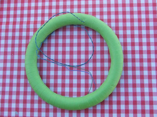

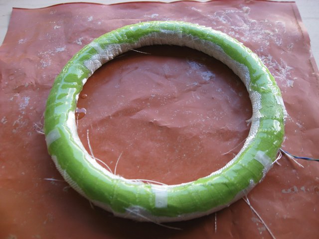

                        • Some more progress photos on my 3DSS coil build.
                          The foam layers were wrapped with a layer of paper (masking) tape

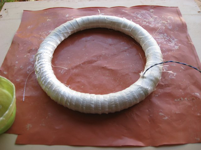

                          Then a layer of glass cloth. I used strips cut from some 4oz offcuts. I wasn't too fussy about the width, wanting to experiment a bit to see what was most effective. I used a 50% overlap so I effectively ended up with a double thickness all-over. A small piece of masking tape was used to hold the start of each length so it did not slip while winding.

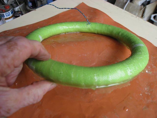

                          The resin used was "Kinetics" epoxy which is a 2:1 resin/hardener normally used for surfboards (I do ding repairs for the local surfers so have plenty on hand). A few points about glassing may help anyone who has not had much experience with it before -
                          (1) Measure quantities very accurately. I use a 30ml plastic syringe for the resin and a 10ml one for the hardener.
                          They can be used repeatedly as the epoxy will not attack the plastic and rubber - just don't mix them up!
                          (2) Check the resin/hardener ratio for your brand of resin. They vary considerably for different brands - check the label! Hardeners are usually available in different setting speeds, unlike polyester resins where setting speed can be varied by the amount of catalyst added. For laminating any speed hardener is OK - I use 'fast' as I am impatient but slow must be used for potting coils to allow the heat to dissipate.
                          (3) Mix the two components very thoroughly by stirring for several minutes. Don't beat the mixture or it will have lots of air bubbles in it.

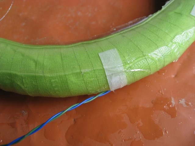

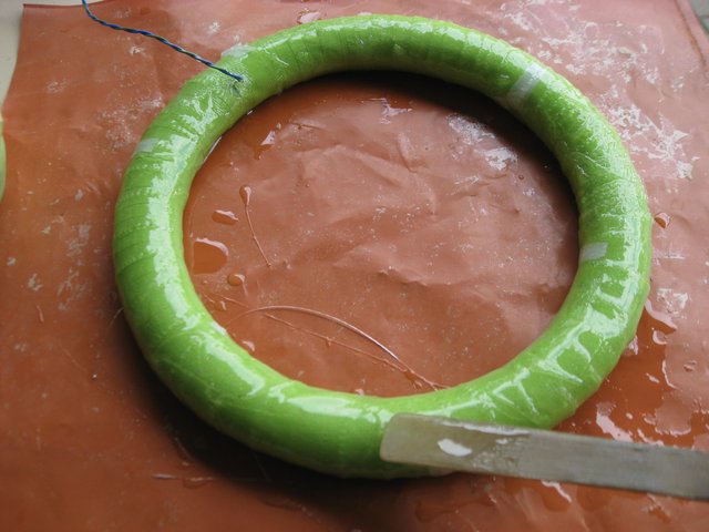

                          To apply the resin I placed the coil on a flat board covered with a piece of building dampcourse membrane (poly-ethylene) and spread it on with a strip of old pc board. Don't bother with a brush - it's too hard to clean.
                          Just drizzle it on, one side at a time starting with the bottom, and allow it to soak through the cloth with a bit of light squeegeeing with the pc board strip. Work with the lap direction so you can smooth down the edges instead of lifting them. I used 30ml of mixed epoxy to do this size coil.

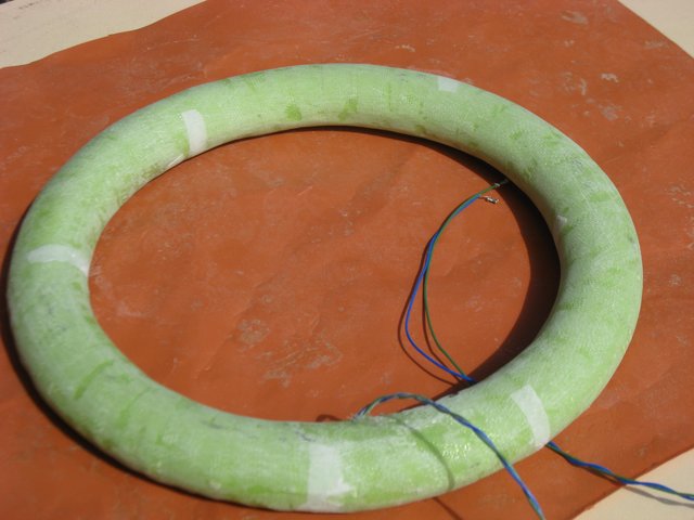

                          When the glass is completely 'wet out' leave it to set bottom side down.
                          When set it will easily peel off the plastic sheet leaving a nice flat bottom.
                          Leave it a day or two to thoroughly harden before sanding off the rough edges. Trying to sand it 'green' will just clog the abrasive paper.
                          I use a 4" fibre sanding disk in an angle grinder for 'roughing down' then finish by hand sanding although the angle grinder can be a bit fierce if you are not used to using it.
                          The coil at this stage weighs 115g and already seems quite strong, light and, hopefully, waterproof.
                          When time permits I plan to measure its characteristics and try it out on the minipulse I have almost finished. I would also like to experiment with a graphite paint shielding layer but may scrap this if it does not prove to be of any benefit.
                          I will publish results here as I progress but hopefully the above information may be of use to others experimenting with coil building using epoxy composites.
