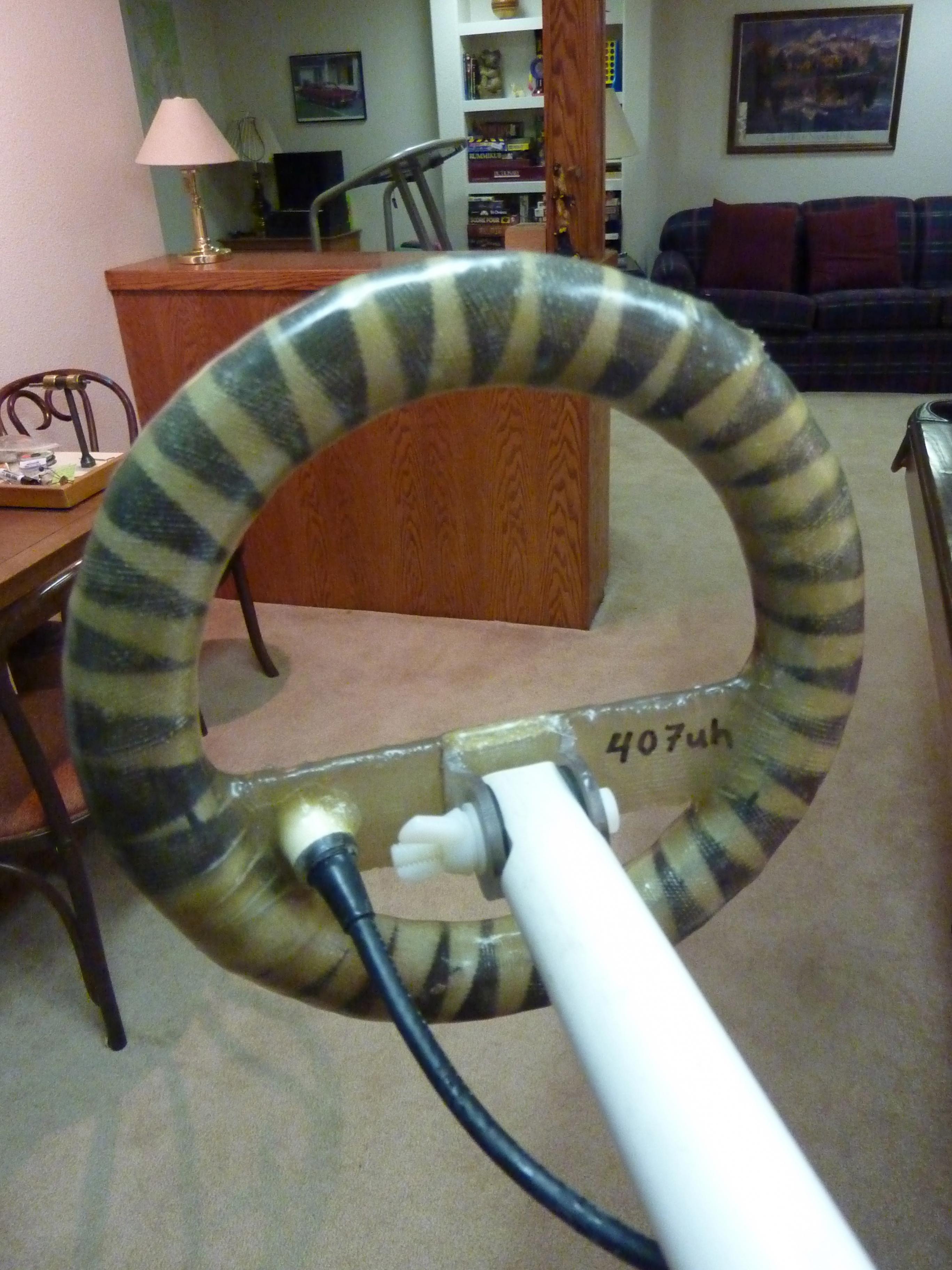

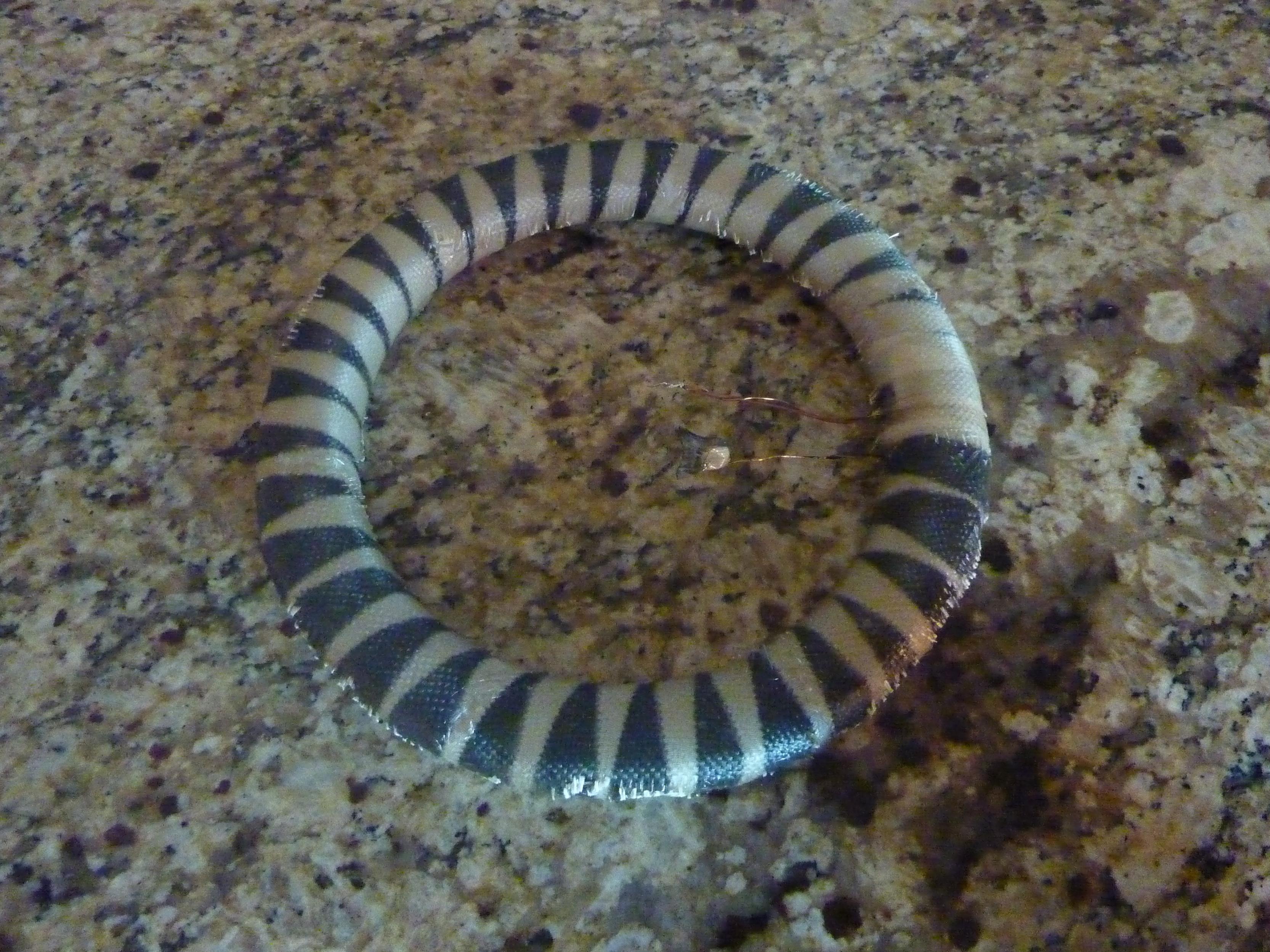

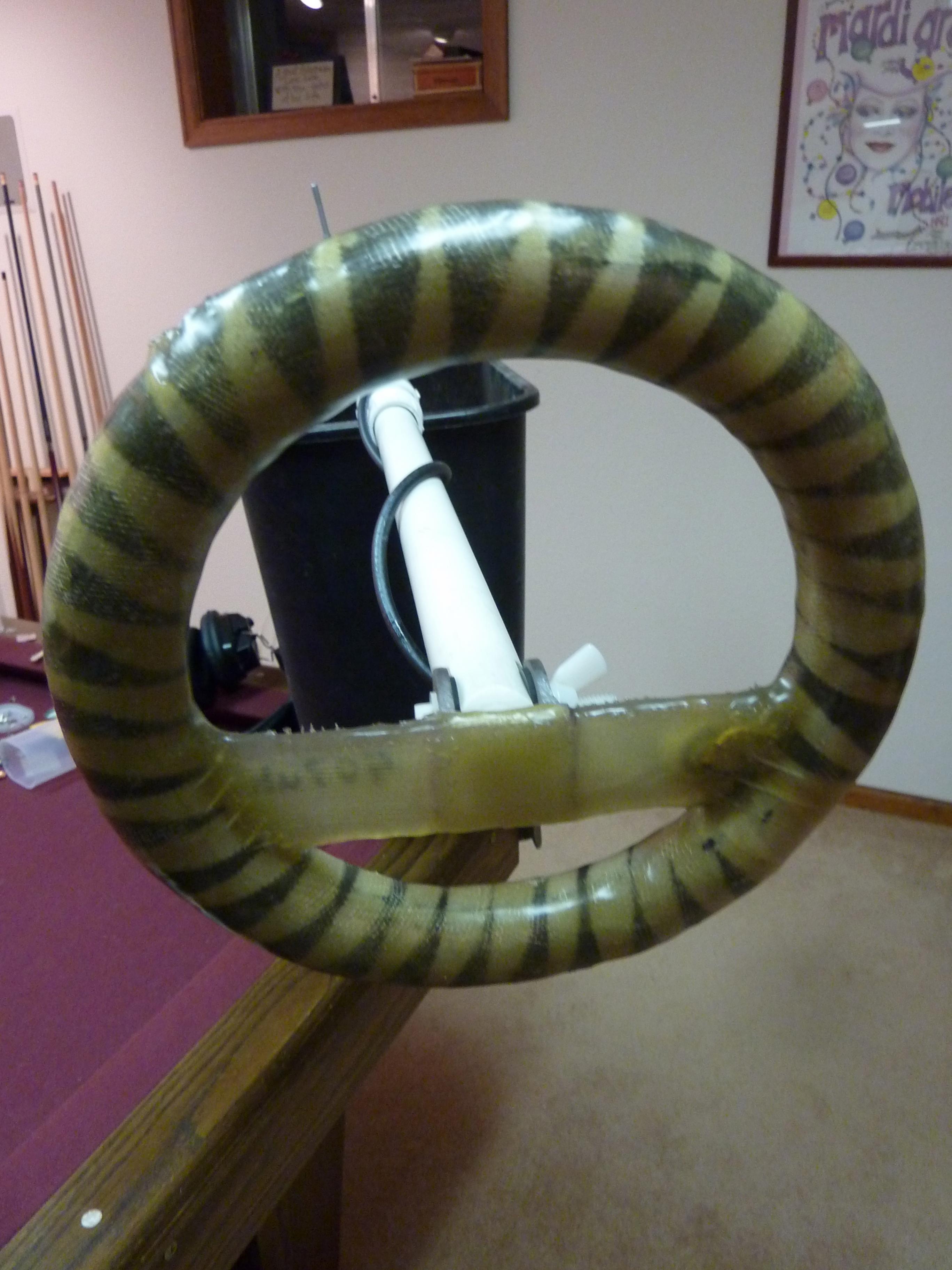

      More pictures, this time of an experimental Teflon insulated 23 AWG solid wire wound spider coil form, and a different graphite shielded coil wound with 26AWG solid enameled wire. The teflon insulated 23AWG solid wire came from a plenum rated Cat6 cable. The graphite shielding was a mixture of varnish and powdered graphite and was applied at a rate of 1300 to 1500 ohms/inch. All coils are 8" diameter. The shielded coil was fiberglassed with two layers of woven fiberglass mat and a lexan cross support and mounting ears were 'glassed in' just like the coil in the prior posting.
      Theses polycarbonate coil forms were machined on a milling machine using a rotary index table and a 1/8" cutter. Using a cutter with a larger diameter than the thickness of the material causes less bending stress on the wire/insulation because the wire is bent less than 45 degrees as it is passed through the radial slots and also minimizes parallelism of alternate wires within a slot resulting in less capacitance. This process is preferable to just slotting the form material with a hacksaw. That said,hacksaw slots can be hand filed to depth using a 1/8" fine round file to achieve similar results.
      [ATTACH]27961[/ATTACH][ATTACH]27962[/ATTACH][ATTACH]27963[/ATTACH]
      I did find another image of the 1st layer of the fiberglass applied over the shielded coil described above. It is below. The 'serpentine skin' appearance of the coil is due to the hospital tape overlap of the shield layer and the inability of the resin to penetrate one layer but not both layers of the overlapped tape. After curing of this layer of fiberglass a Dremel tool was used to remove whiskers and to smooth the resin on the surface. A second fiberglass layer was then applied with subsequent smoothing and a thin finish layer of resin only was applied. Also attached are two more views of this finished coil.
      Dan

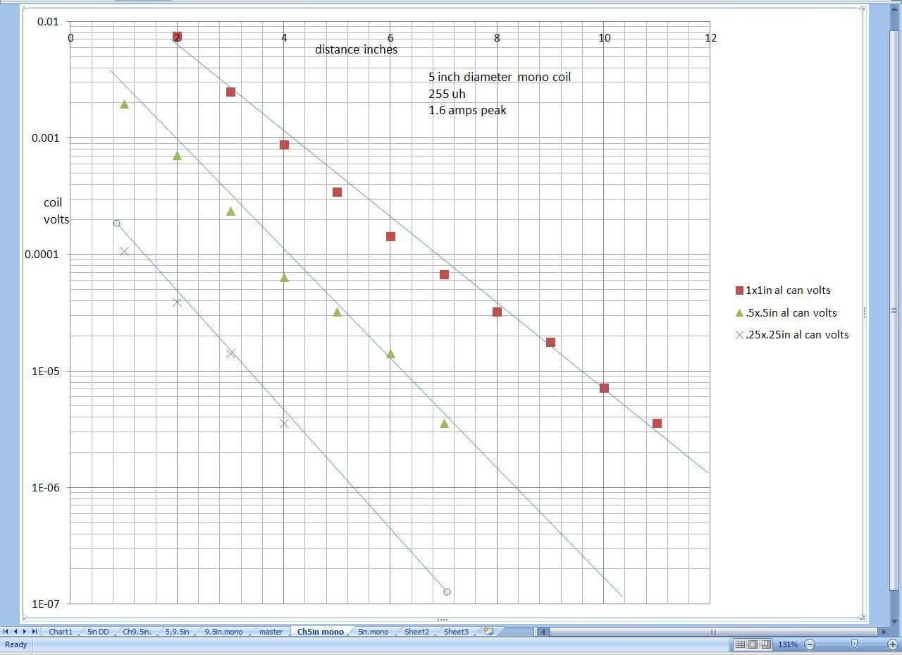

              Other targets were tested in air in the basement as follows:
              TARGET DISTANCE
              1 sq in x .001" thick aluminum foil 9.5"
              1/2 sq in Aluminum foil 8"
              1/4 sq in Alum foil 7"
              1 cm sq Alum foil 4"
              US Nickel 12"
              US copper Penny 9"
              US silver dime 7"
              10.5 grain dental gold 6"
              8.4 grain dental gold 4"

                First of all I have not tried to detect a 1/4" X 1/4" target of either foil or aluminum can. 1/4" X1/4" is 1/16 of a square inch. I have detected a 1/4 square inch target of aluminum can and it is a great target for testing, measuring 1/2" X 1/2". Perhaps the language I used caused some confusion. Sorry if it did. If you are detecting targets 1/4" X 1/4" of aluminum can that is impressive. My most difficult standardized target so far is the 1/2" X 1/2' .001" thick aluminum foil target.

                      The mono coil tests are done with an inverting amplifier with R in being R damping. Fixed coil on time usually between 50 to 100 usec. The IB coil tests use a 2 amp instrument amplifier connected to the Rx coil. For time constant tests I record a no target signal, a target signal and plot the difference. Distance plots are the change in volts out of the integrator/(amplifier*integrator gain). Sample average (5 to 10 usec)after fet gate off. The setup is for testing and learning on the bench. Been playing with circuits for GEB and discrimination. One of these days I need to try and build a PI detector. Have you tried to measure the CHANCE sample times yet?
