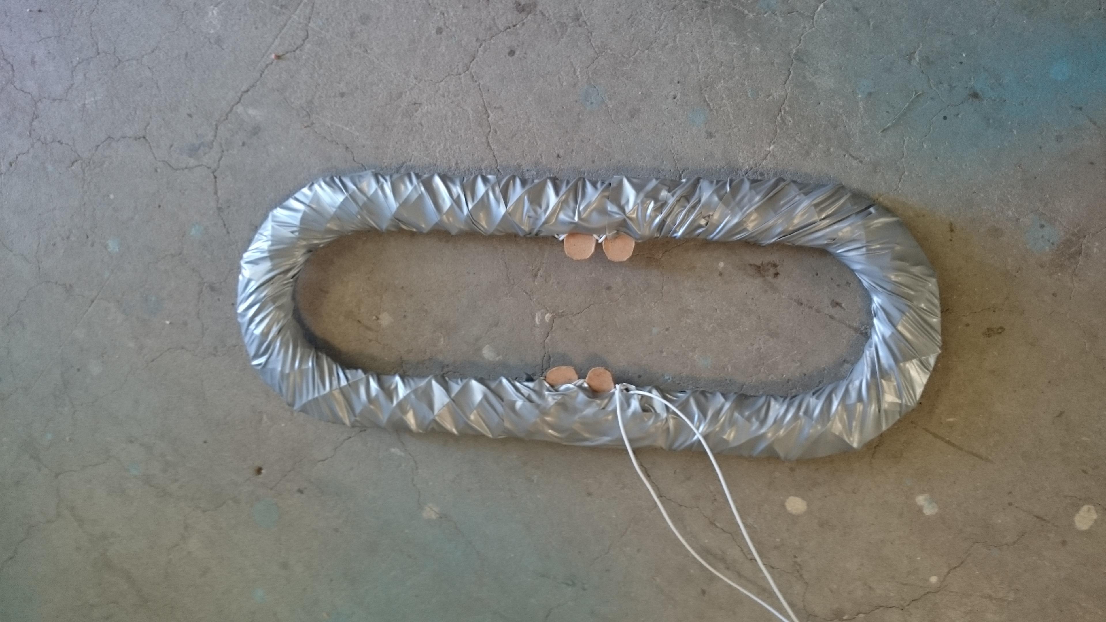

            Just build a 11" coil today, probably going to build a smaller one soon. How does the 4*12.5 behave compared to a 8"? Is it nearly the same depth in general, but has th he advantage of a blade shaped magnetic field? Click image for larger version

            • PERFORMANCE OF 3DSS RACETRACK COIL VS 3DSS 8" ROUND COIL
              Originally posted by EasyX View Post
              Thanks for your answers!
              Just build a 11" coil today, probably going to build a smaller one soon. How does the 4*12.5 behave compared to a 8"? Is it nearly the same depth in general, but has th he advantage of a blade shaped magnetic field? [ATTACH]36002[/ATTACH]
              Hi Isaak,
              You have built a beautiful coil!
              As my test results posted in this thread indicate (post #179 & most recently #271), the Racetrack does give up a small bit of depth (about 1" on the small gold target I seek.) owing to its 4" coil width. That is offset to some degree in having a fairly constant sensitivity about 8" long, down the coil center, allowing the coil to cover ground much more quickly. Also this coil fits into tighter spaces. The detection blade field of the Racetrack coil is quite 'sharp' so a rapid search sweep speed is not desirable when using it.
              Round coils have greatest depth and sensitivity at a pinpoint about 1 radius out from the coil center. On an 8" coil that pinpoint would be at about 4" out. By the way, in my tests I use the standard of three consecutive detected passes for the 'first detection' and the 'tone lockup tests' on my modified Chance PI. My detector/coil does see targets at greater distances but it can be inconsistent so I don't use those test results . However when in the field if I get sporadic 'hits' over the same spot 5 out of 12 passes I'd probably dig the target up.
              Dan

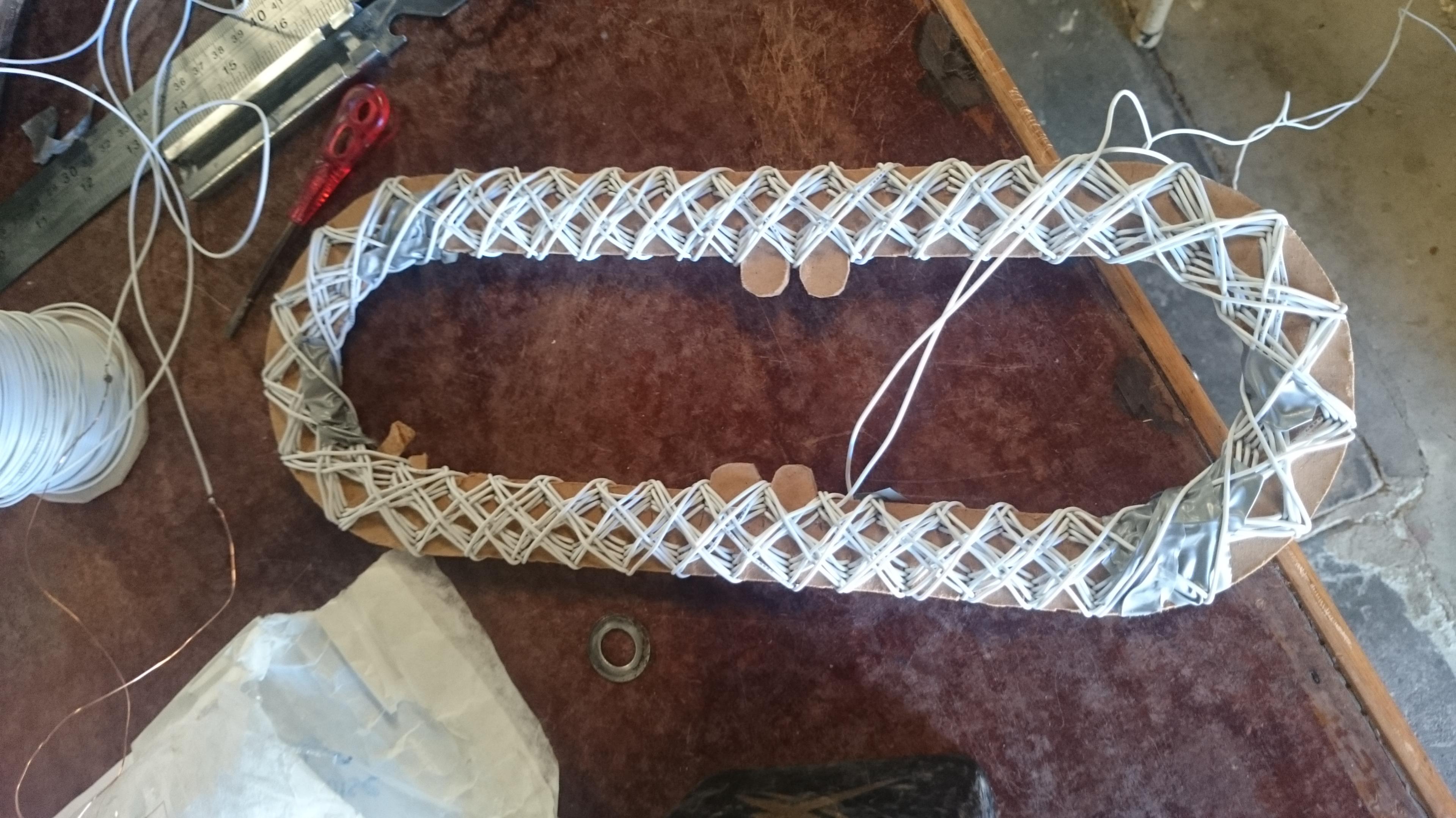

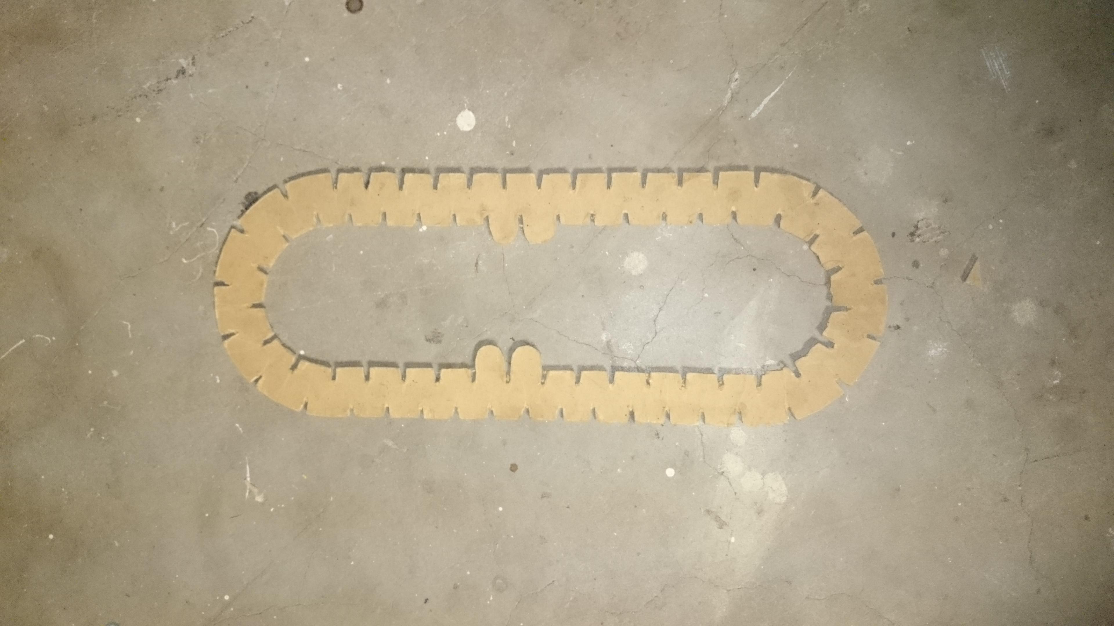

                Just build a 4"*12.5" coil. I used a little different wiring technique, just 2 instead of 3 steps forward each time. This results in making the extra single step forward every 3 instead of 5 turns. I didn't consider that I need much longer cuts, so I had to stabilize everything with some tape. At the end I made 30 turns. Optical it looks good, nearly all crossings are rectangular, but I will see if it's good in real.

                • Hi Issak,
                  Have you tested your coil yet? It will be interesting to see how it performs compared to the original pattern especially on a 1/4" square piece of a soda can cut from the middle of the side wall.
                  I look forward to your test results.
                  Dan

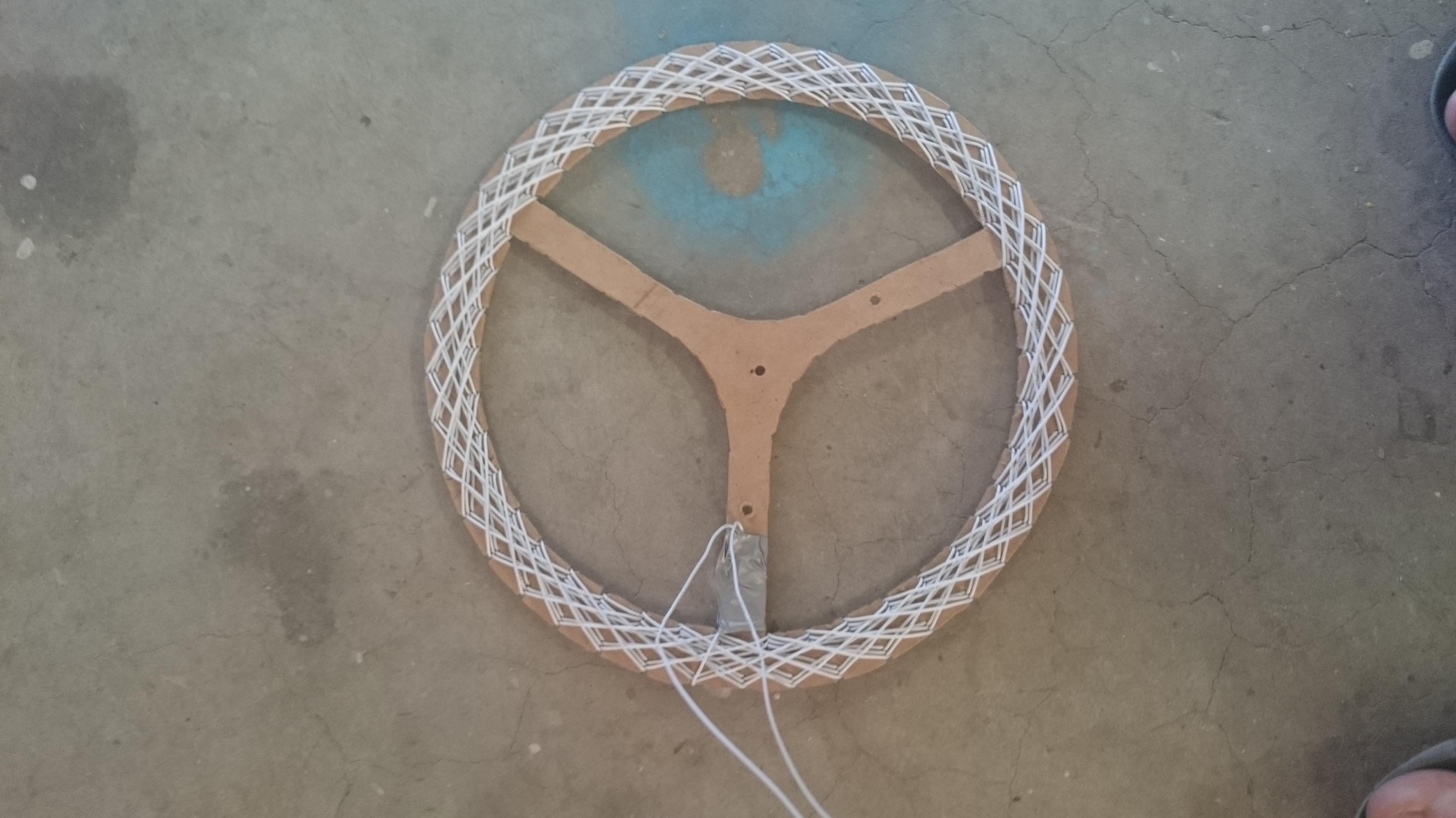

                      • I will probably be building a Mirage PI over the winter and this coil to go with it (or maybe i should build the chance PI? has anyone tested both and can recomend one?). The "original" Mirage search coil is rated 300uH so i want to match that when building this one but im not sure how to achieve that while not having an oscilloscope. how do i know what AWG the wire should have and how many turns to get 300uH (or at least close to it)? I plan to make the 8" "spider" coil.
                        • I have built and done modifications to the CHANCE PI for the past 4+ years and have spent about the same amount of time on the
                          3DSS coil detailed in this Chance PI COIL thread . Many test results for the CHANCE PI detector are detailed in the Chance PI Build thread and in this Chance PI Coil thread as well.
                          An 8" spider coil, a spiral coil, or a basket weave coil is not the same as a 3DSS coil because it does not self shield. I would use 24awg or 26 awg 600volt teflon insulated stranded wire with the feed line being a continuation of the coil wire but twisted at about 3 turns per inch. This twisting is easily accomplished by chucking the ends of the coil wires in a drill chuck and giving them a spin with gentle tension at each end of the wires. There are details for the number of turns on an 8" 3DSS coil in these threads.
