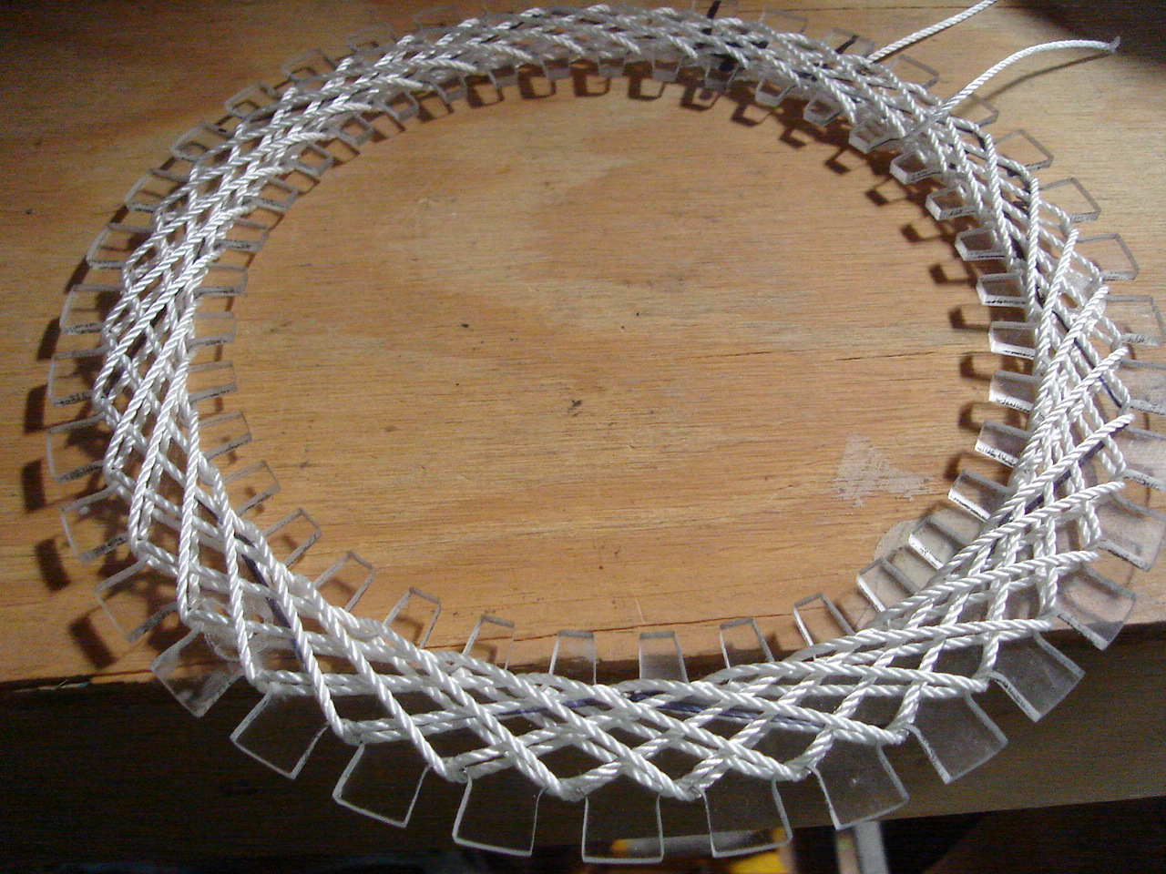

  • Hey thanks for the suggstion Dan and 6666,
    I used 6666's suggestion and used some string and just did 10 complete turns. It worked....
    All I was missing was that pic of the over/under switch over from one side to the other. Now I got it and the pattern so it will be pretty straight forward to do..
    This particular form was given to me by Don, one of the members here, not sure if he just gave up on it or had the same issue I had, missing the crossover. I made one 9.5 inch OD by hand with a hand held router for a template for later. I have access to a water jet so will be making some of my own in different sizes. This one has slots that are over double the thickness, 0.263, I assume because the idea was to use teflon coated wire. Other than that, it is to the spec seen on one of the other images here, 0.098 lexan, 0.4" deep, 37 inner and outer slots, although this one is 7-3/4 od, so it would fit into an 8" coil form I'm guessin.
    I'll take your advice and when I do mine on the water jet I'll make the slots just over the thickness of the material, maybe 0.100 or 0.120 and then go from there..
    Anxious for my teflon wire to get here so I can get these done and test them out..

      Excellent result with the string! Now your are cooking!
      Dan

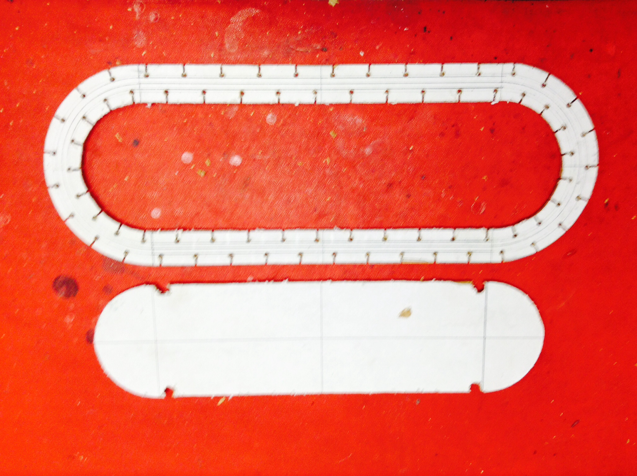

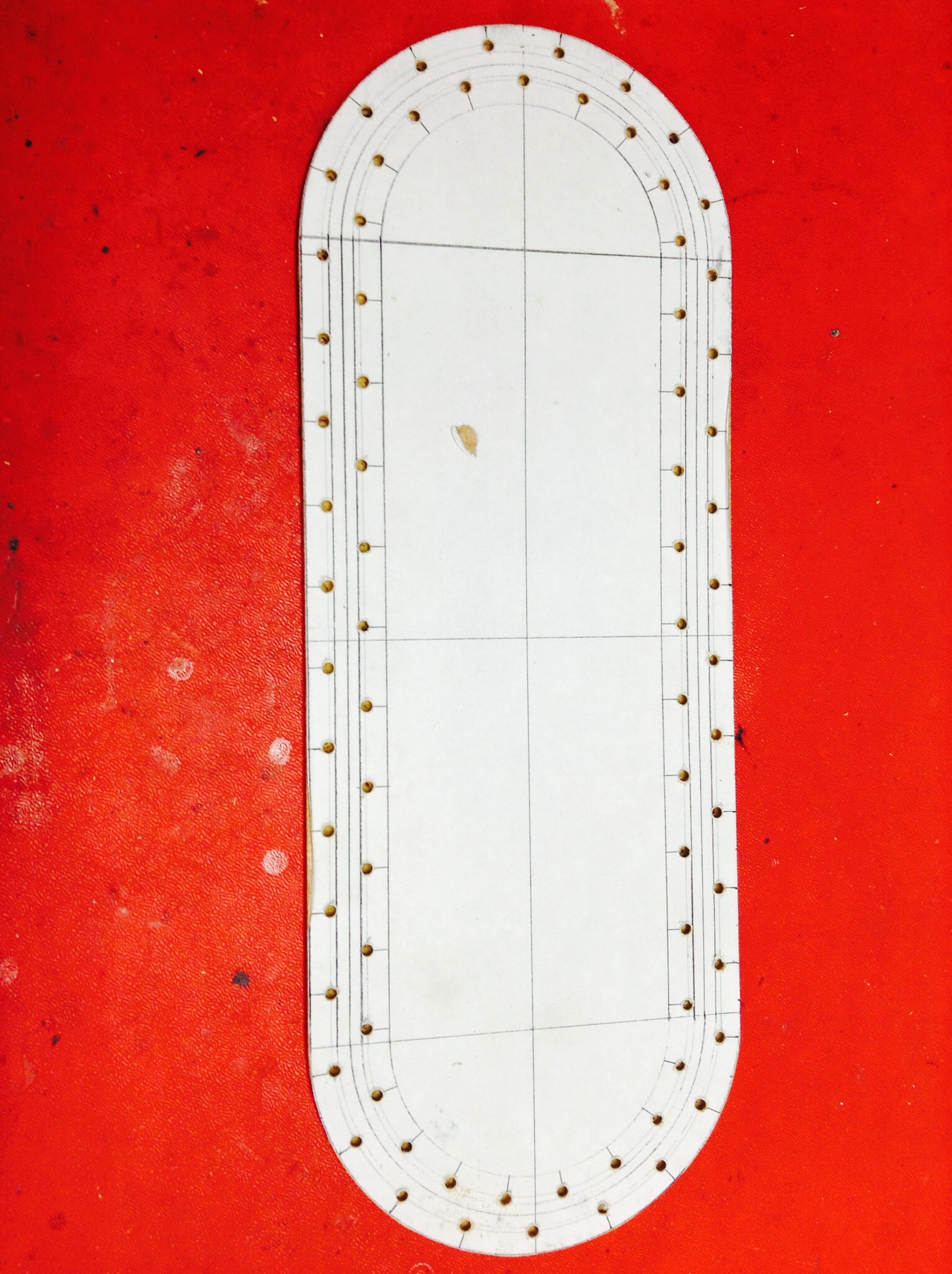

            • An alternative way to make the coil form using minimal/hand tools is to:
              1. Lay out the form profile and slots on paper and glue it to the .091 to .125" thick LEXAN or polycarbonate material. Note: Other plastics that are brittle may break in the fabrication process but could still be used if care is taken in sawing and filing.
              Form pattern is 1" wide with 37 slots equally spaced around the inner and outer perimeters with the inner slots staggered to the midpoints of the outer slots. Slots are .400" long and 1/8" wide. The .400" slot length is meant to accommodate at least 35 turns of #24awg 600volt PTFE insulated stranded wire. Smaller wire or less turns would allow a slot of .375" or even less but .400 is a good slot depth for most wire in the range of 24AWG to 28 AWG.
              2. Drill 1/8" holes at the innermost end of the slots so that the innermost edge of the drilled holes meet the desired slot depth/length.
              3. Saw (jigsaw or sabresaw)out the outer and inner circles using the glued on layout as a guide. Note: Use a fine tooth blade, one meant for thin metal is good
              4. Hack saw or jigsaw the slots from the outer and inner form edges to hit the center of the drilled holes using the glued on layout as a guide
              5. Then file the slots using a 1/8" file. With care the file will follow the sawed slot right down to the drilled hole at the termination of the slot.
              6. Smooth out the slot edges with a file.
              7. Remove the glued on paper layout and VOILA!! You have your coil form.
              I hope this helps those who want to build this coil with minimal tools. It is not too difficult to accomplish.
              Dan

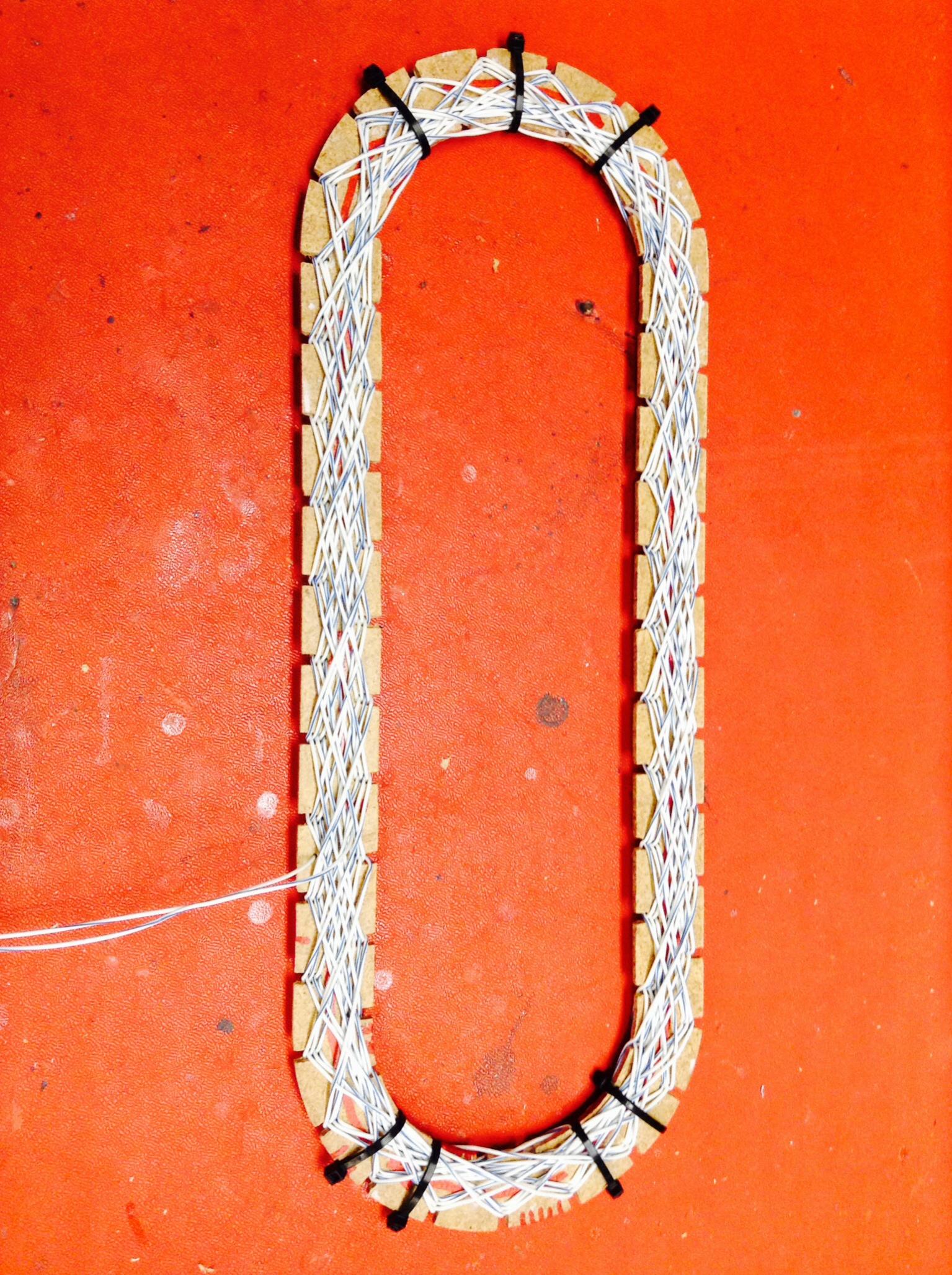

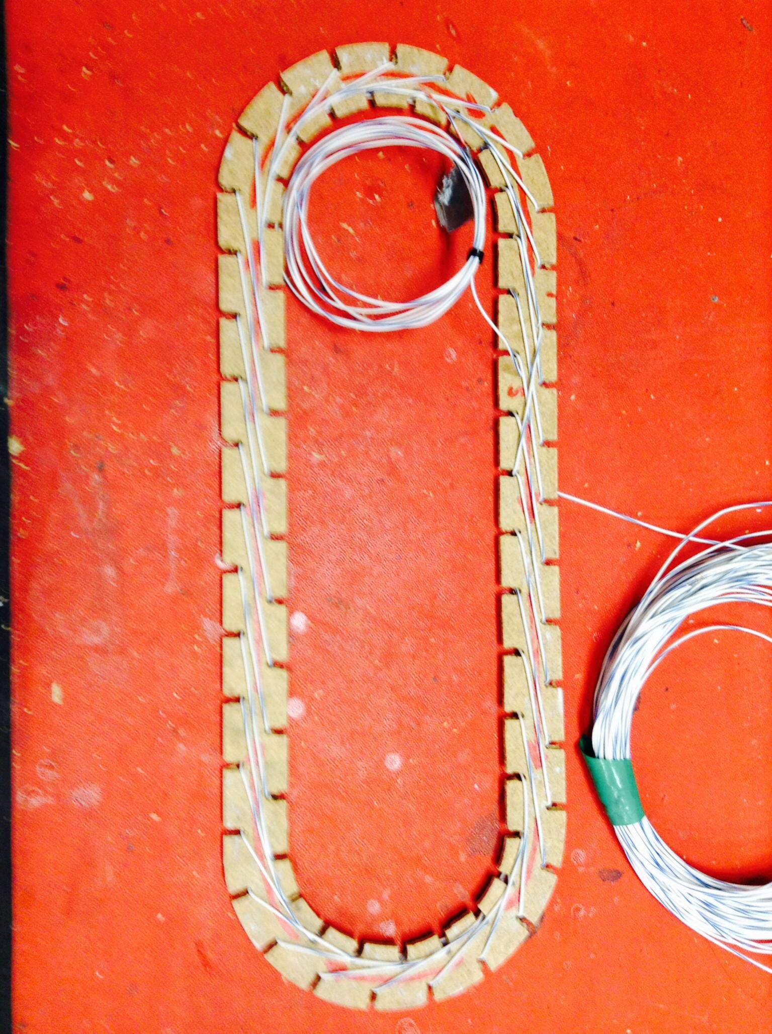

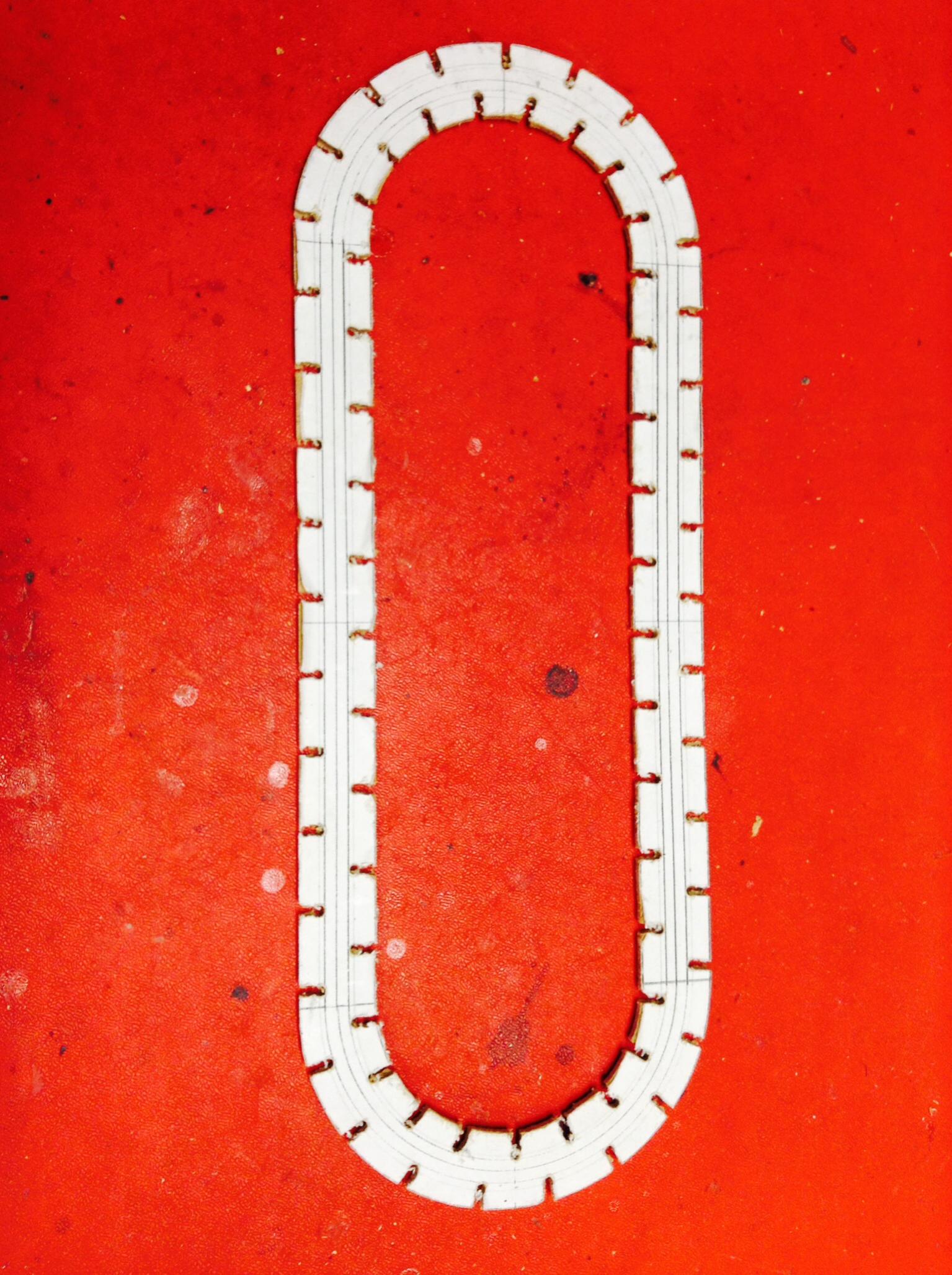

                            • I have built a 4" X 12.5" oval coil with 8.5" parallel sides in accordance with Eric's 3:1 profile recommendation. This coil is a fast spider coil using the instructions I posted in post #126 using only simple tools. The construction pictures are posted below. I will post test results for this self shielding coil in the next few days.Click image for larger version
