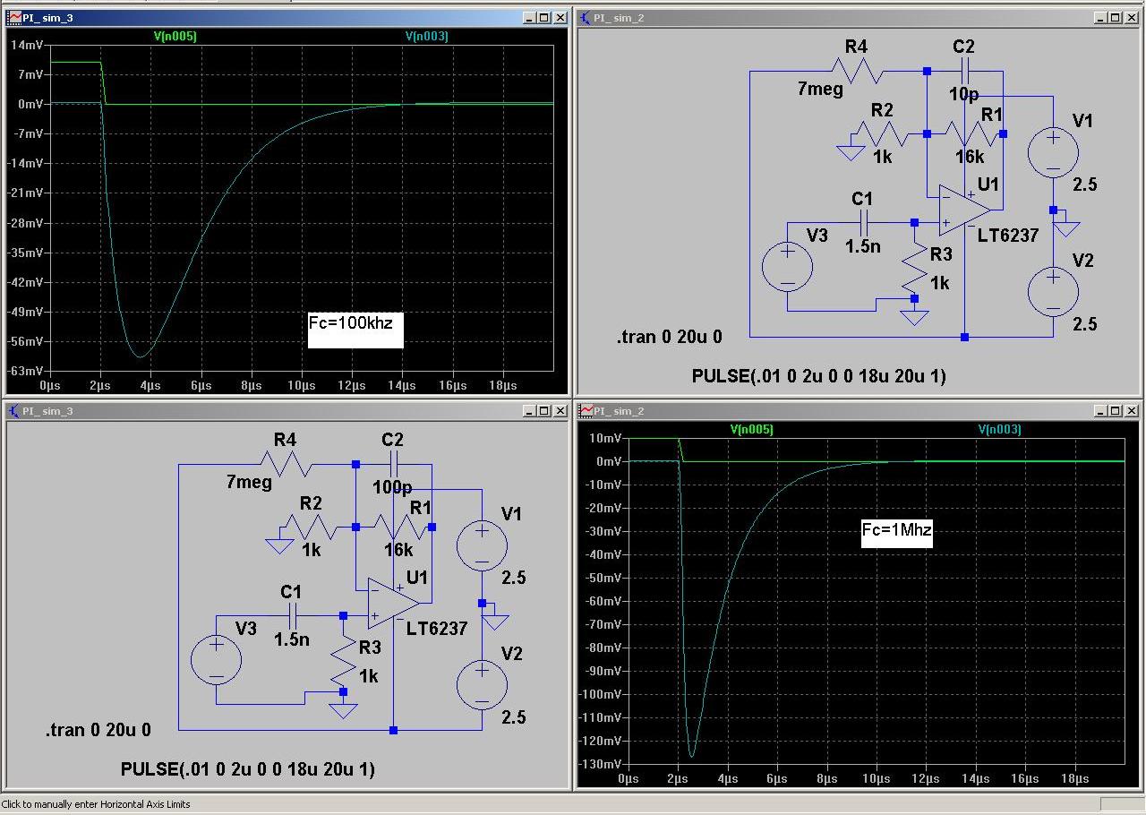

                    I was trying to simulate a target with a 1.5usec time constant. Including a plot. Might be a start. I was wondering what effect amplifier Fc has. Your coils have a SRF about 1Mhz. I calculate a Fc of about 150 khz for the Chance amplifier. I'm wondering why a critical damped coil around 1Mhz has anything to do with the response. The simulation plot doesn't include saturation from fly back. Haven't figured how to include it. Looks like a lower amplifier Fc gives a higher voltage at longer delays if saturation doesn't cause a problem. To get speed my amplifiers have a Fc>> 1Mhz. Probably a mistake. The simulation is a 10 mv step which should cause a 160 mv peak at amplifier out with a high amplifier Fc.
                        Even with a SFR of 1MHz, there are still the eddy currents within the coil wire to be accounted for.
                        There is also another way to look at it. We can get resonance at a certain SFR in a coil with high inductance and low capacitance or the same SFR with high capacitance and low inductance. However, with a traditional PI, we know that the stray capacitance plays an important role in the damping. If we look at the first few ns of the switch OFF transient, we can clearly see what the capacitance does.
                        I have a slow coil and a TX and preamp circuit on the breadboard at the moment, where I can observe the target response at time 0. According to what I see, for these short TC targets, we need at least 200 kHz, 1MHz is excellent but maybe a bit overkill. Once I have a fast coil I will probably know more.

                          If the preamp has a Fc of 150kHz, this acts as an integrator for the very short TC signal response. Then the 12.5 us wide sample further integrates the signal. Less integration would make a higher peak response signal but it would be noisier.
