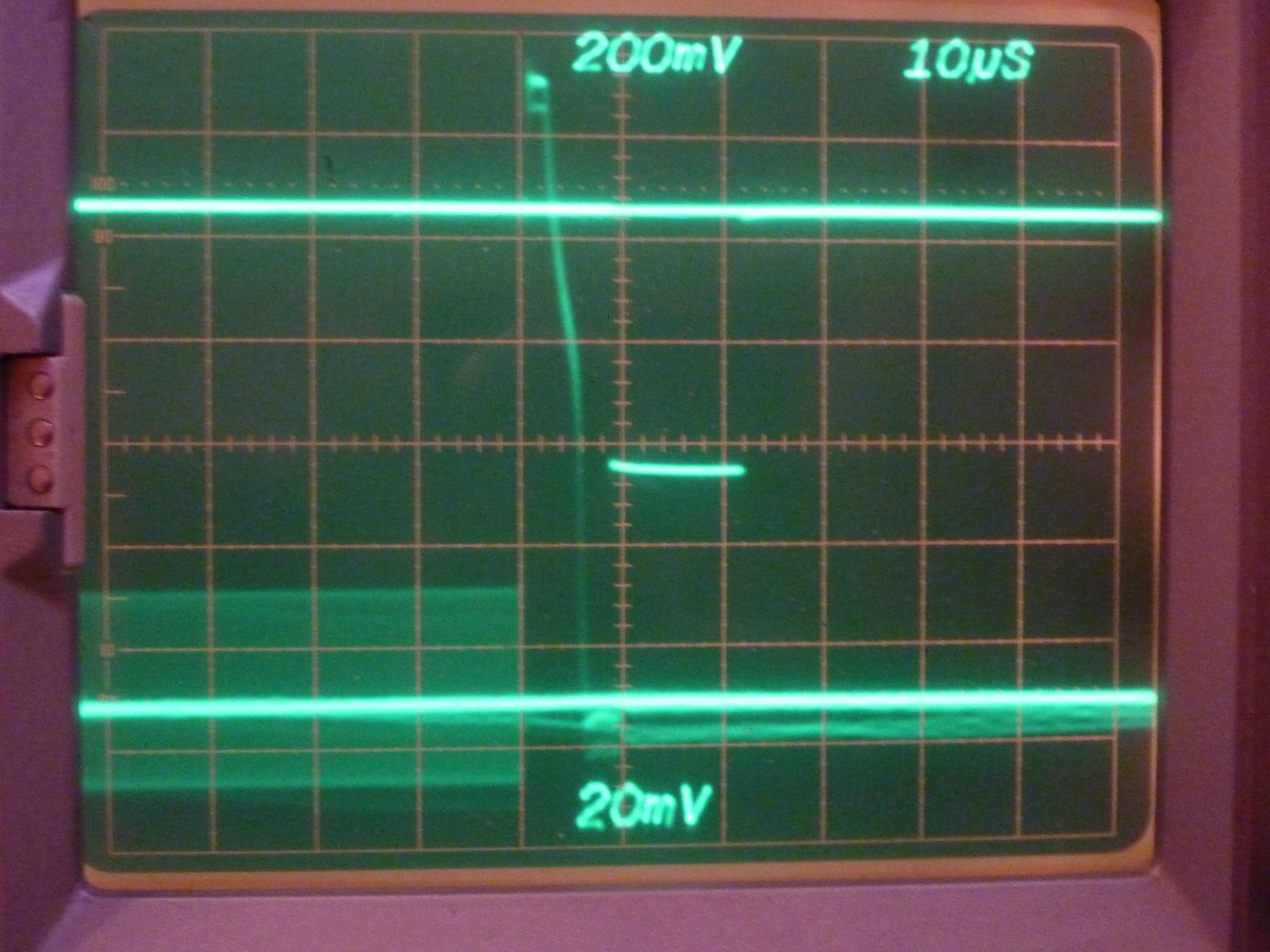

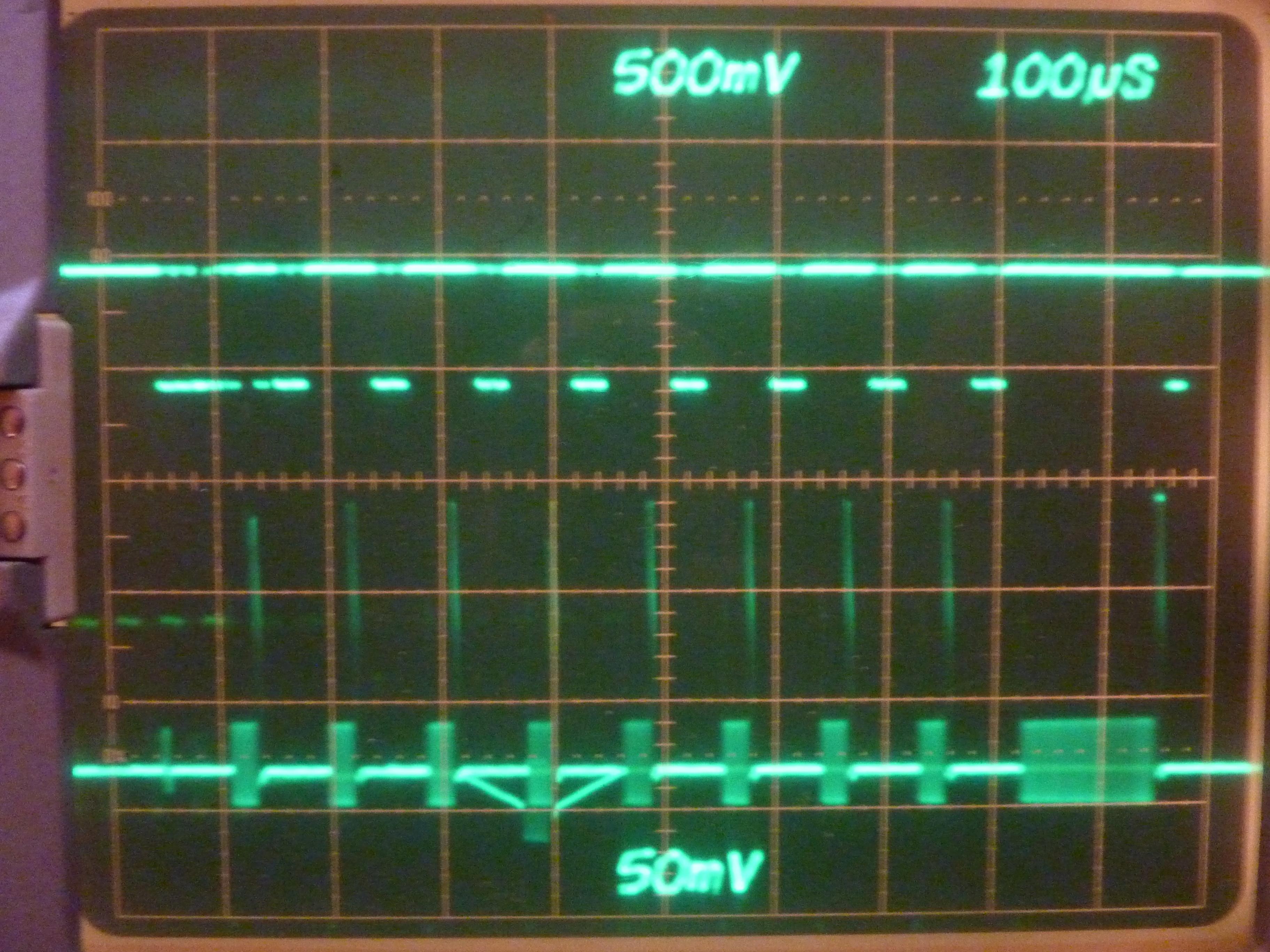

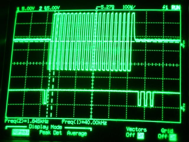

    Well, i'm bit confused now. Here is the part of old Chance timing, V8 software, recorded long time ago, traces are preamp output and ADC sample command, original coil. Pic.1 is after long pulse, sampling is after some 28uS (not 18 as I thought, this is probably coil speed, I remembered wrong value). On new software adjustable down to some 12uS or somewhat less, but better re-check, my memory is not reliable. Pic.2 is sampling after burst cycle, Pic.3 is complete burst, EF sample taken before it, also before long pulse.

      From the START of flyback it is 8us later when the A-D opens up for 12.5us with a GI setting of 10.

            Just ran with external trigger from mosfet gate and CHannel 2 on opamp output, Channel 1 still on the A-D pin 5. From end of long pulse ( start of flyback) it is 8us later that A-D window opens.

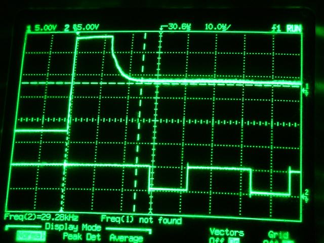

                        More scope time on this last night. Recounted the short pulses and there are 16 short ones followed by a 120us long pulse. At the end of the long pulse flyback begins, and the coil volts cross zero 6us later. The software is Version 1.2.1 on this detector.
                        Performed critical damping with the scope while listening to the detector audio and the Guard Interval set at '10' (fastest setting). When damping was optimum the audio changed from a raspy buzz to melodious tones as the detector began to operate. A quick push on the ZERO button quieted the noise. You can add a little tweak to the damping resistance if you want under damp it or alternatively do this in air. I should note that I started the damping adjustment from a resistance below the value for critical damping and this is manifested by the raspy buzz of the audio.

                          1. This picture is of the coil flyback measured at the diodes on the amp input. The horizontal line at midpoint is the A-D sample window
                          2. This picture is of the last of 8 short pulses and the 120us long pulse and coil flyback,again taken at the diodes. The Guard Interval moves the single A-D sample shown at the far right 0.9us for each increment of GI input. All others are unaffected by GI settings.
                          3. This picture is of the 16 short pulses with their corresponding A-D dual samples in the 2nd horizontal row from the top.

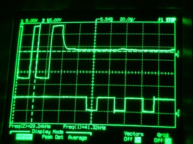

                          4. This picture was taken at the amp output and at pin 5 of the A-D. It shows the A-D sample at its position with a Guard Interval of 10. This shot is of the improperly damped coil and the second flyback image at the right of the trace is there because damping is not correct. The detector audio is a raspy buzz in this state . Note the increased flyback time at the amp output compared to the measurement at the input to the amp.
                          5. This picture is taken at the amp out and A-D pin 5. It shows a properly damped coil and the A-D sample. Note that the image to the right from the previous shot is now gone. The detector audio is now in a quiet state.
