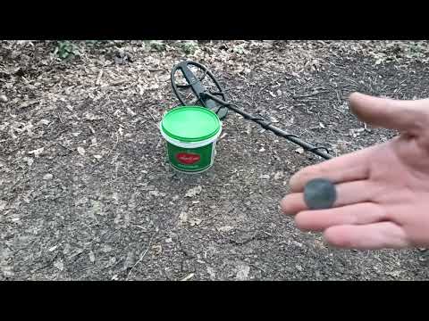

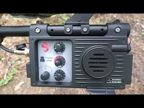

                      After a long time I was waiting for feedback about the detector called the smart hybrid. Apart from the praises of the manufacturers and sales dealers, there is not a single clip searching in real conditions anywhere. And that bragging has its limits since it has the characteristics of ib and ib we know what problems it suffers from, on the other hand, the other tone for iron can cause huge problems where there are a lot of iron waste, especially if the iron is detected at great depths, such a device plays like a philharmonic, and I watched several videos where only the dealer realizes what is underneath and the manufacturer mixes the tones even when there is not much nearby a lot of waste, and I guess what happens in places where there was a lot of human activity. Can someone confirm with a video that this device can work successfully in real time and conditions and not on ready-made testing grounds as well as on wide plains where pollution from waste is minimal!?? Finally I read the boasting of the manufacturer himself as if he reinvented hot water, hot water exists but it's just rewritten maybe with Geotech 1 and added a little lemon to change the taste!
                      • #56
                        Here there is a real searching in the ground. After the guy does some tests on the first 1/3 of the video, he starts searching for targets in the ground: https://www.youtube.com/watch?v=cruspOcGWsM
                        The last coin he found is interesting. There are automatic subtitles. ​
                        • #57
                          I read a comment under the video...
                          Answer the question yourself, is it real or a fairy tale..?​
                          @bestforexbonus7583
                          Yo, man, thanks for the killer video! I tried out your settings, and dude, it’s legit – just pull back the threshold like a hair below max, and boom, this thing runs quiet as a mouse. No fake signals at all! Because of that sweet silence, I picked up this super faint beep that turned out to be a freakin’ Roman denarius buried over 55 cm deep. Mind = blown, bro! If I’d stuck to my old settings with that annoying audible threshold, I’d have totally ditched that signal. But man, Smart Pulse is an absolute beast when it comes to depth. Can’t wait to see more of your vids. Keep ‘em coming, buddy!
                          • #58
                            I saw several ads that it was for sale after a few months of sale. I personally don't trust the sales managers on that video is the guy who sells the device. And there are those who are in charge of promoting each device, there are them here among others.
